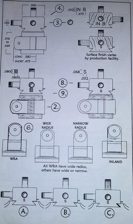

    Frank, no rush, maybe a photo of the side profile and bottom
    Thannks, Robert
    Here are the Sides
    Frank

    I added a new link to May 1942 FM23-7 to it and am adding it here:
    FM 23-7 U.S. Carbine, Caliber .30, M1 1942 : United States. War Department : Free Download, Borrow, and Streaming : Internet Archive
    It will show the center pin is supposed to line up with the back edge of the short leaf when upright.
    I've compared the illustration in the FM to real Flip Sights I have loose and installed. Very hard to tell, because spring tension varies.
    Appears the back edge of the bases pin hole lines up.
    But doesn't appear like the center of the pin hole will.
    Hope this makes sense.
    I still ask:
    Were all Flip Leafs made with the 5 sided/edged bottom?
    Or were some made like the example #2 with 4 pivot sides ?
    Anyone know of a schematic / drawing of Leaf ?
    I'm really tempted to take a couple different makers apart to see.
    5 Side ? 4 Side ? Or both ?

    I see that this has Wide and Narrow Radius. I'm sure you probably looked through this one already.
    Frank

    I haven't seen that Flip sight chart. Is it from Larsons book ?
    If so thats why I haven't seen it. I refuse to send any $$ the way of L&S
    Here's the picture of the RMC Parts and a old link back to them:

    Charlie, the sight flip chart is out of Harrison's book.

    No Charlie its not from him, The other day I was looking through All my books for something I needed to know and I just remembered when looking through Harrison's "The M1icon Carbine 3" I had remembered seeing 2 pages of different sizes of Flip Sights and explanations. The References like 1-10 and A-D are on the next page, but I didn't take a picture of it and put it with the one I did because I didn't know if this was going to help you or not.
