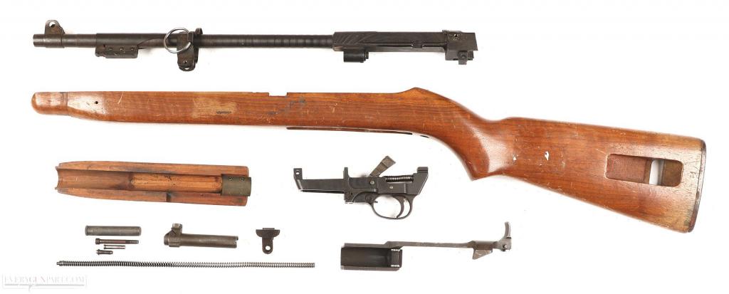

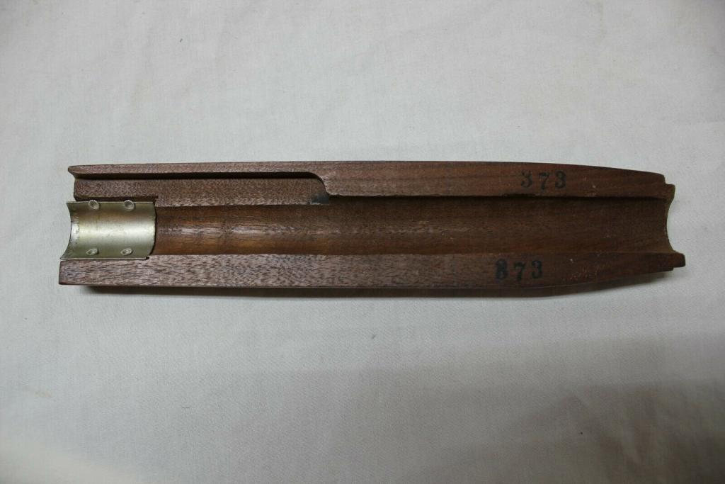

    I came across this De-milled Alpine parts kit.
    Notice the inside of the Hand Guard has some relief cut,
    I'm still wondering why your HG interferes with the Op Slide.
    Does it look like a relief cut inside the HG like in this link would cure your fit issue ?
    Alpine M1 Carbine Semi-auto
    Charlie-Painter777
