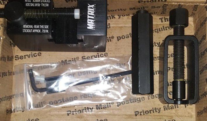

    Is this possible...When you use that Black Box like Tool to remove a Rear Sight and the Sight is Not budging even when you oiled it overnight can the Receiver start to bend inwards from the bottom when your applying more strength ? I have a friend who insists on Breaking down his Carbine and trying to fix something when he doesn't know much about it, but can Shoot and hold his own against us old Grunts (at Short distances) brought it over and ask me to pull back the Slide and Cycle it and that's when he told me he was changing out his Rear Sight and felt something different. Well right when the Bolt was starting to move towards the dovetail it felt Tight nothing like I've felt before. That's what I was looking through my Books just to see if there was something about that happening. Now that I exhausted what and where I would look to find Answers I didn't, so now I'm asking if anyone thinks it can happen and what can you do about it. One thing I know for Sure now is that I will not loan him any of my Carbines anymore when he goes Shooting with his friends.

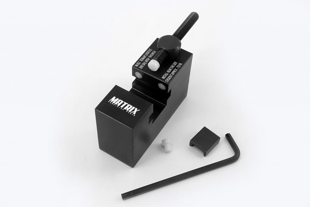

    one like this ?

    That's exactly like the one he bought over.

    Frank,
    I find it hard to believe he was able to torque on that allen wrench hard enough to bend the receiver, IF he did it all by hand.
    Both USGI Bob and I have one like pictured.
    Do you think he might have stuck the receiver in a vice ?
    Look for any damage/crush on the Op Slide spring housing.
    Just to double check, see if the Op slide arm is still straight.
    Most importantly: I'd also measure the receiver width across the top and bottom at the rear, middle and front.
    I'd also like to add, Check to be SURE that both bolt lugs and tracks are lubed.
    A fellow member shared this on another forum:
    "I must mention an experience I had recently. After a thorough cleaning and before oiling, the slide and bolt refused to move rearward to test function,
    but after oiling the lugs, it cycled smooth as silk."
    Please keep us posted,
    I'll check back in tomorrow morning
    Charlie-Painter777

    Oh Yeah Charlie I had Plenty of questions and doubts also, but I've Shot that Carbine Several Times when I overhauled it or he would say something was wrong and we meet at the P&,R Club and I would Shoot it then to feel how tight it felt when pulling the Slide back it was Tight. I grabbed 3 of my Carbines and we both cycle them and it was like night and day. He didn't want to leave it but I told him that we had to take measurements, so that's the next Step. I've had a bottom lug Crack on me a long time ago and I never knew why. That's why I'm wanting find out what happened. I had to accept what he said he did. I even told him that if it was that tight I was surprised that he didn't chip off a chunk of metal on the Dovetail.

    I also have that set of Tools to Remove and Install the Rear Sight and the tool for the Front Sight as well and I have Never had to use so much strength to remove a Rear Sight
