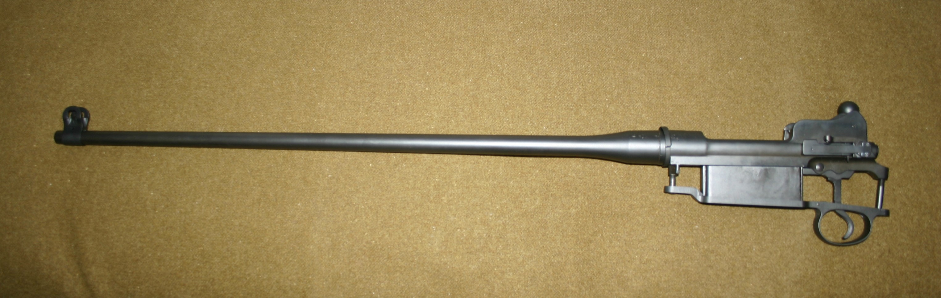

    I wouldn't hold my breath too long if i was you
    Still a ton of wood work to do and for now that's on hold.
    Add covid into the mix and a trip to the range with this one is still far away.
    I must confess that this does not botter me much as i am more into the collecting aspect than into shooting.
    Don't get me wrong, i love a good range session but to me it comes second to the historical aspect.
    The fabricator test fired it after installing the new barrel and said she runs great.
    So that's great to know.

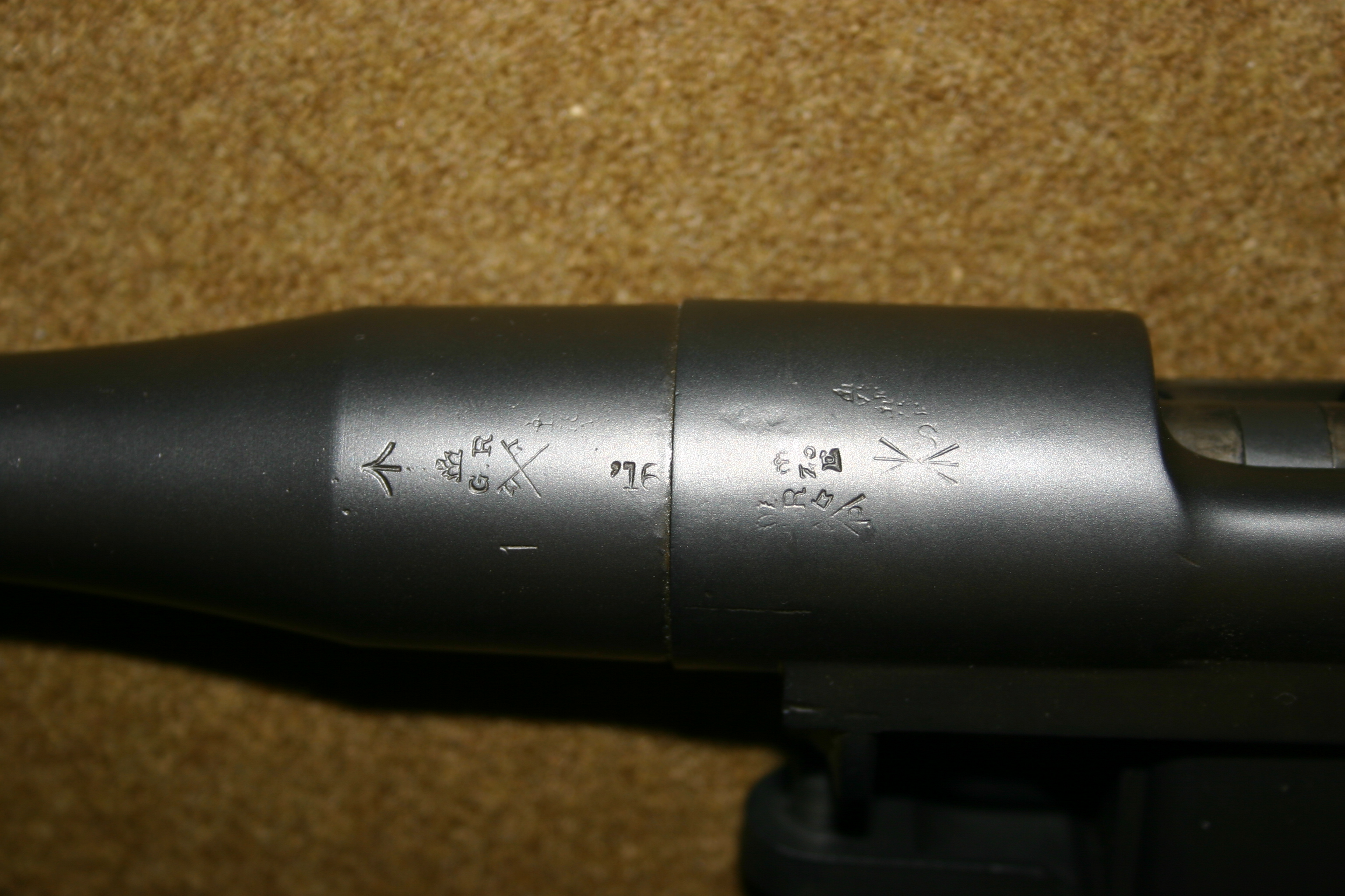

    She's in 303 so I expect to get similar results as any good Pattern 1914
    I had him erase the old P14 serial number on the barrel but i asked that any other proof marks, etc. to be left there.
    Original P13 barrels were not blued except for the last front part but since it will be covered by the stock, i had him do the whole length.

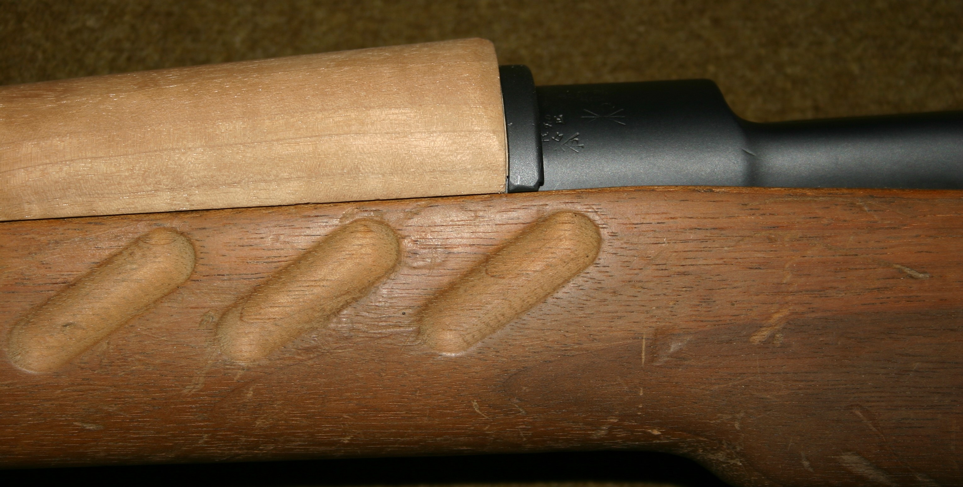

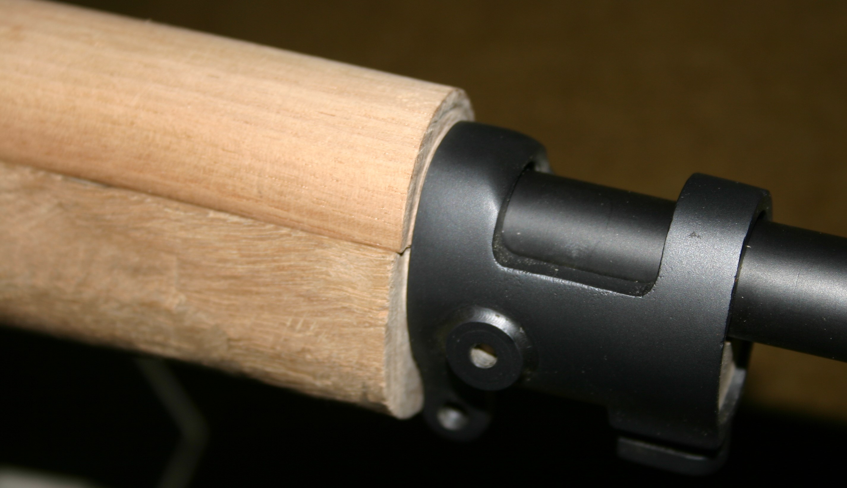

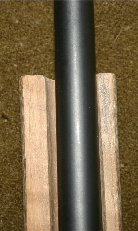

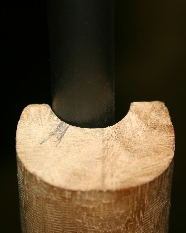

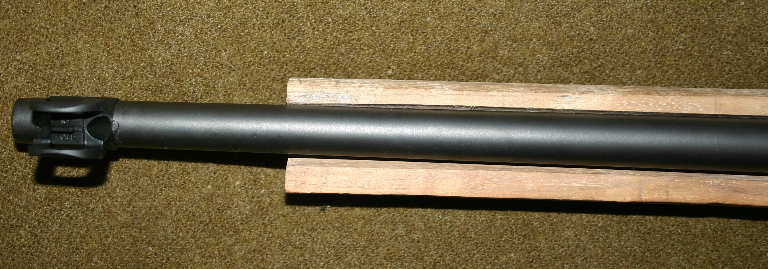

    Well i couldn't help myself and went ahead and played in walnut dust a bit... will see how it goes.
    Had a feeling when i first made the splice that i might have went too fast since the barrel was going to be change.... i hate being right.
    I never said it was going to be easy... so anyway, after checking things i saw the barrel was rubbing on the right side of the channel so i went ahead and started to remove some wood.
    Obviously the more i removed wood the more the barrel started to straighten ... and the more concerned i got.
    I'm now at the point where i wont probably have enough wood on the left side for final shaping....
    So the solution will be to remove the splice..again... without causing any damages and to re cut the matting surface at a very small angle to try to pull the splice to the left a bit.
    A bit of a step back but i think it should work.
    Oh and i did fit the rear handguard. It needed to be relieve on the inside, it was rubbing on the top of the new barrel. It's now sitting down perfectly.
    Final outside shaping will have to wait until the forend is fixed.

    It should be a straight forward fix. I've changed the splice already when i first started this stock so 3rd times a charm, they say ?
    Yes i will be keeping the 303 barrel on. This is the replacement, i kept the one that was on there.
    It was a quick and cheap fix to the barrel issue.
    I'm not closing the door at ever having one made but it wont be for the close future... but you never know.

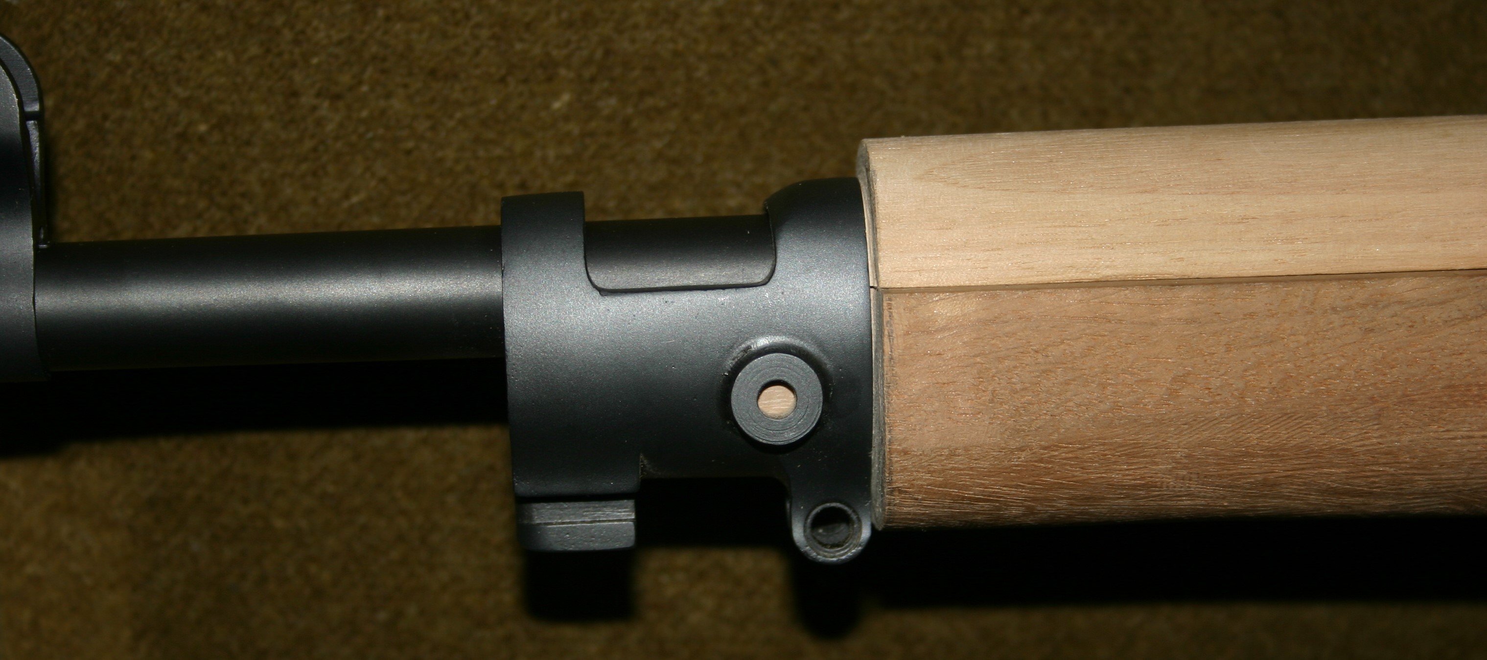

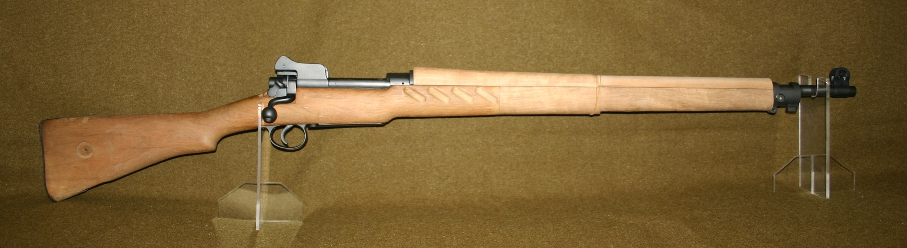

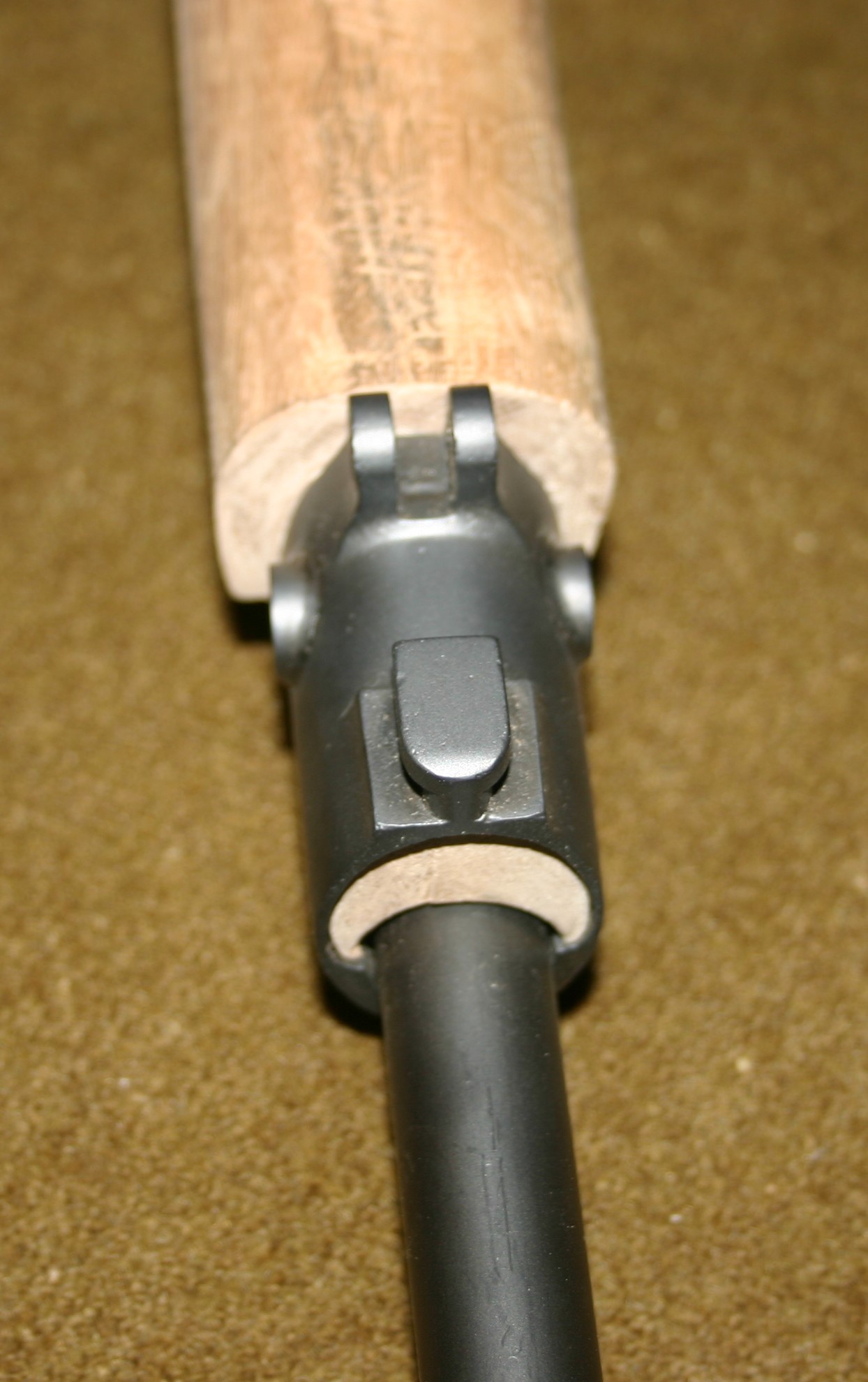

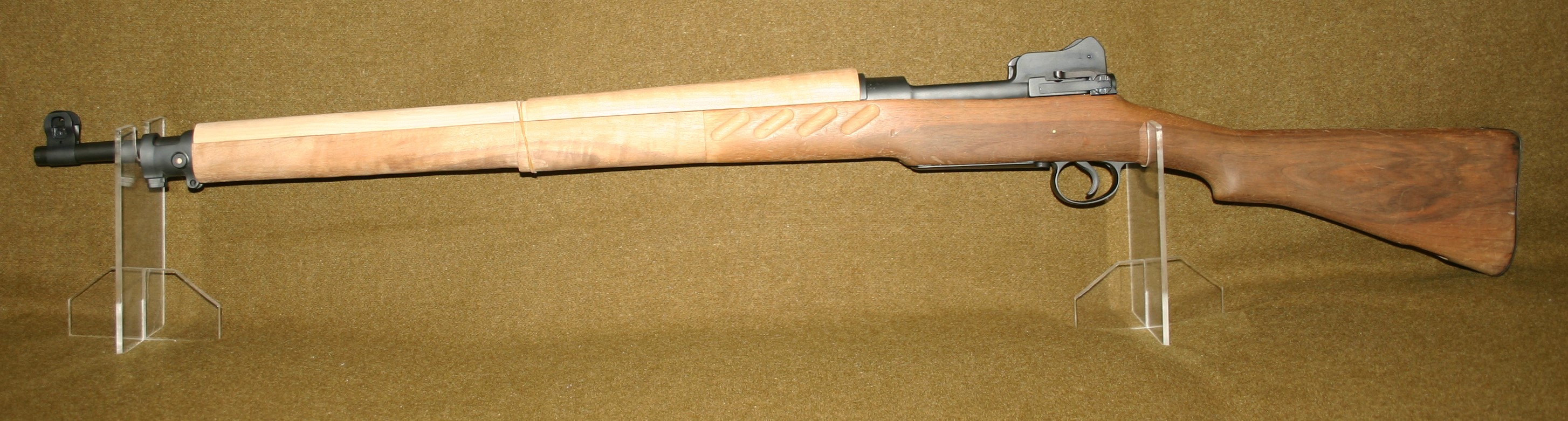

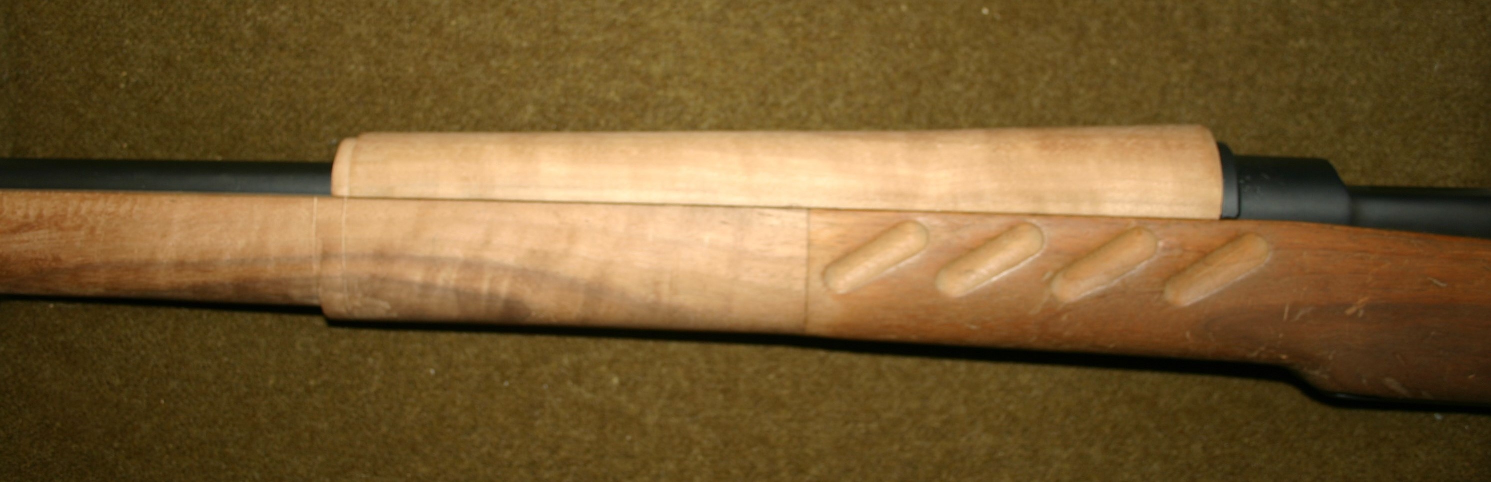

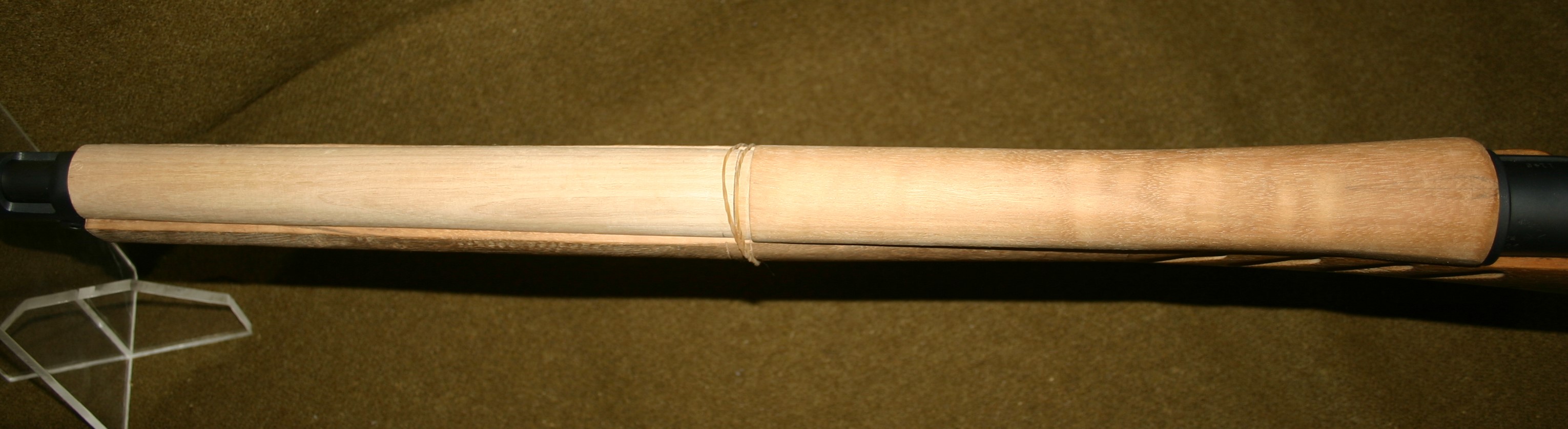

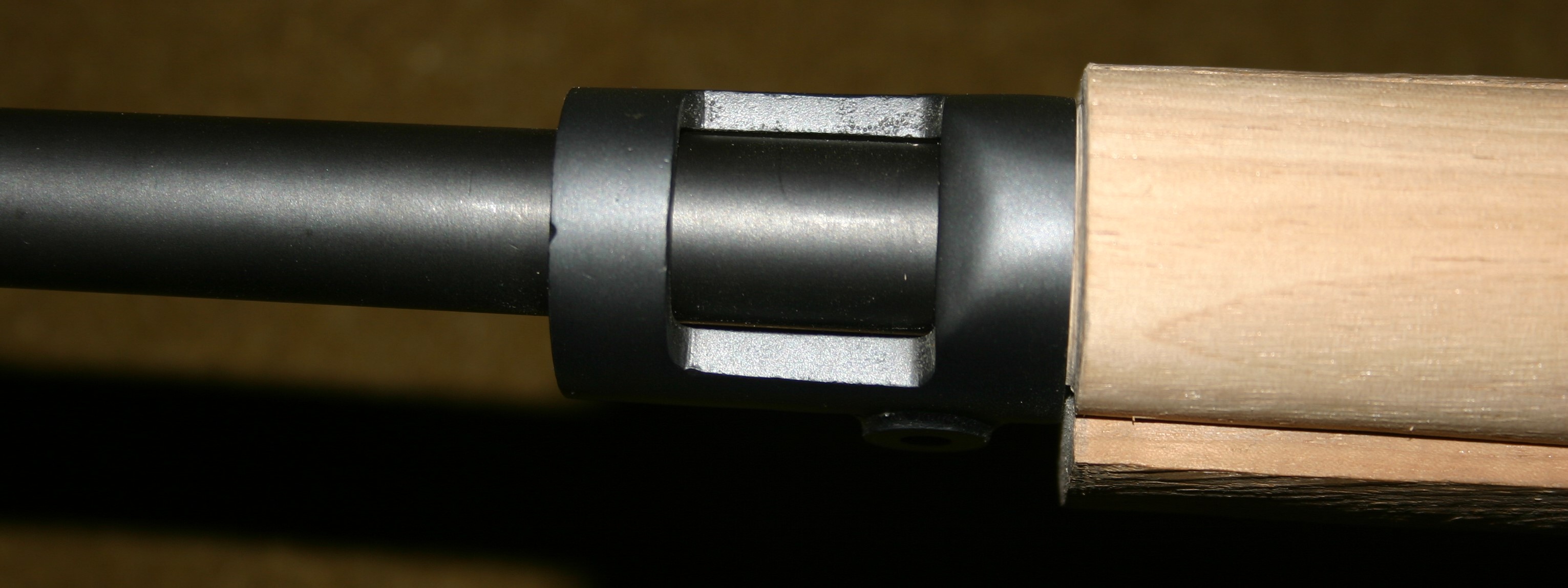

    Well after what can easily be guesstimated at an easy 50 years +, the old girl is now dressed again.
    Far from being over, there's still a ton of filling, sanding and tweaking to do but complete (sorta)...
    The nosecap has been 90% fitted, so are the handguards.
    This was necessary to be able to center and redo the splice for the forend... which will be the next step.
    ALOT of ''meant'' remains but that will be an easy task, later on..
