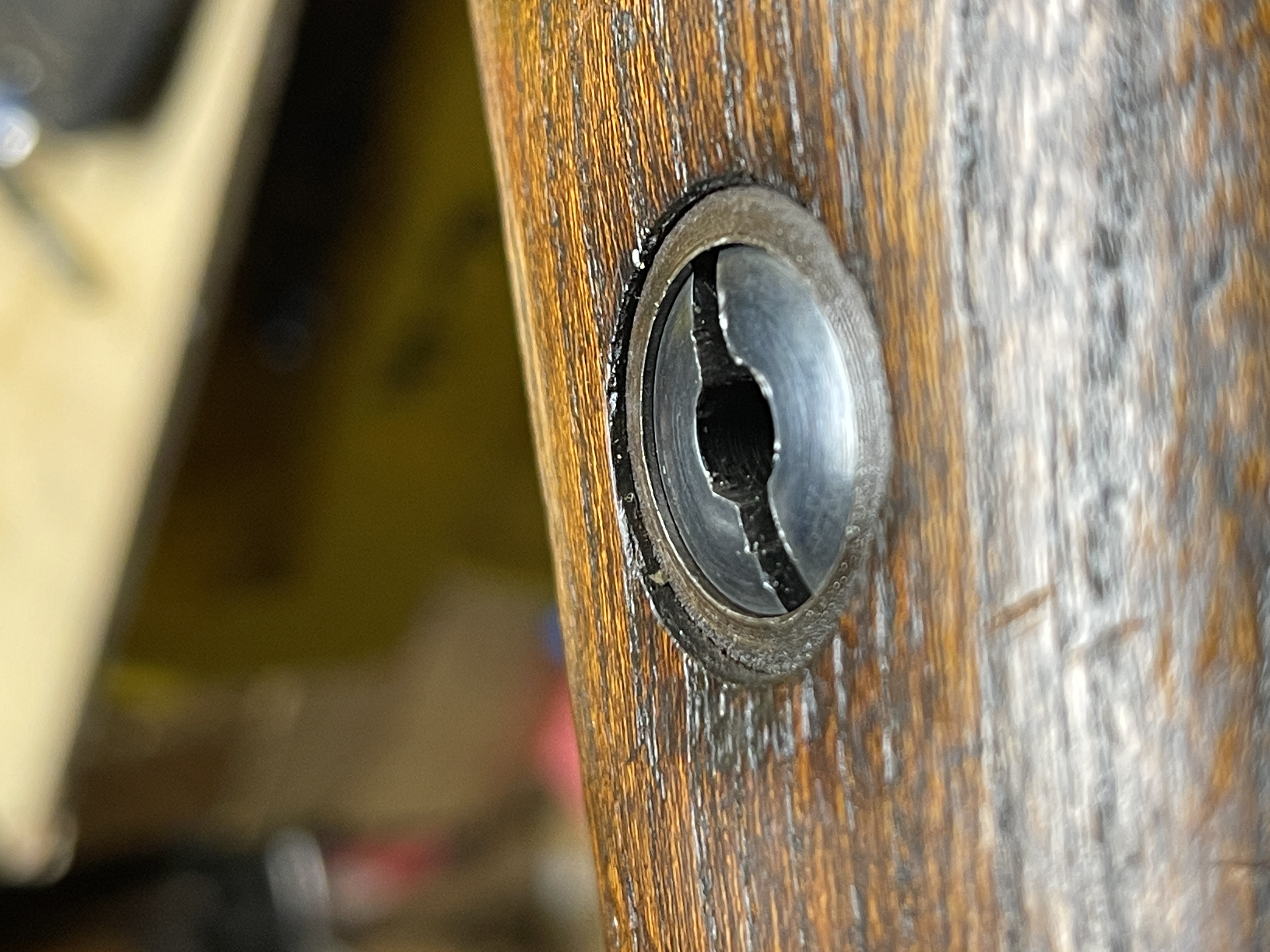

    Good Evening,
    With the help of Scott (Georgia) and Brian (Manitoba) I have successfully reproduced the missing large action bolt and the T-Gewehr is now complete and waiting for cartridge components. Randy

    Good Afternoon,
    Now let's get picky. As you can see in the photo, the new bolt is blue and the finish for the T-Gewehr is brown. What solution(s) and process would I need to brown the new bolt. Thanks, Randy.

    I think you'd need an acid wash to brown it a bit. There are firearm manufacturers that produce new firearms with this brownish "Rustish" look. I don't mean browning...
