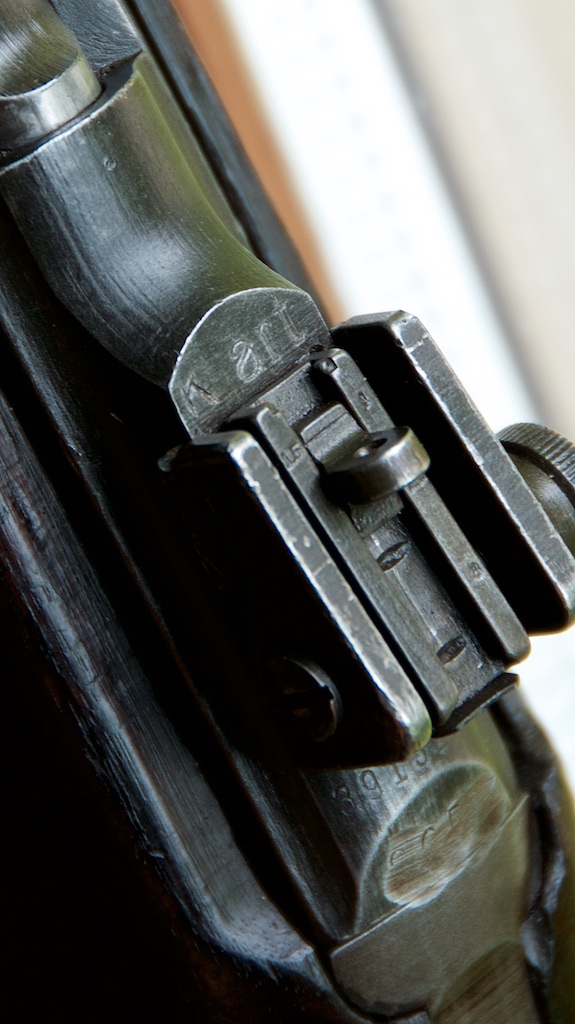

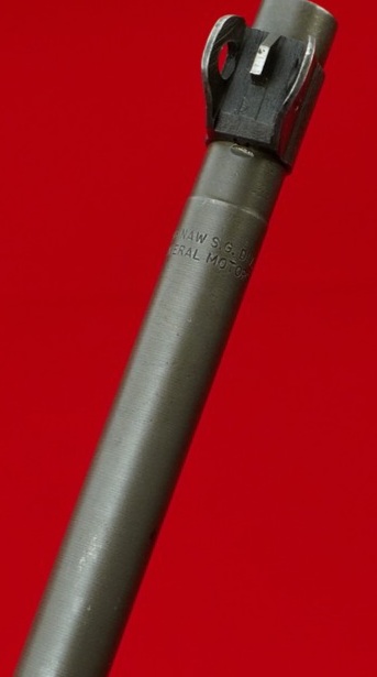

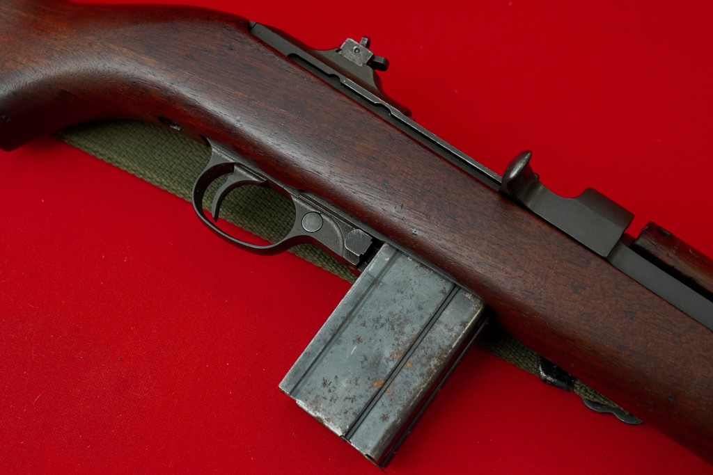

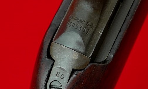

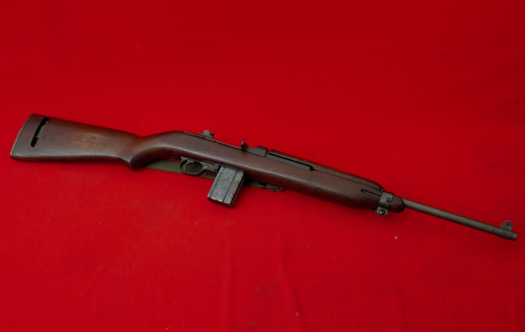

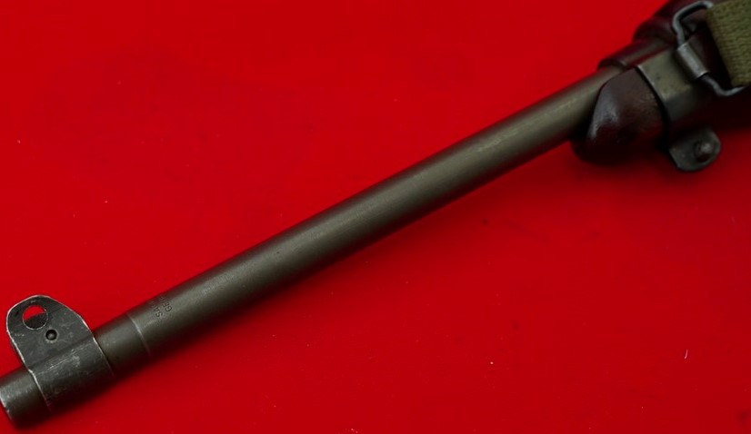

    Long time since Ive posted on here, I mostly just read the posts and enjoy you'alls back and forth. I have a 1/45 Inland and a 5/44 Winchester and Id like some help on who's front sight this is, because it sure doesnt look like an SG. Also, the front barrel band, is it SG? The flip sight
    has no markings on either side. Are the marks in front of the flip sight signs that it had an adjustable sight? I am not in possession of the rifle.

    If the markings on the receiver in front of the sight are the same as the serial number then its a good bet it had an adjustable rear sight at some point.

    I'm not sure I understand. In front of the rear sight? I didnt think they looked like numbers, but I don't know anything about staking.

    Barrel band looks like a salvage job, or the inspector was sick that day. Some commercial bands have a hole on top of the band. That might be a modified type III or commercial.

    Quote Originally Posted by SRiverrat11 View Post
    Hello Riverrat,
    Nice to see you back around, also seen your a new member on the CCCF.

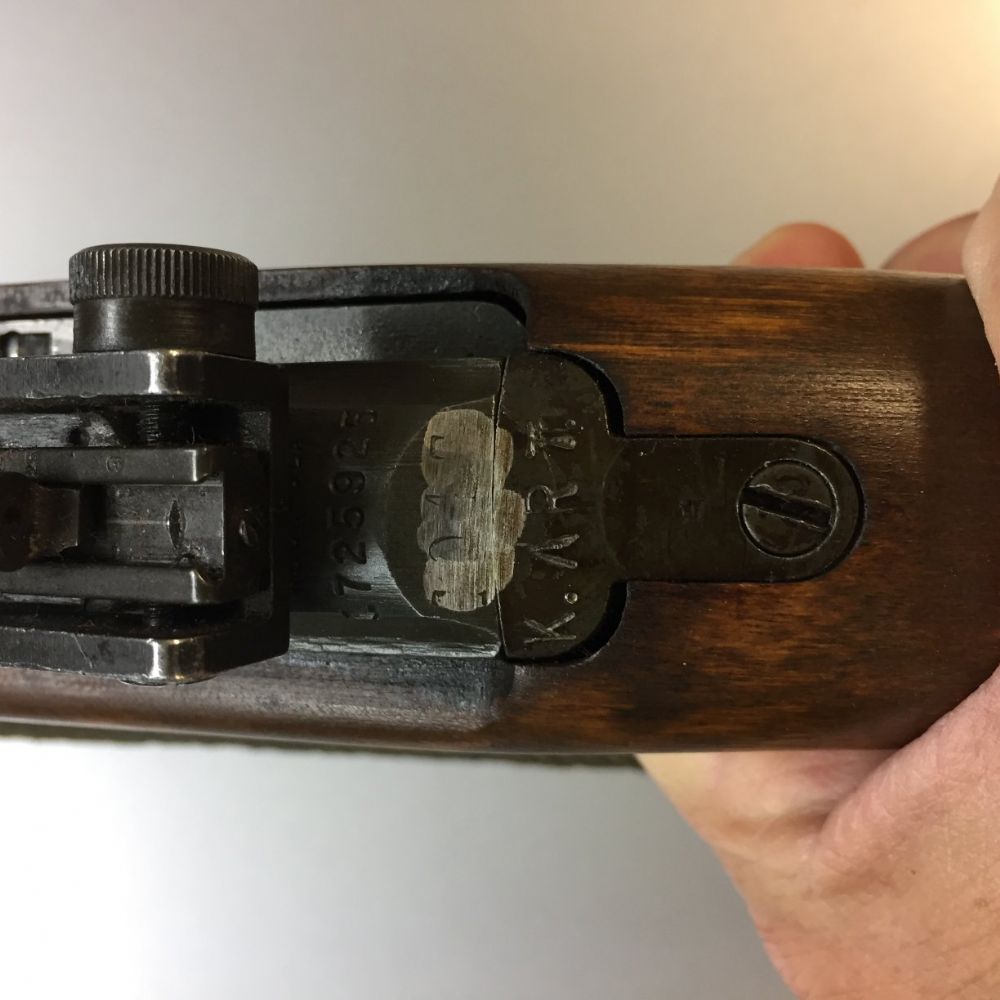

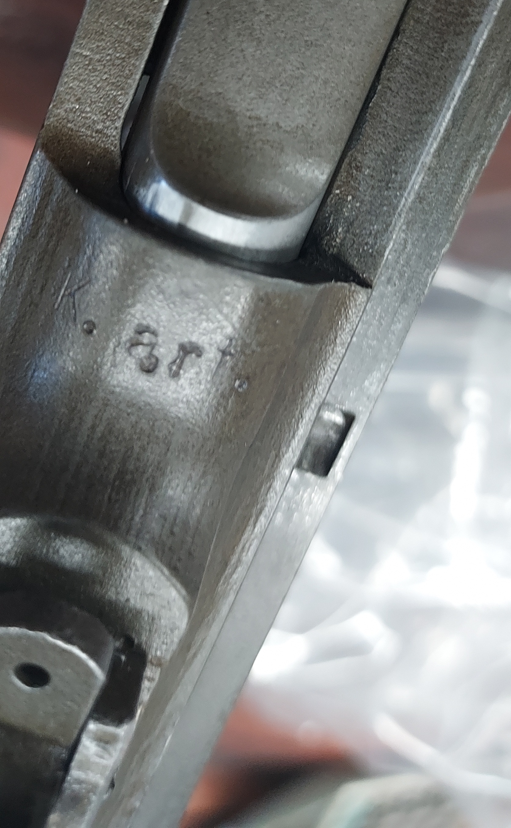

    What Bruce is wondering is if the serial number had been stamped in front of the rear sight. This was done (at times) when a Adj rear sight was installed and made reading the serial number hard to see. Adj sights were usually heavily staked with punch marks that looked like craters on the moon. When zoomed in I don't see these stake marks on this one. The current rear sight looks real enough, maybe better pictures would show markings on the sides or on a leaf. Some of the books say some Flip sights weren't marked, but that would be rare. I see the ridge on the front sight and closer pics may show it's marking.
    Some concerns like the barrel band Floyd pointed out is from a commercial carbine. No USGI band used a Phillips head screw. One view of the barrel makes it appear like it has some shadow/wear from having a late style bayonet band on it, but that could be the picture. But for sure that front sight has been removed, even if just to remove the bayo band or install the current barrel band.
    The markings or remnants of being seen on the front bevel between the front of the rear sight and rear of the bolt may be what's left of the marking K.art which stands for the Coastal Artillery in Norwayicon. I've seen this marking electro penciled/engraved and/or stamped. Normally when seen it has another marking done the same way that I believe stands for the unit, section or something similar. I've seen the K.ART on the recoil plate and the other marking on the rear bevel behind the rear sight or vice versa. I've also seen the markings on the front bevel and rear bevel. Without better pictures I can't be sure on yours. I see some light grind marks on your recoil plate, but is possible the rear bevel on that receiver has been ground on to remove one of the markings, then refinished.
    I have a few pictures and a link that you can look at and see if you can recognize the markings on the front.
    BTW, most all K.ART's I've seen are import marked. Many came thru CAI.
    1st one I seen at a gun show the seller told me the KART stood for Korean Army Reserve Training. This KART stamp was on the rear of the receiver. The other markings had been grinded off the recoil plate. When I asked why they'd remove or grind there he said: " Any US Carbine brought back from Korea had to be grinded there"
    I asked why they would grind it?
    He replied:
    "So we know it came back from Korea"
    I knew what it was but must admit it was entertaining listening to his skit
    Just to be clear because I'm tired, I have seen the K. ART stamped on the receiver just at the rear of your bolt. I suck at trying to crop pictures, below I was trying to draw attention to the rear bevel on the receiver... Where I believe the other marking was, but has been ground away and finish doctored.
    Link to a couple other Karts:
    New guy with an OLD Friend - The Carbine Collector's Club
    KART K98icon: https://www.milsurps.com/showthread.php?t=41953
    HTH,

    I received the Saginaw
    I went to the gunshop to see it firsthand. You guys are spot on! K.art on the bevel below the front of the bolt. rear bevel below the serial number ground down(but somebody did a good job grinding it) I called the guy and told him the problems. He said it was on consignment and he knew little of carbines. I think the barrel must have been replaced, there is no import stamp underneath or anywhere else. No shaded area where the bayonet lug would have been. He told me he would accept a return, and not charge me the 15% restocking fee. So, he is an honest guy.

    I've heard about K.art examples without Import markings. Read about reports from here in the States and from Canadianicon owners.
    I know M1icon carbines were used by the Norwegianicon resistance fighters. I read about them on a Norway museum site and seen a M1a1 with a Germanicon scope on it that belonged to a Officer, General (?).
    Norway also received Carbines thru the MAP Program: Foreign Military Assistance
    I seen part of a Documentary about Norway trying to push out the Germans.... before help from Great Britainicon started. It's in Norwegian (I happen to be 1/4 Norwegian and 1/4 Danishicon) but used google translate to watch what I did see. When time allows I'd like to see the rest. It was called 'Alliert og Alene’ aka ‘Allied and Alone’
    I believe it was a 3 part series.
    You know that Carbine could have made it back here well before Import stamps were required.
    I'm not sure maybe someone knows if the CMPicon ever released any.
    There's a Carbine Newsletter that had some info about Norway's Carbines, I'll try to find it when I can.
    I believe I can see a Punch style stake mark @ the rear sight, if so very likely it had a adj rear sight.
    But IMO I'd be happy to own a K.art even if it needed a couple tweaks. It has added 'History'.
    Most likely, Your Carbine being marked K.art was part of the 1950-1963 MAP program.
    I believe there were 6~ Norwegian Agencies that used them. So markings can vary, but K.art seems to be the most commonly reported. Not that they are common or seen that often....... at least by me.
    Lastly over on the CCCF there is a Saginaw Receiver research project going on. Your serial number falls in the window. Take a look: Club Assistance Saginaw Receivers - The Carbine Collector's Club - Page 1
