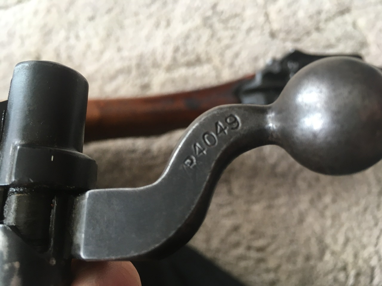

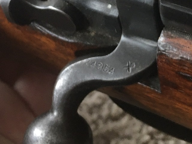

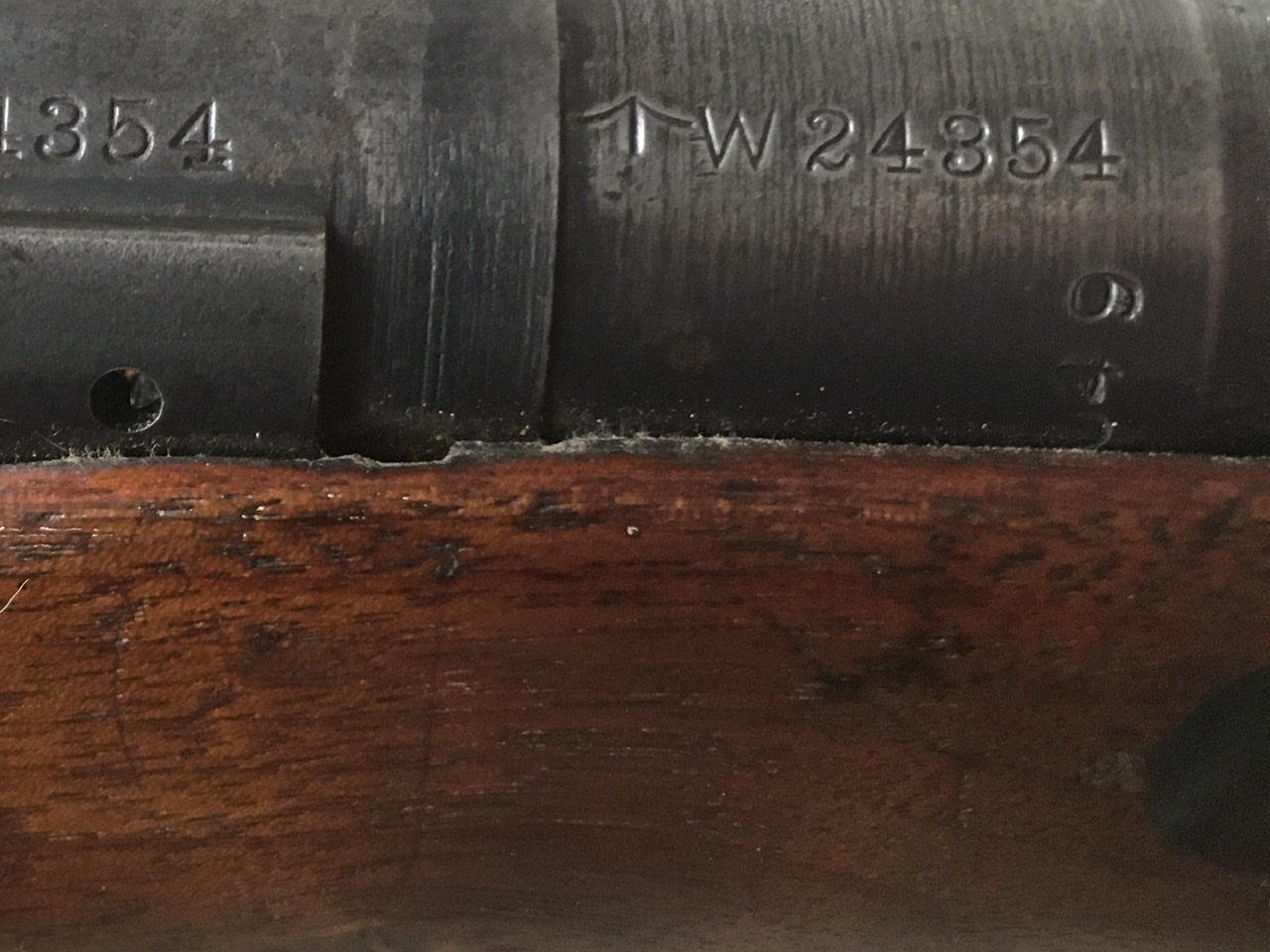

    Interesting, I love the worm holes so to speak, here is the Winchester pics,
    P4049 is the unknown series, you can see the matching original serial on the other side of the bolt and on the receiver/barrel, where expected. With the group under the woodline.
