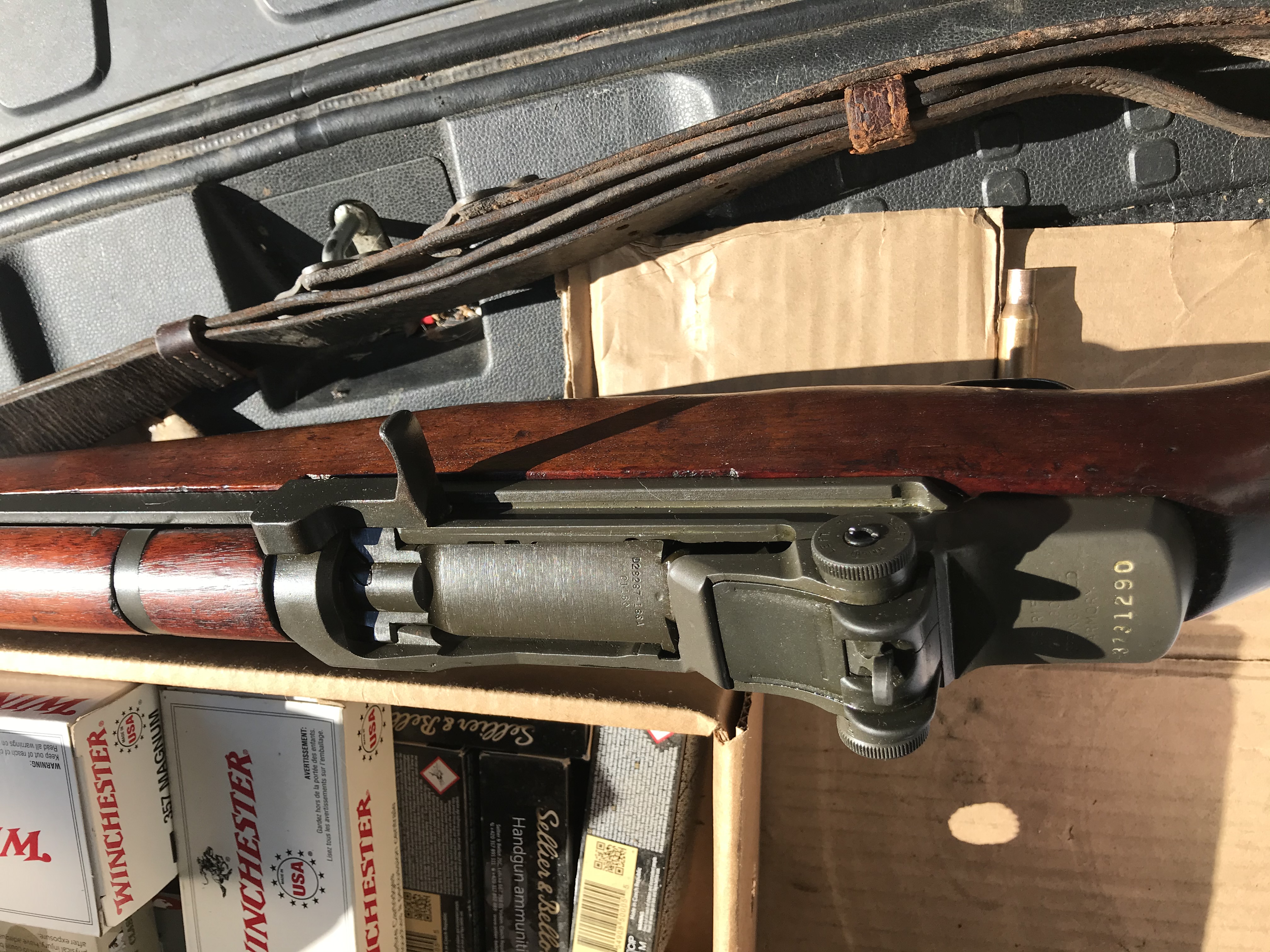

    I meant that I need to delve deeper into its micro structure. I have to know quite a bit about anodizing and plating for work, but I'm lacking when it comes to parkerizing.

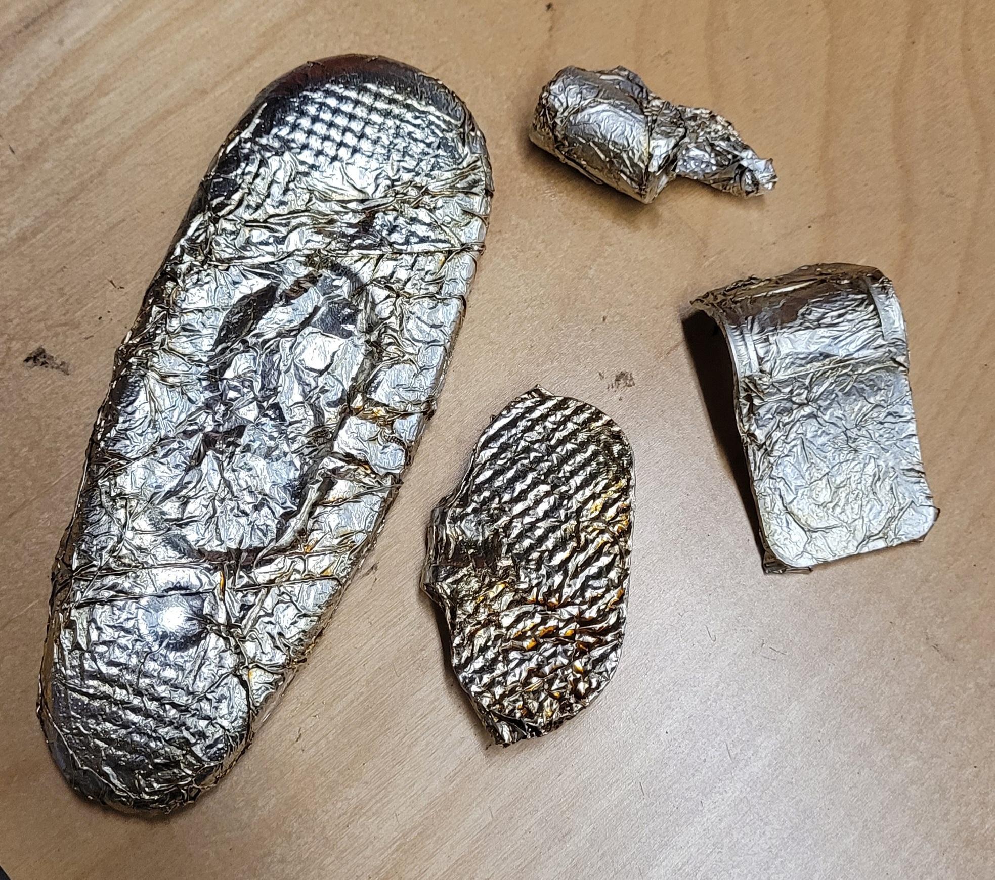

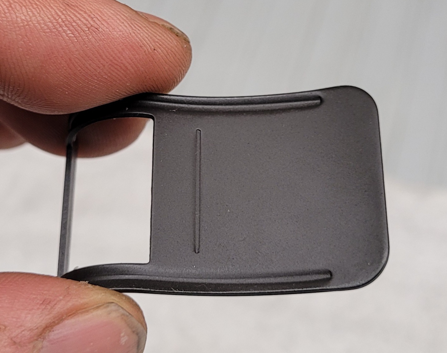

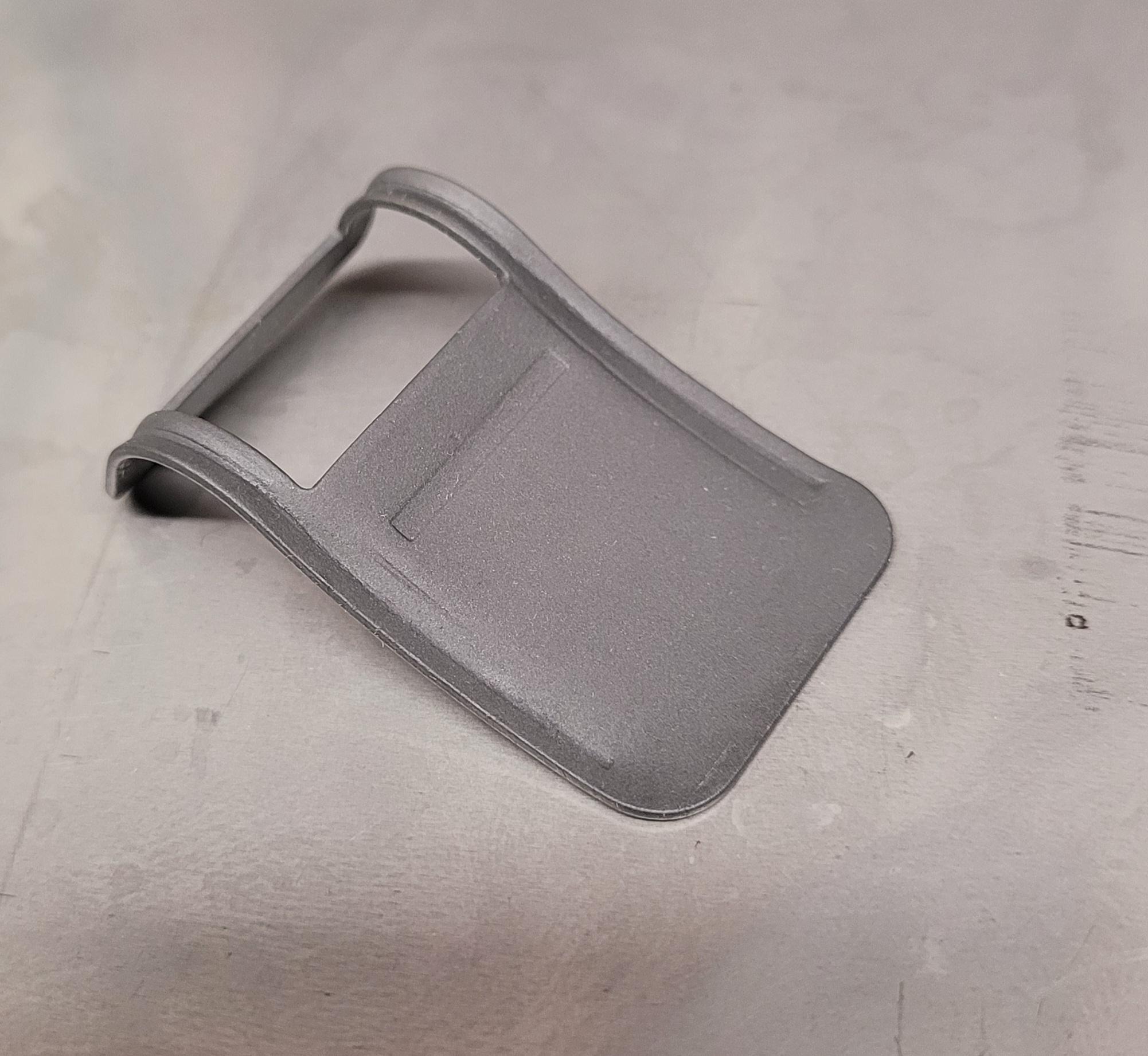

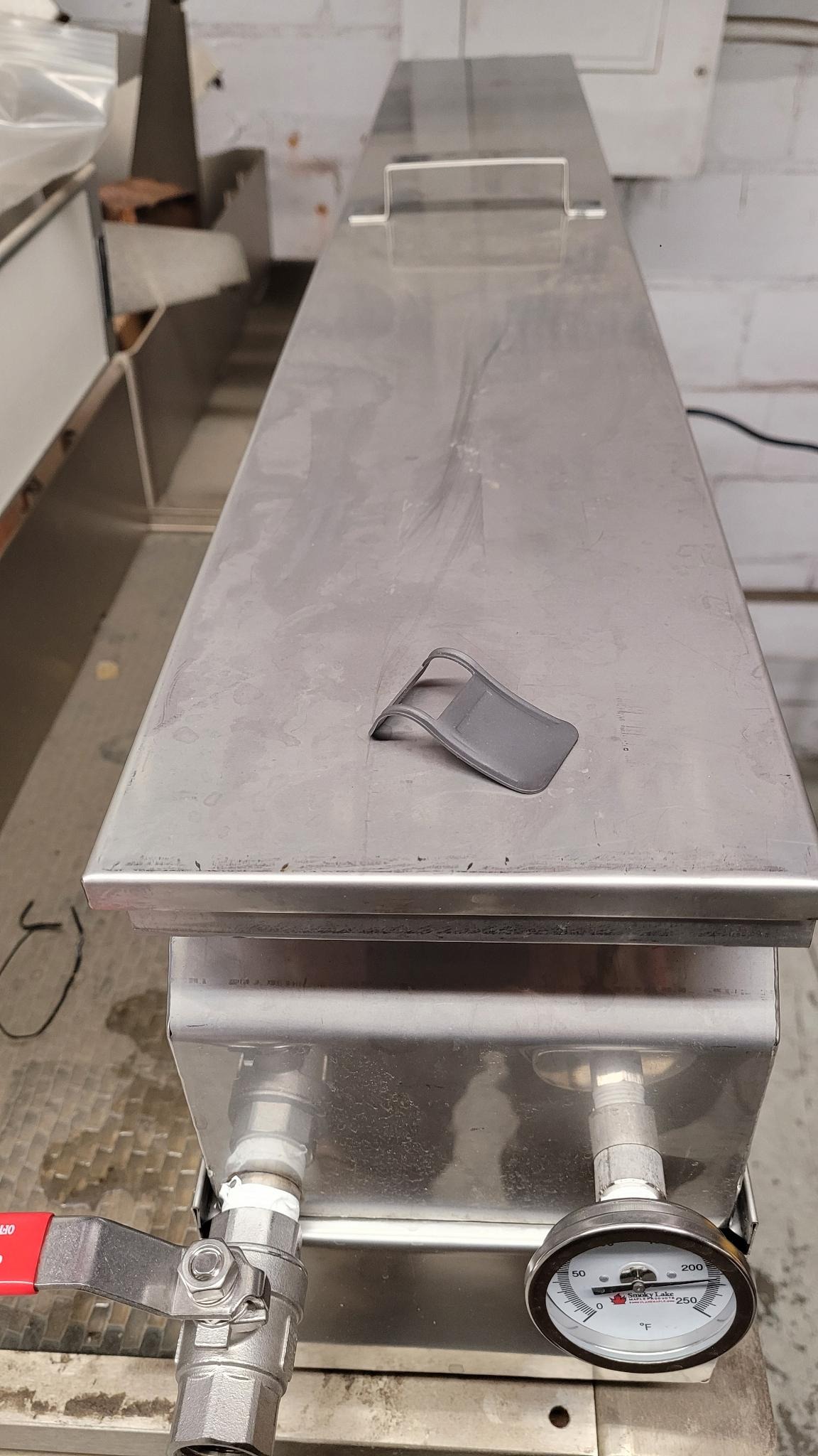

    Here is my current setup. I''ve done one zinc test part, then went on to a few others where the intent is to turn the parts green. The owner of palmettoenterprisesparkerizing told me to take WWII era cosmo (they have since changed formulation) and slather the parts as soon as they dry coming out of the bath. Then wrap tightly with aluminum foil. The parts will be unwrapped in a week.
    The basic grey color matches a buddy's 1911 he got from his grandfather. Grandfather was a Korean War era MP who purchased his duty pistol after service. But it was shipped at a later date (he has the box too...). The pistol's finish is immaculate. Methinks that it was shipped later because he requested it to be refinished and they skipped the chromate bath. I know that there are two lines of thought as to why the park turns green, some people saying cosmo, others the chromate treatment. Ok, enough digression....

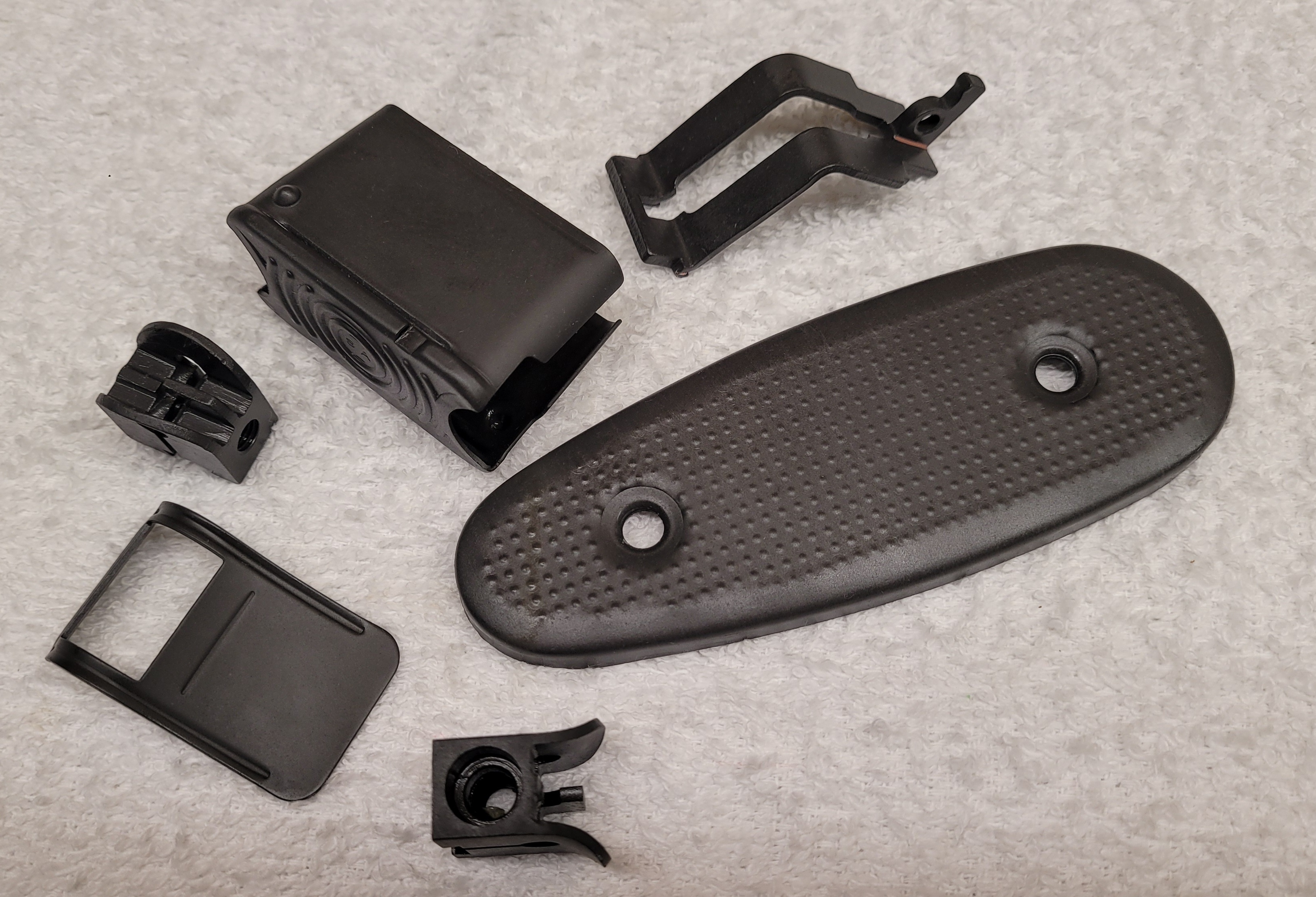

    Latest effort.
    Manganese park. Bead blaster is down so I had to use one filled with old "Black Beauty" slag and kept the pressure down to 45psi. I wasn't particularly careful on prep. This is to test the process.
    These were just some test parts. Post war South American buttplate, a SA clip left out in the rain, some sights, and a reproduction rear sight cover that came with a horrible shiny blue (yeah, the ribs look awful, ain't nothing fixing those).
    Can't wait to get the bead blaster back up and do another batch of parts or two before a receiver.

    Everything looks fine.

    You did well!!!

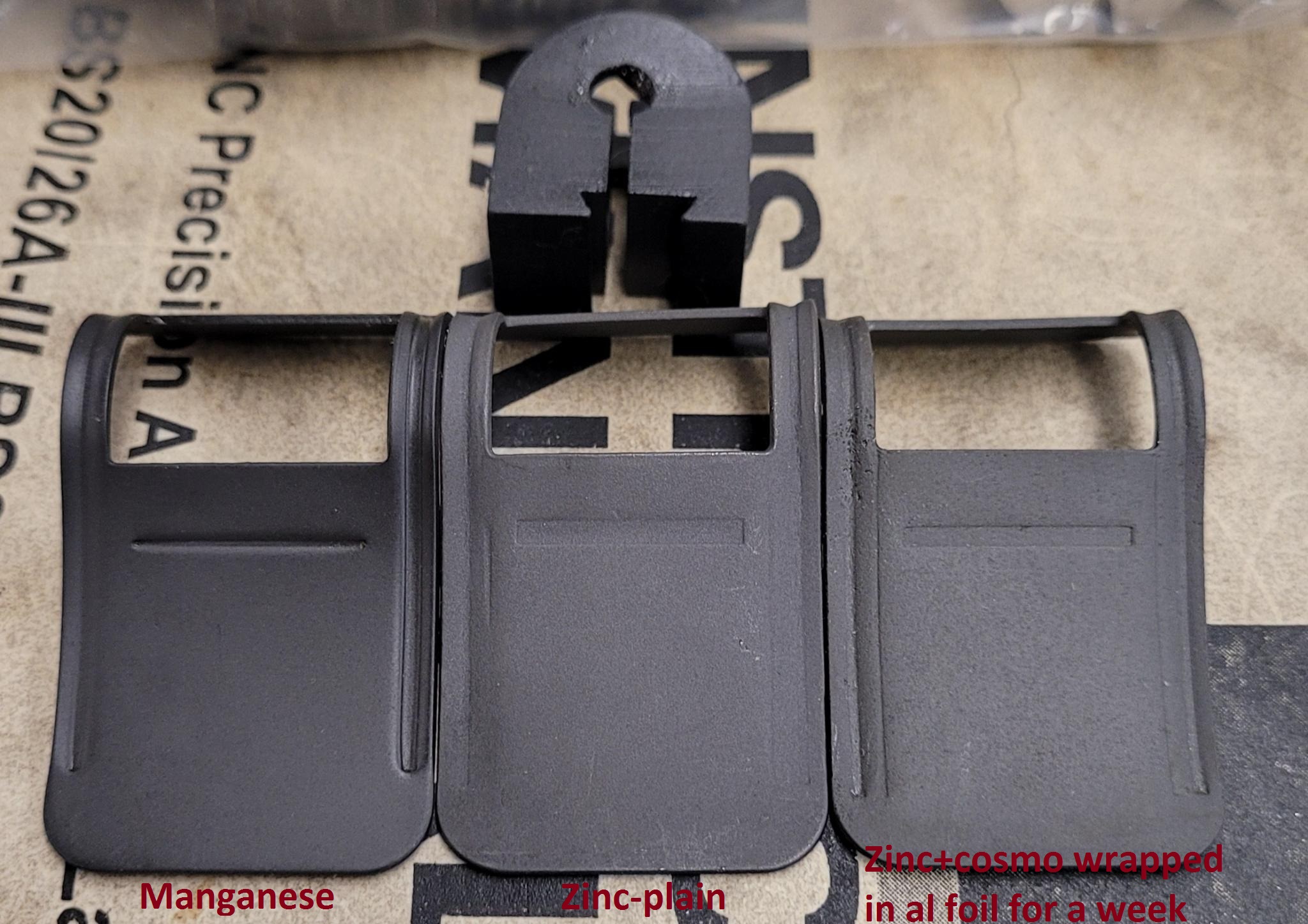

    It looks great. Your years of work paid dividends.
    This is my first two weeks attempts.
    The part at the far right was slathered with 1944 cosmo then wrapped in foil for a week. It looks to have just the *slightest* green tint.
    I still have a buttplate and door wrapped. I will put it in the oven to see if I can accelerate/further the process.
    The front sight was manganese parked and came out much much blacker than the far left sight cover.
