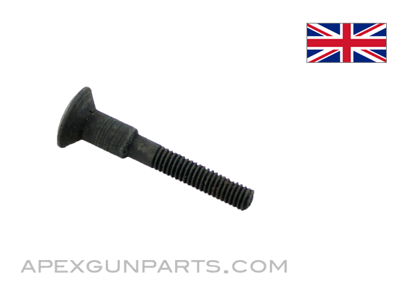

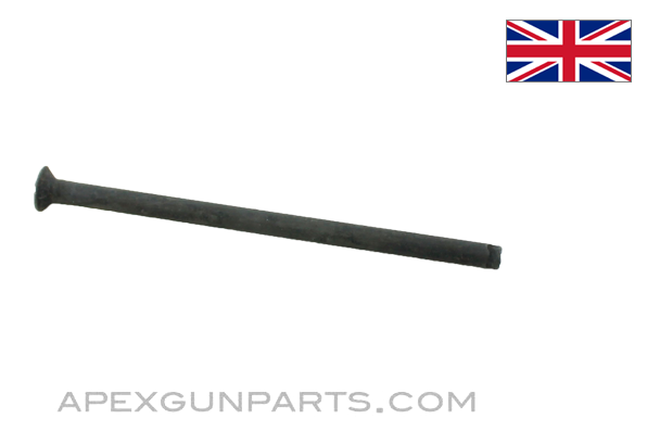

    Hello all, Sorry to have taken so long to reply. I work 12 hr night shifts. I printed out Peter's articles on fitting the bolt and took it to my gunsmith along with my rifle. He already had this article in his possession and knew all about properly fitting the bolt. I have another question though concerning the buttstock cap screws. I went to remove the buttstock cap to change out the worn buttstock pad and the top screw is unlike a normal wood screw. It is some type of small diameter machine screw with a larger shank. Has anyone seen this type of buttstock cap screw before? thanks
  11. #20
    West side
    5,042
    05-30-2025
    12:17 PM
    Why replace the original pad? If the "toe" is worn you could invert it. If shooting comfort is the issue a slip-on butt pad will be cheaper, easier and better. The purportedly softer repro pads make very little difference IMHO.
    As for undoing the bolt, if you have the original "Chicago bolt" fastening in there, just unscrew a few turns and tap down gently to see if the long shank will move; it might be rusted in. No point trying to force it to rotate with a driver, you'll only b-----g up the slot.
    Repeat the undo and tap process until the long shank is about 1/4" out at which point you should be able to pull it out by grabbing the head in soft jaws etc. The threads are fine so too much hammering will ruin them, especially if unscrewed too far. Likewise the counter-bore on the long shank is thin walled, and careless use of a drift/punch will potentially b-----r that up as well; use only a brass one if required.
    As for which end of the bolt is which, logically the short end would be uppermost, but you'll only find out when you start to undo them.
    My two cents.
Name:	Screenshot 2022-11-13 at 09-02-54 Enfield #5 Long Rod Screw For Buttplate Bracket NOS.png‎
ID:	128875   Click image for larger version
Name:	Screenshot 2022-11-13 at 09-02-15 Enfield #5 Buttplate Bracket Short Screw NOS.png‎
