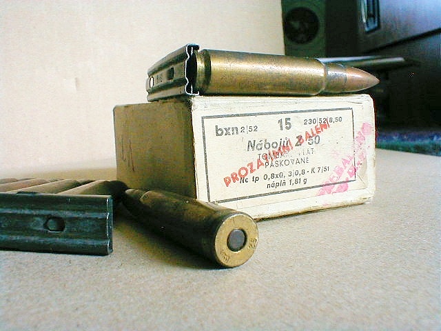

    7,62x45mm
    Buffalo Arms 7,62x45 brass is your best choice and less work compared to converting 6,5 Carcano and 6,5 M-S.
    At one time early C zech 7,62x45mm was brass cartridges but very rare to find these days.
    I have fired both rifles and like the original Cz 52 best !
