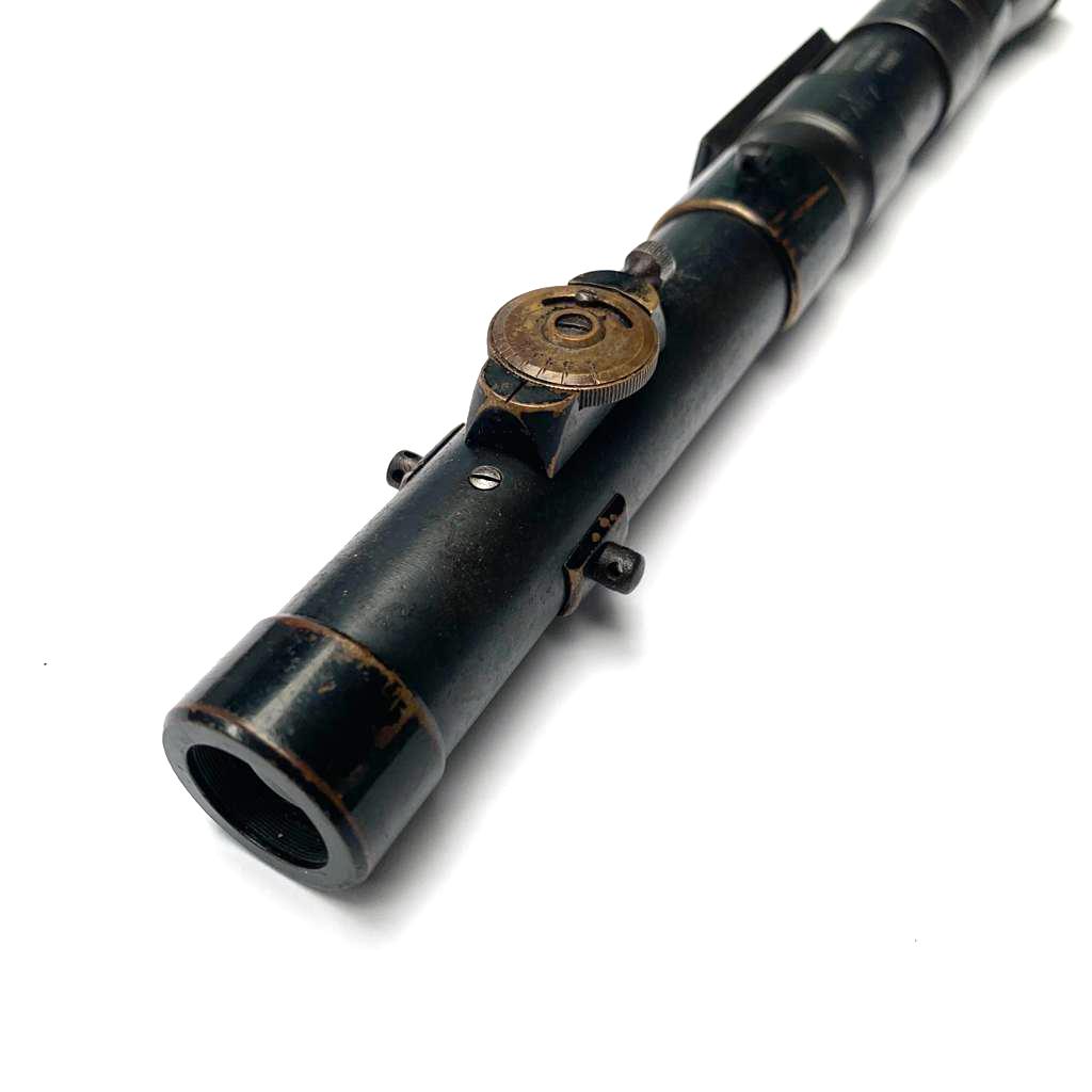

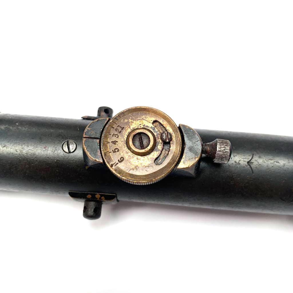

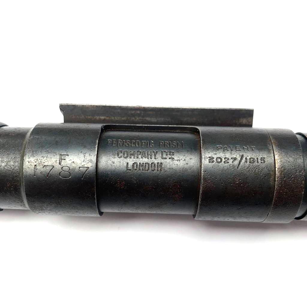

    I was curious what the experts think of this PPCo scope and mount. It all looks original to me but I'm certainly no expert. It is a tad odd that the base has different serial numbers on the end of the mount versus the top as I thought these were both the rifle serial number but maybe I'm mistaken.
    I'm sure these were all hand fitted to the receiver bases but the dovetail tensioning strip (for lack of a better term) is a bit different then others I've seen pictures of with the end being an L shape. Just curious if this is all normal.
    If it is all legit, any thoughts on what the value would be?
    Thanks.

    First, I know nothing about PPC scopes.
    My only observation is that the numbers on the base look stamped, but the number F1787 looks to me to be hand engraved.
    Could the F1706 have been applied by a civilian gunmaker? Engravers are quite capable of that sort of work.

    The same as mine. They are original.

    All looks perfectly original to me, though unusual in that it appears to have been refitted to a different rifle from the punched out serial number on the end of the dovetail, and the very well engraved number on the ring.
    By the look of it a user during or post-war has adjusted the placement of the range scale to give what appears to be 900 yards of adjustment.
    By that I mean there are nine cut lines and at the higher ranges (4, 5, 6,) the gaps between the user-cut lines are almost exactly the same as the original markings which would make it pretty certain that .303 was the cartridge rather than the scope having been fitted to some other rifle post war.

    Just back from foreign travels. It looks good enough to me, too. The tensioning spring looks to have been replaced although a view of the face of the spring would be helpful. I presume it has the two small BA screws that locate it? There should then be a small piece of shim steel sandwiched between the machined face (on the rings) for the spring & the spring itself. It was intended to be replaceable so that the male dovetail of the rings could be made a snug fit in the female dovetail of the base. You just varied the thickness of the shim.
    The tensioning spring isn't a big issue. I've recently made about ten each for both mount bases & rings. My new machinist made the rings & bases but couldn't face doing the springs as well!

    Quote Originally Posted by ColinA View Post
    These were always hand engraved and not stamped when being done. Though not the best to compare to since I had filled the markings with crayon, but maybe to give you a better idea -> https://www.milsurps.com/showthread.php?t=76761
    Numbers on front and rear of scope ring if I remember correctly are pairing numbers - have to check all of my scopes to maybe be able and give better detail than from memory.
