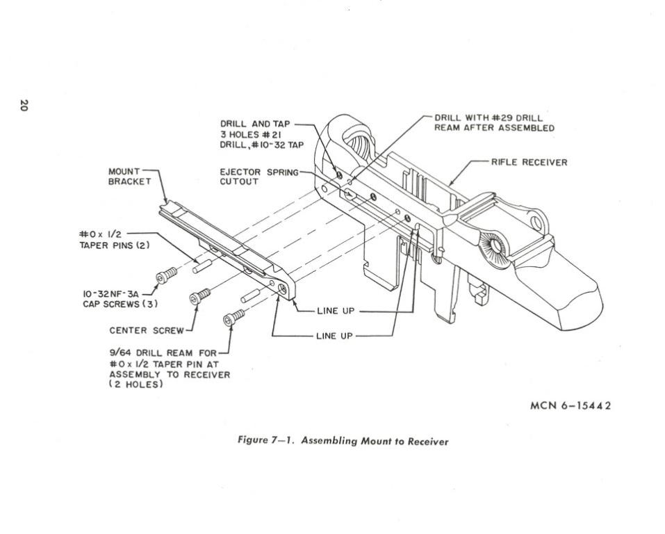

    There was an additional document that specified how to acquire the drill and tap. Have not found that yet. I doubt any collector would accept a USMC modified Receiver as legitimate unless there was a video of Col Puller him self with his black and decker.
    See Sec. 7.2
    INSTALLATION OF TELESCOPE MOUNT ON UNDRILLED AND UNTAPPED RECEIVERS

    Mark, that's not a document, it's a technical manual. A complete instruction on how to. A document would suggest a direction to undertake conversions. It's better than just a document, which could be taken as read and left to rot. With this to light, collectors can re-examine their rifles...this would have been used.
