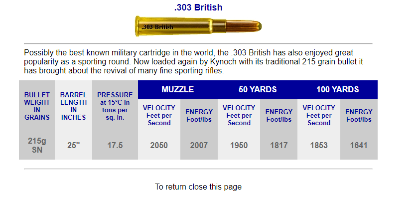

    For those of us in the UKicon Malcolm Seller makes an excellent flat base 174gr .311" and a MkVI 215gr, not to mention all the heavier black powder stuff he produces.
    Kynamco / Kynoch also make a MkVI
Name:	MkVI 303 Ammunition Kynoch.png‎

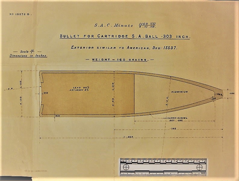

    I don't have any MkVI information, but for interest, the 'original' MkVII was actually a 160gr bullet,
    I cannot find where I got this info from - so apologies to the author for not acknowledging them.
    The original .303" MkVII bt weighed 160 gr and was approved in Mar 1910 and had no cannelure. Production lots of this ammo failed accuracy proof and the bt was redesigned.
    The new bt retained the exterior dimensions of the above but the aluminum core tip was shortened and the lead lengthened. The new bt weighed 174 gr and was approved LOC 15629 Oct 1910.
