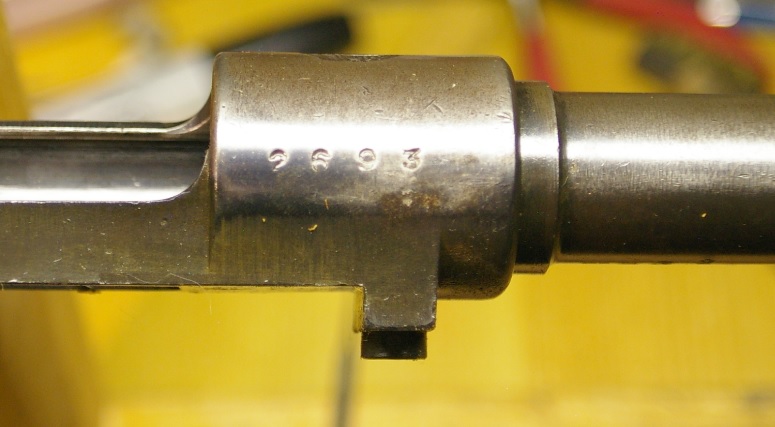

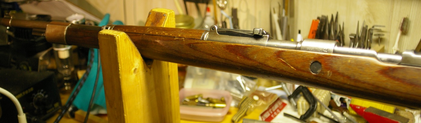

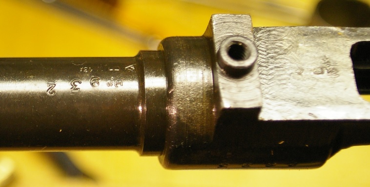

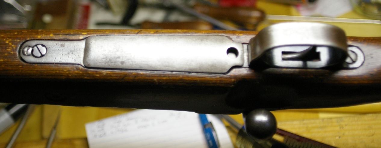

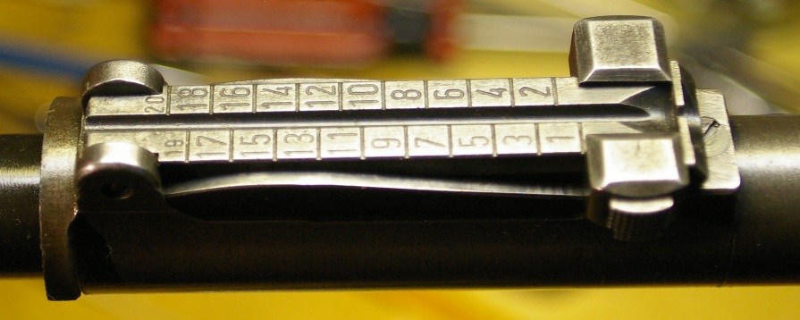

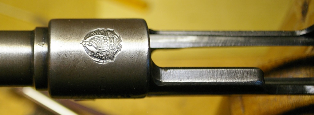

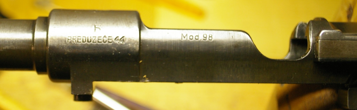

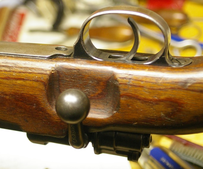

    I've watched several Youtubes on this M 48 Mauser. I have one I bought in the 80's and it doesn't identify with the ones I've seen.
    Here are some descriptions of mine;
    1. There doesn't appear to be a production #

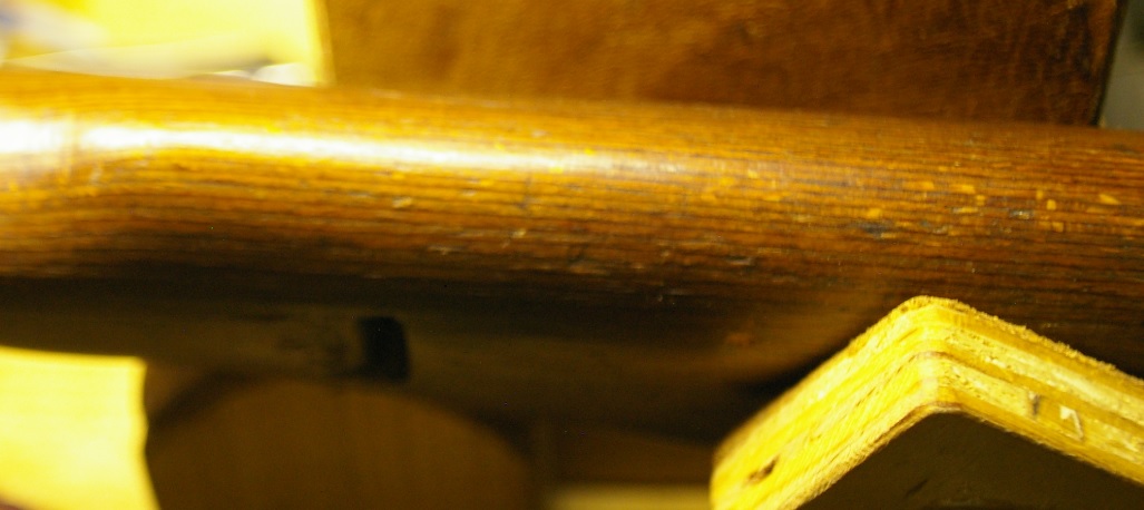

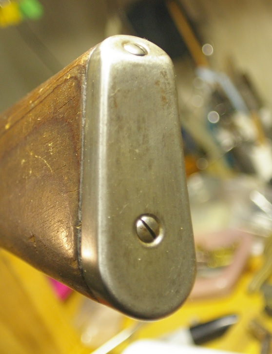

    2. Butt plate is a cup type. The stock under the butt has a bolt take down hole but the butt has no drilled hole.
    3. The follower has a bolt stop for the last shot.
    4. Left side shows "Mod 98"? Is this a FN or German mauser?
    5. Has a Yugo crest but no M48, M48A, M48B... stamp.
    6. Laminate stock
    7. Round bolt knob, not a half moon one.
    8. Stock cut out for bolt handle.
    9. Hand guard stops at rear site, just like a K98icon
    10. No stock serial#.

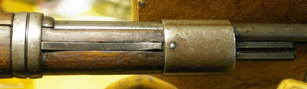

    11. Milled floor plate without a stamped#.
    12. Import marks show :Yugoslaviaicon M-4 (no 8) and the importer's stamp.
    13. 8 mm mauser which I have fired.
    What do I have here?

    I found this info on this site. It appears I have a Germanicon mauser that was captured by Yugoslaviaicon pre-1950 and was refurbished by them. Would this be a German/Yugo mauser hybrid?

    Quote Originally Posted by micrometer View Post
    a Germanicon/Yugoicon mauser hybrid
    They had so much stuff they bought off arms suppliers, Tito had absolutely everything in there. They made their own Mausers as you must know and if something broke or if there was a reason to refurb, they'd replace with their won manufactured stuff and it would be a mix and match. They made good stuff, for sure.
