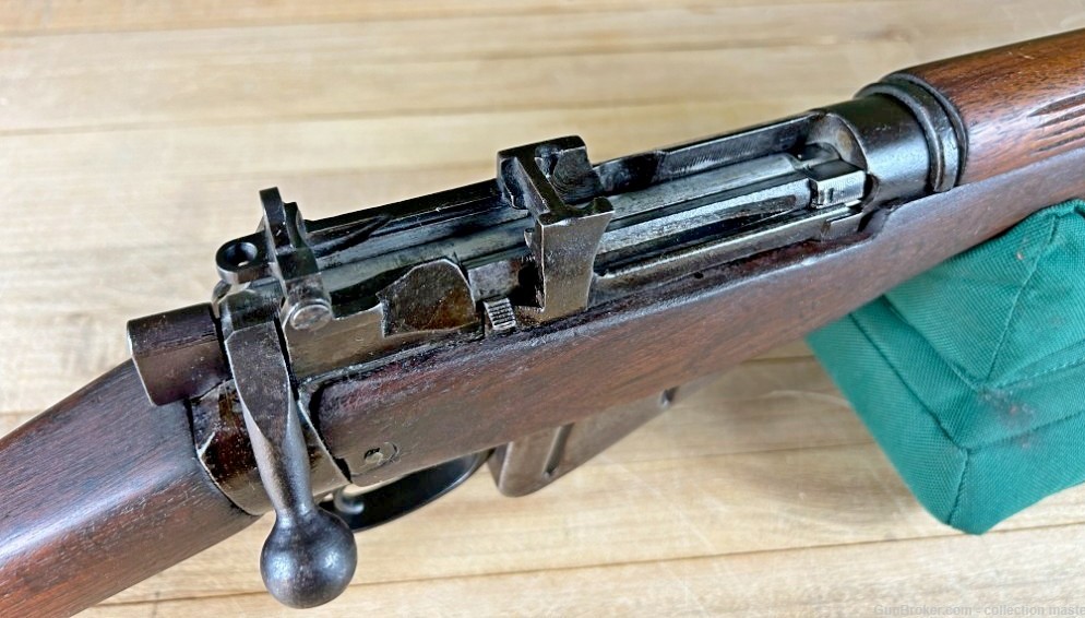

    A2307 Is it a C pattern?
    Found a dealer online with this. They don't know what it is. It is a bit rough. Has the plunger and not the ball/indent for the rear sight. Should I post pictures and questions here, or on another part of the forum?

  5. #83
    West side
    5,038
    05-23-2025
    06:44 PM
    It's a VERY early rifle built at Fazakerly(? on a leftover trials body (receiver).
    The simplified cocking piece is very unusual, and we wouldn't expect to see a Long Branch pressed safety catch spring either on such a rifle AFAIK.
    However the finish is a close match, so perhaps they have been together for a long time. The screw is different from the standard as well.
    I see the Enfield "D/E" hybrid mark on the safety catch and that is what we would expect on such a rifle.
    Does it have the "waisted" foresight protector, hinged upper band and other such trials rifle features?

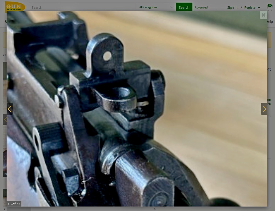

  7. #84
    Contributing Member Jim Shortill's Avatar
    Oct 2024
    11-03-2024 @ 11:43 AM
    Southern Maine
    4
    05-23-2025
    08:44 PM
    Here is the link from Gunbroker. I'm not in buying mode, but figured I would pass it on for knowledge sake. It has many of the trials rifle features. I've been super busy at work so I haven't had time to get my geek on, and go through my reference books.

  8. #85
    West side
    5,038
    05-23-2025
    06:44 PM
    Forget most of what I said in #83 which was based on the previous statement that the backsight had a ball-bearing detent: it doesn't.
    The machining on the receiver is also too rough to be RSAF(E).
    Does have a "trials" safety though.

  9. #86
    Oct 2024
    Southern Maine
    4
    05-23-2025
    08:44 PM
    I did notice it had the plunger and not the ball indent. That's why I was thinking it might be one of the later C pattern. So what's your thought on the rifle? A high number trials that was mostly rebuilt? Do any of the others rifle number identifiers (on on other trials rifles) - A XXXX - come with a prefix / suffix letter like this one?
  10. #87
    West side
    5,038
    05-23-2025
    06:44 PM
    My opinion is it's an early receiver from Fazackerly, the A suffix serial indicates this, but rough as guts overall and definitely NOT a trials receiver.
    The No.5 trigger guard doesn't "belong" on an early rifle, and the cocking piece was probably stuck on in order to make it look superficially interesting by whoever sanded the wood down and generally massaged the rifle before it was put in the auction.
    Aside from the safety, there is a chance the mag might be a trials example, from the level of finishing overall, but one would have to see rib and platform for the marks if any.
    FUGLY importer marks as the crowning glory.
    Edward Bernays, 1928
  11. #88
    Oct 2024
    Southern Maine
    4
    05-23-2025
    08:44 PM
    Thanks for the insight.
    Sorry for the delay. Tore my bicep and had both daughters cars go down at once. Been a week of slow repairs.
    And yes, that import mark is a truly horrific scar.
  12. Thank You to Jim Shortill For This Useful Post:
  13. #89
    Advisory Panel Lance's Avatar
    Dec 2007
    05-21-2025 @ 04:55 AM
    New England, USA
    703
    Lance
    05-23-2025
    09:44 PM
    Your rifle serial number is really "EA23074A" with the last 4 hard to read, made at ROF Fazakerley in June 1943. Sorry, it is not an early rifle. If you look off-axis just below the backsight above the safety catch arm you might see "ROF(F)6/43"
