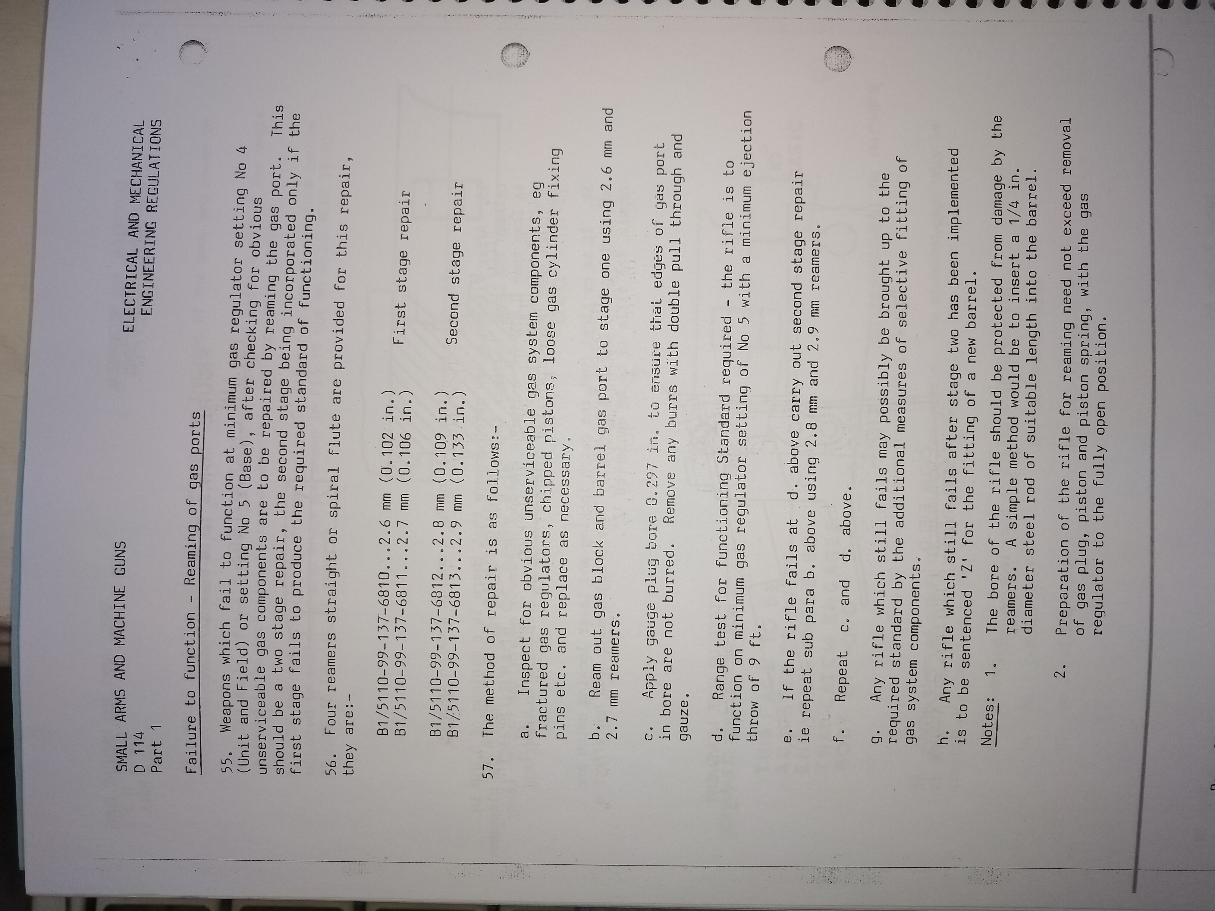

    Do any old "gun-plumbers have the "late-issue" data for the L1A1 gas-port diameter and the "instruction about boring it out a few "number" sizes to keep the old girls chugging along until the various 5.56 replacements came on line. I am certain it was an approved practice / official instruction in that short time, . Some seem to doubt the existence of such an instruction, so I am throwing it open to the "Council of Elders".

    Hi Bruce,
    here the reference for reaming the gas port to stage 1 and 2 from EMER Regulations/Field Level Repair.

    I just received an email from a former "colleague" who tells me, as per the "instructions", that "if the gas vent in the barrel is "fouled", it is to be cleared with a "No. 42" drill bit.
    I looked up the chart and it tells me that No 42 is 0.0935 inches or, 2.3749 mm.
    But, he could not quote the the "last-ditch" oversized hole allowance.
    I still cannot find all of my own notebooks, unfortunately.
    Australianicon L1A1 documentation was in the D250 "decade" (series). The scan of D114 is a scan of an official document ; i.e.., a UKicon "Electrical and Mechanical Engineering REGULATION": a whole different family, but still a "rifle" reference. These were not something in my "system" back when I wore the "other" baggy green, down here in the Penal Colonies..
    The Brit "numbers" for "adjustment" to the gas vent look 'reasonable" so I will file the excerpt in a sleeve in a ring binder for possible future reference. Perhaps something for a post-port game of "Military Mastermind"?

    Regarding the drill-bit sizes:
    No42 is somewhat smaller then the reamer sizes in that EMER excerpt; my "source" could be in error (heaven forbid). The trick with the L1A1 setup is that you can go to the range / firing tunnel with rifle, ammo and some tools. The desired result o consistent extraction and ejection performance at a specific regulator setting. I will try to find an actual copy of the performance specification.. (Something about gas setting 4 and cases landing nine feet away? Prone position?)
    Fire a couple of rounds of NATO ball at the recommended setting. If the cases fall short whip out the trusty battery drill and set of Number drill-bits, clamp the rifle in a padded vise and have at it. Tiny increments at each adjustment, please.Remember to thoroughly remove the swarf from the bore, before resuming........
    If on first firing, the cases end up in the next grid square, Bubba may have been busy, before you.
    The saga continues..........
