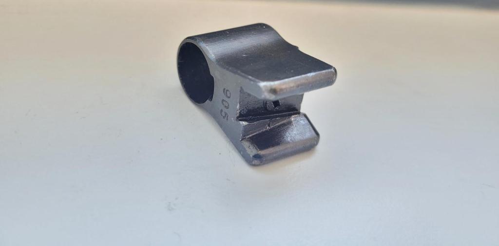

    I just purchased a K11 online and didn't notice until I got home that the whole from sight was "loose". So... not the blade, but the whole front sight can moves. It move left, right and front and back. I have never seen this before.
    My question is two fold. Has anyone see this before? and is this correctable?

    Can you remove the blade
    Maybe a screw underneath you could tighten up

    I am sure I can remove the blade but I don't recall the base having a slot/screw hole under there. I will try and do some searches for a front sight to see what I find.

    Yes there should be a screw underneath. Probably covered with century old dried grease?

    Good news, I will have some work tonight to see if I can tighten it up. Thanks for the great picture!!!

    Worked great, thanks!
