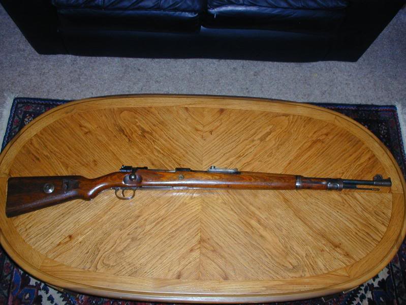

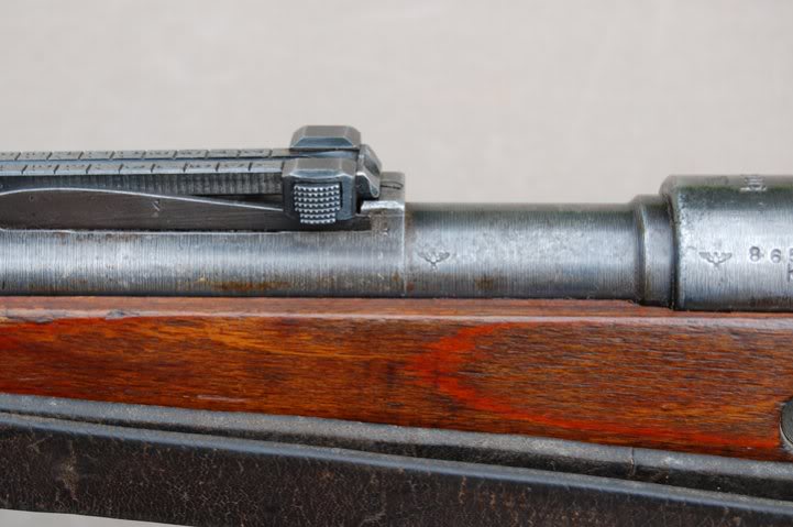

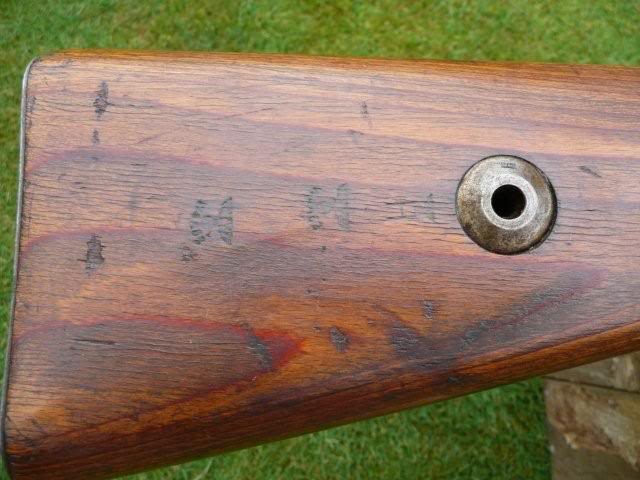

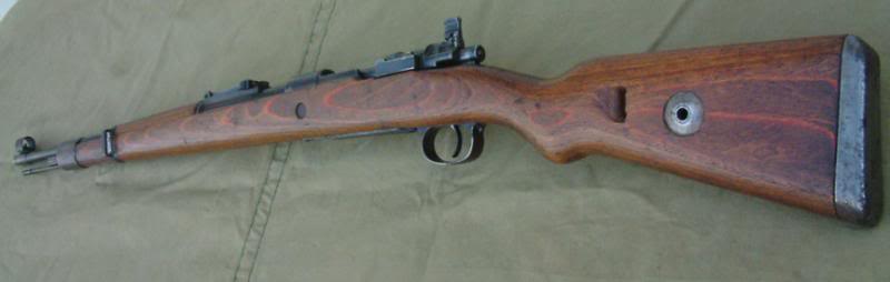

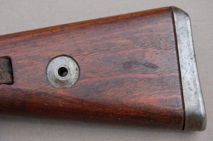

    Actually, that's not true. For most of the war the laminated stocks were stained and a finish was applied. The exact nature of the finish isn't known but it was probably linseed oilicon based. The German soldier's manual "Der Rekrut" specified "linseed-oil varnish" for stock maintenance Care of Weapons / der Erste Zug
    It was only near the end of the war that the stain and finish fell out of use, as the overall fit and finish of the stocks declined. "Chatter marks" on the stocks from worn out tooling were left unsanded and are frequently found on late war stocks.
    "Golden" or blonde Kar98kicon stocks in period pictures are very rare.

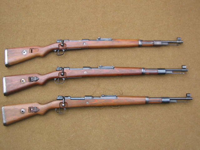

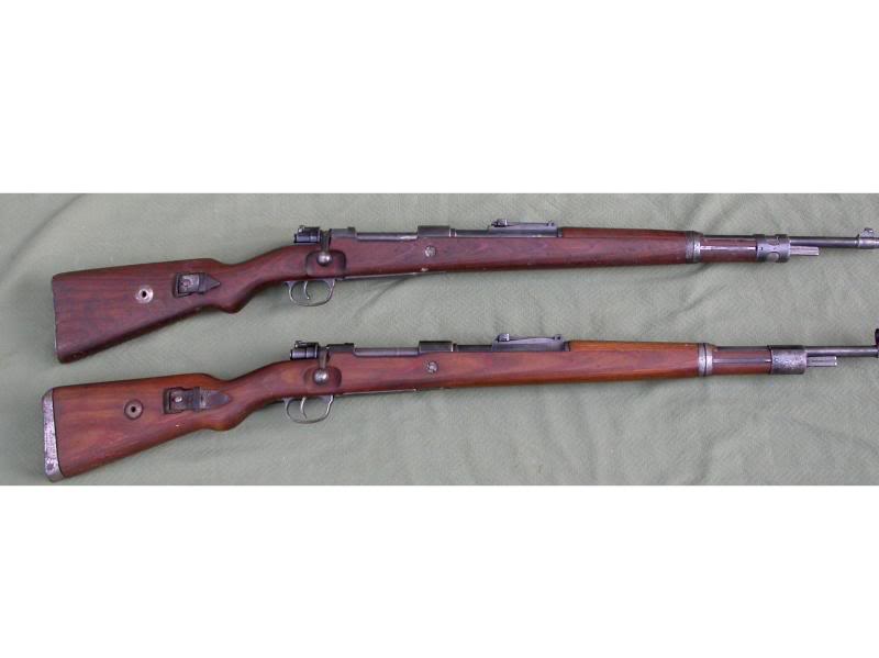

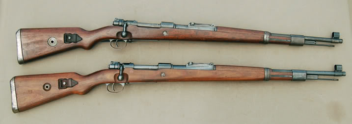

    Here is a selection of unrestored, un-messed with rifles to give a sense of what the stocks should look like. These pictures are from the picture sticky thread at gunboards.com Picture Threads - Links - Gunboard's Forums

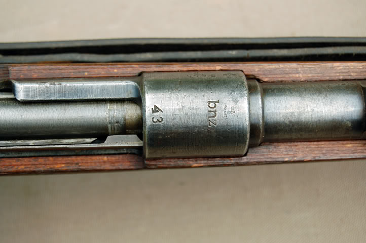

    Now, were there some golden blonde stocks? Yes, but they were rare. The top rifle is a dou. 43, the bottom is a dou.44. The color of the top rifle stock is far more typical of a Kar98k.

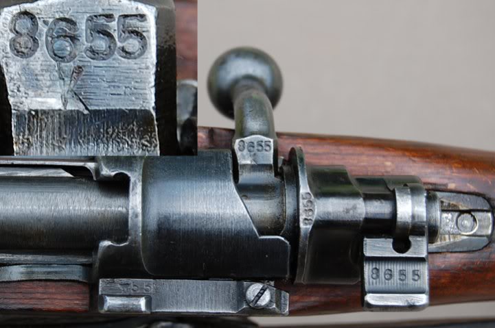

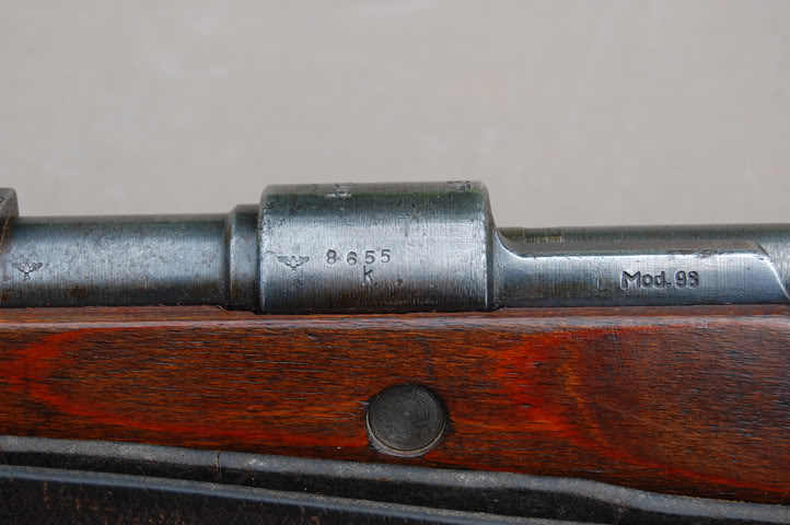

    We will have to "agree to disagree". I have 2 1938 matched rifles which are as blond as your last picture. The # 8655k pictured looks like an RC with that red color. Any of these stocks that are "stained" were done by GI's who brought them home. The rifle on the table is too shiney to be original. The first three in first picture do look 'typical' but it is from use, oil applied by troops,and just plain exposure. The manual you qoute says 'maintenance', nothing about factory finish. All referances I have read say they were not finished at the factory, if it is mentioned at all.

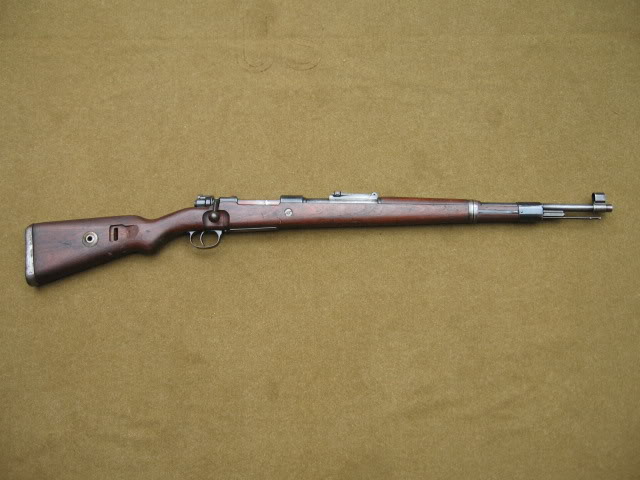

    Nope. Not RC.
    bnz43 war horse - Gunboard's Forums

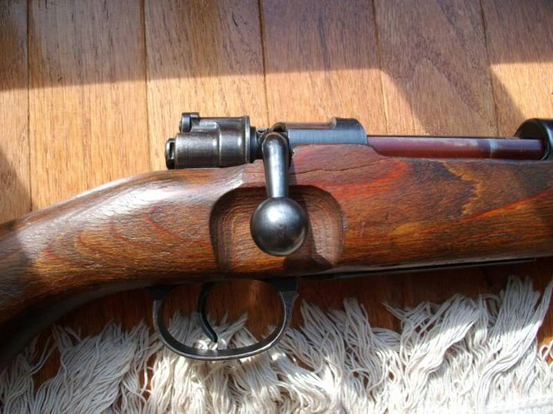

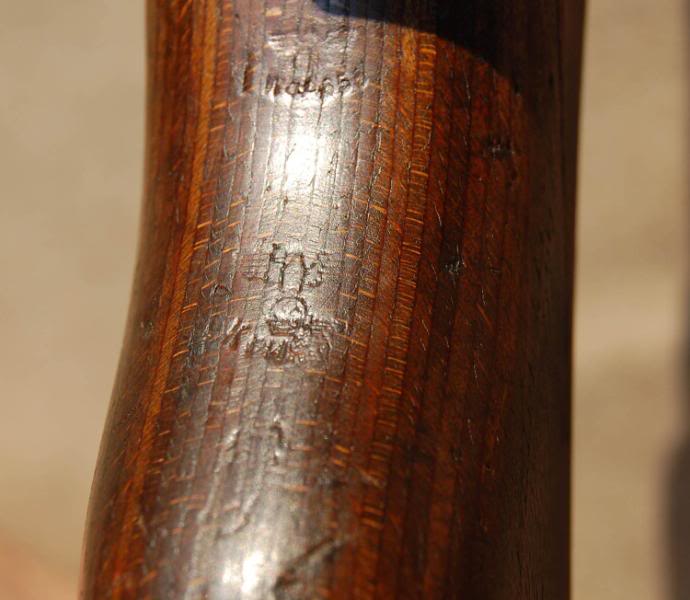

    Notice the tone/darkness of the stocks in these pictures (taken before any GIs would have had a chance to stain them ):

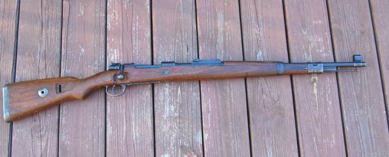

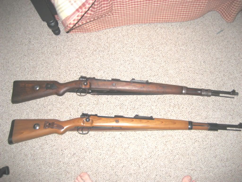

    Over in another forum someone posted a picture of two bringback rifles I was going to buy a Mitchell's Mauser, but not now. - Gunboard's Forums
    If you look at the stock bolt cutout on the blonde one, it has rounded edges, suggesting that it had been sanded some time after it left the factory. As you said, these rifles used to be cheap and many were sporterized, stocks sanded and refinished, etc.
    And again, there were a few blonde stocks, but they were rare. If you look carefully at this picture I posted earlier
    the rifle farthest from the camera has a lighter color stock than the others. Again, golden blonde stocks were the exception, not the rule. Most of them were orangish-brown originally.

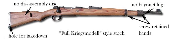

    At the end of the war the Kreigsmodell stocks appeared. These were simplified stocks with no bayonet lug, no cleaning rod channel, no routing for a band spring, and no bolt takedown disk. According to Law: "Kreigsmodell stocks are very rough and unfinished; neither sanded smooth nor stained and sealed."
