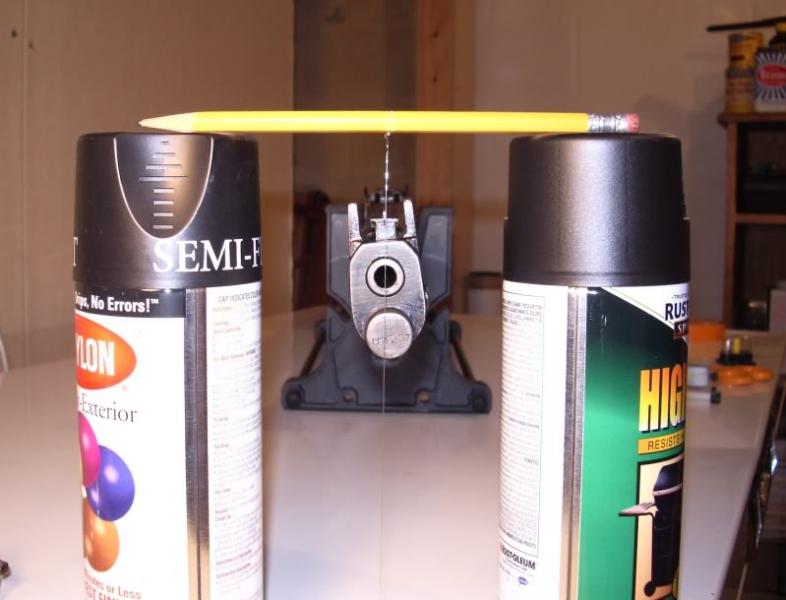

    U.S. Military repair and overhaul depots have inspectors that are trained and paid to ensure our servicemen receive equipment in serviceable condition. (and all other countries should have depot inspectors)
    If you put a small line level on your receiver, the flat of your Knox form and your rear sight and have a level bubble on all three gravity will NOT tell lies.
    A short length of fishing line, a lead weight and a pencil tells me my 2A1 has a warped fore end, the line intersects the front sight and is centered with the bore.
    Or to make some of you other people happy, the wood is as warped as the owner.
    The Engineering principal KISS, “Keep it simple stupid”
