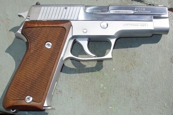

    Going by what I remember from looking into this in the past, replacement SN's have to go in a conspicuous location where it isn't easily removed, be at least .003" deep and at least 1/16" tall.
    Even a stolen gun that has had its SN removed can have it replaced or a new one assigned by the ATF. The picture below (found on SigForum) is of a recovered P220 (stolen from a gun store) that had an ATF assigned SN applied. Note the "ATF" prefix to the number.
