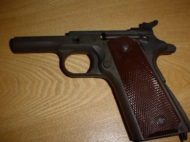

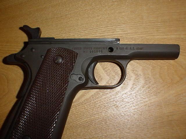

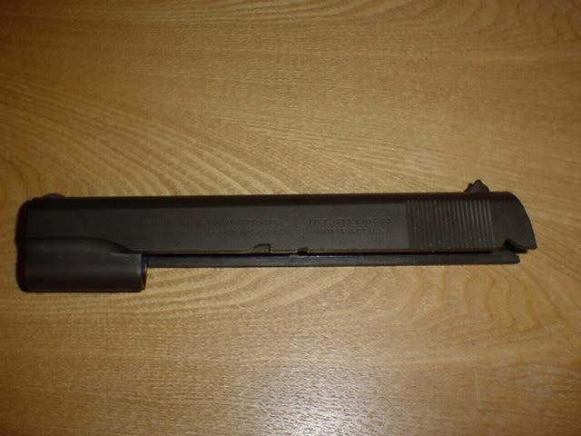

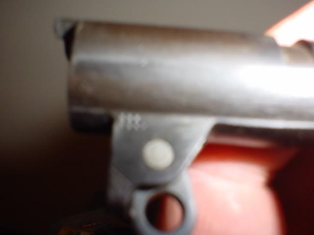

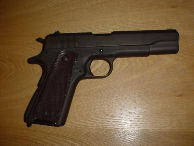

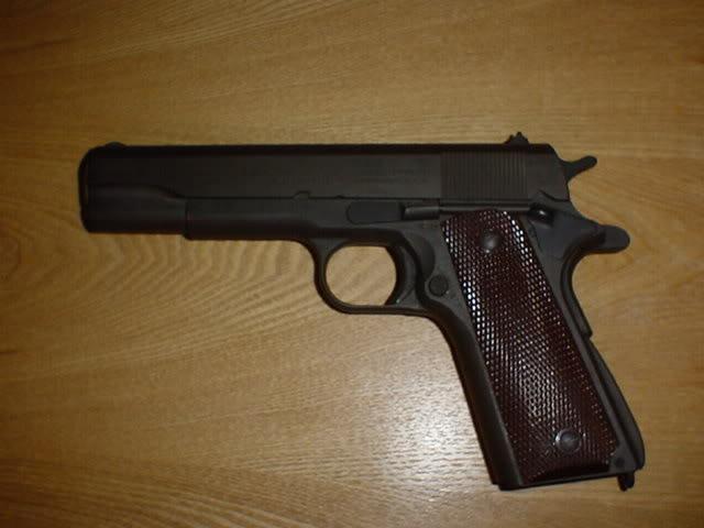

    Here's some better pictures of the pistol.(the royal court photographer I'm not)
    oldcanuck's Avatar
    Dec 2009
    11-06-2012 @ 11:06 AM
    Knoxville, TN by way of Edmonton
    117
    05-11-2025
    08:14 AM
    Now that we've seen some better pictures, I don't think it is an Arsenal rebuild. I think it's just an assemblance of WWII parts from various A1s. If a Colt slide, and a RRand frame were mated together at an Arsenal, the finish would match as they would have been refinished together.
