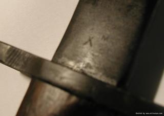

    Owen Bayonet
    Ok, it's arrived and I'm no better off, really. I have tried to take pictures of both sides but what markings are there are so feint that they don't show up. Here'a a description of what I can see....
    Ricasso, RHS marked very feint "X" (bend test mark) and "MA".
    LHS marked with an "L" over arrow Lithgowicon inspection mark and broad arrow.
    Pommel has "OA" (Orange) on the back.
    I've seen a few pics of a 3 '45 dated one with all markings by the book eg: MA over 1907 over 1. Could I take you up on the offer of pics of yours Warren and Lance. This one is nothing like the markings I've seen.
    TIA, Brad.

    Greetings Brad
    Your bayonet sounds similar to the 1953 Owens run at Lithgowicon. My markings on one side are tough to see and photograph, sorry in advance. On one side is the bending "X" with "MA" over "53" (very faint). On the other is "0" over a broad arrow over a "3" with a larger broad arrow beside it and then a "52". Both of my grips are SLAZ52.

    Quote Originally Posted by Lance View Post
    Greetings Brad
    Almost spot on, mate. On the RHS, the "X MA" are closer to the crosspiece and start quite close to the edge of the ricasso. The other side inspection mark is definately topped with the L for Lithgow and I've found the "52" where yours is. I'm guessing this one got a pommel from the Orange production line, hence the OA on it.
    Thanks heaps. I also found out they became known as a general purpose bayonet and were made available for issue for the SMLE in Korea.
