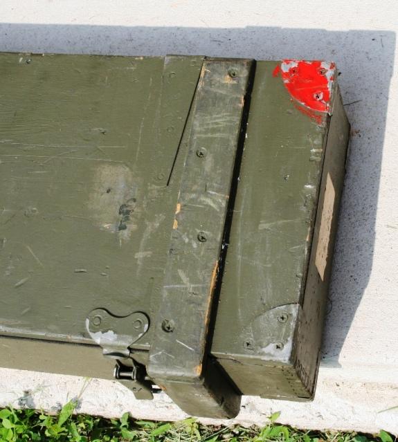

    Three were of identical construction and two had a curious red paint exactly covering the upper right hand corner metal reinforcement on the lid. I assume it is an inventory mark of some sort. Comments?

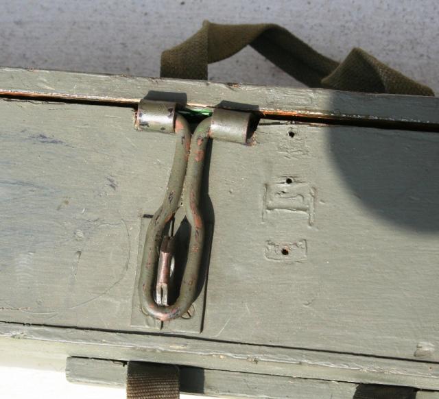

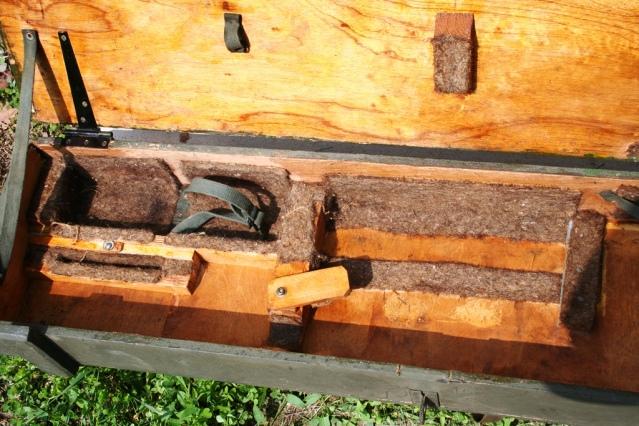

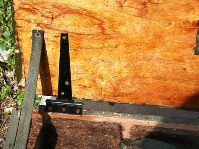

    The other box was of the same construction but totally rebult with one blacksmithed latch--not three and two barn door hinges instead of three. Witness marks indicate the the normal hardware was installed at one time. The rubber cushions were replaced with a coarse carpet like material. It looks like your lot has been playing with it. I wonder what they needed the original hardware for. If they could only talk! best, p.

    The red corners are some storeman using it to identify which company it was issued to.

    Talking of which, same picture.........., those top, hooked latches were another one-off that were never available and were ALWAYS snapping off. We had a lot of the hook parts made that we'd braze to the existing broken plate. In fact there was an EMER misc. instruction about these following a repair suggested by David Lines. He got £75 or so for suggesting it. If you have a repaired one, that's the story........

    This is a picture of the standard L42 trransit case with the red inventory marking as described in my original post.
    This is a picture of the odd hasp added to the reworked L42 transift chest.
    Reworked L42 chest with different hinges.
    Reworked L42 chest with odd cushioning material.

    Ah, yes........... that's the old horsehair matting or reasonably modern synthetic horsehair matting. That stuff was available for all sorts of repairs, usually stuffing in AFV seats as it was fireproof. I'd just rip it out and go back to the hard foam neoprene sheet material that was originally used. To be honest, I'd just strip the chest and rebuild it using the correct hardware/hinges. You won't find original stuff (but see skippy's thread above.....) but the original hinges were just a readily available commercial item, If you had a few sets of the hardware made up for yourself I'm sure that you'd sell on the remaining sets at a bit of a profit
