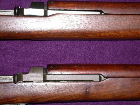

    Welcome to our forum usmc-nav. That's a great looking stock! I'd love to have it.
    Just in case you're not familiar with the term 'High wood' and 'low wood' I posted a comparison. The High wood is at the top. Earlier stocks had high wood but that area often broke so they started making the low wood version. Many stocks that were originally high wood were modified to low wood configuration at rebuilds. You can often tell if a high wood had been modified to low wood if you look closely at that area.

    Harlan is right about the rail being a weak spot that often cracked or broke.
    The thought was that the highwood would help keep dirt out of the slide area.
    Problem was that the right rail needed to be thinner to accommidate the dimension of the slide, thus making it more prone to cracking/splitting etc.
    Turned out that the highwood made no differance in keeping dirt and debris out of the slide area so the modification to all low wood was inacted on in service stocks, and all new production were made as low wood.
    You can look at the milling marks from the top of the right rail and tell if it was an original or modified low wood. Some modifications are very well done and some are pretty crude. HTH.....Frank
