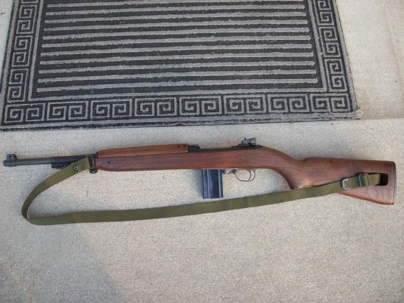

    Guts of Dad's inland... pic heavy
    What time frame is a 269,XXX Inland?

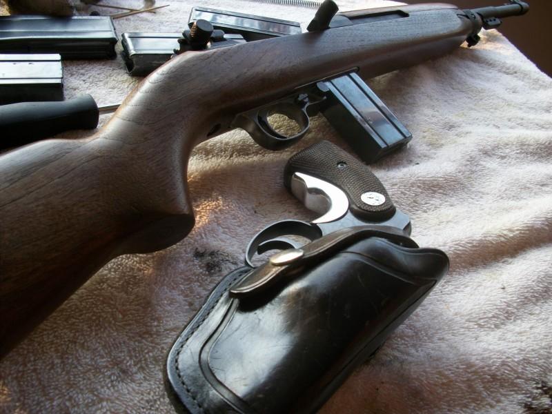

    Here's pics:

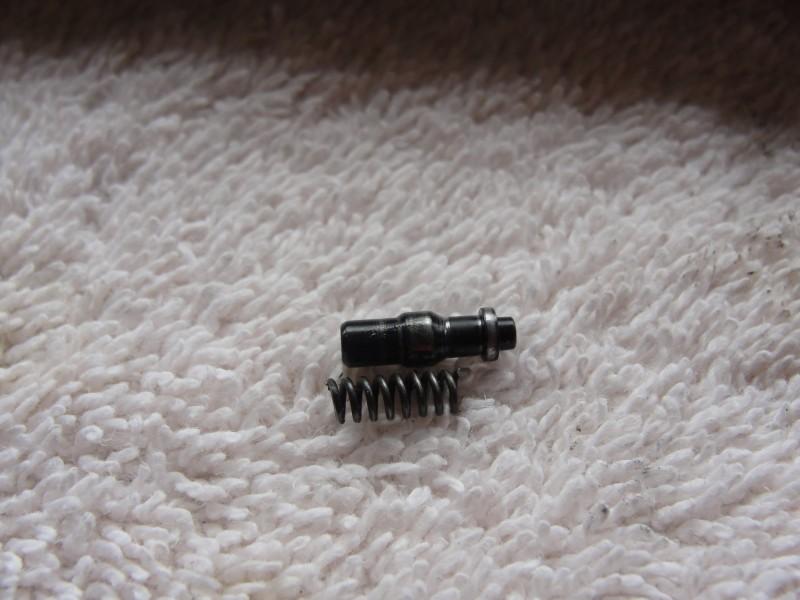

    I didn't take the trigger group all the way down. I did that when we first got it and I don't feel like doing it again. It doesn't need it.

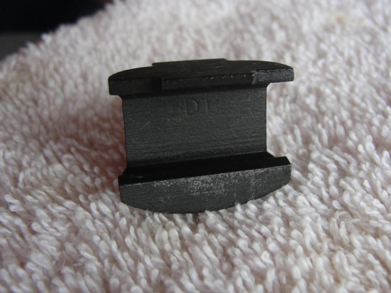

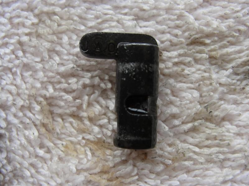

    were these made by Union Switch and Signal? It has that circle with two "SS"es. The one I have to replace it with has the same thing. But not as worn.

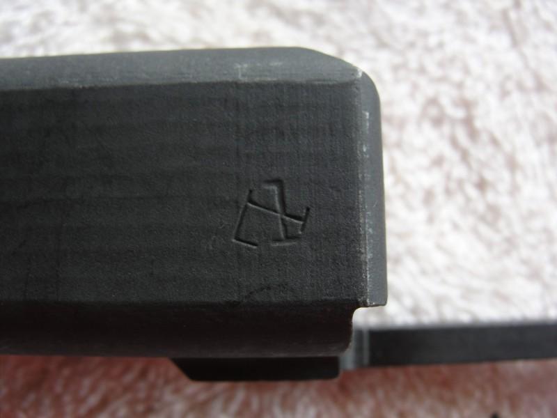

    There's just an M on there. And no leg for the 30 rounders.
    That's the only marking on the recoil plate. Nothing on top.

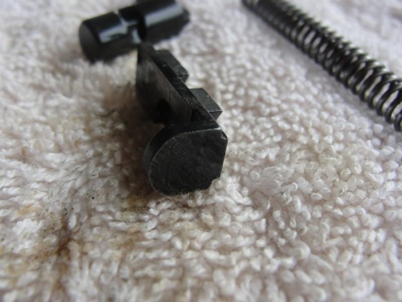

    see, flattened threads

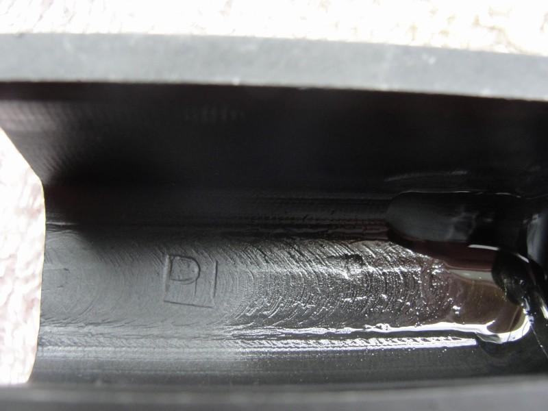

    tool marks
    are these tool marks or some kind of stamp?

    About March 1943 for your serial number. Quite a few later Inland parts and a type 3 Underwood trigger housing. Safety is not US&S but a late war/post war replacement. During rebuilding the type 4 magazine catch for the 30 rounds were reserved at first for the M2 carbines while the type 3 like yours were used on standard M1icon's.

    That's real nice carbine. You want the trigger housing to be snug in the receiver - no wiggling. This is done by peening the lugs on the housing, not the receiver. The rear sight in in it's original finish, which means it hasn't been refinished since the original overhaul. You don't find too many of them today that still have the white paint in the markings. I bet it's a good shooter.

    Thank you. The trigger group is pretty darn tight. I will say it moves a micro bit. How much, I don't know but WAAAAY less than my carbine. Mine sloshes around like... like... a 1/4 nut on a 1/8" bolt I guess.

    Well, my Dad's Inland is all back together and begging to be shot. I put the new Orion7 op slide spring in. It measured 10-5/16" and man does the action feels a lot different. I'm hoping it helps with digesting ammo properly. And a HUGE thank you to imarangemaster for the new recoil plate screw. It wasn't the escutcheon. It screwed in beautifully. In fact, when I screwed it in, the barrel raised up a bit over the channel in the stock. Which I think is a good thing. Meaning it's nice and snug in there.
    Can't wait to see if she will run good now.
