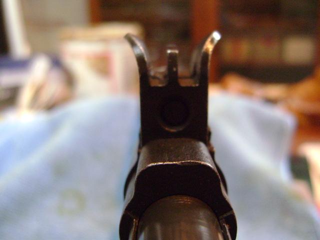

    Just picked up a IHC Garandicon that appears to be all correct down to the smallest part but I am not sure how to identify the gas cylinder. Anyone know for sure?

    show a picture the bayo lug (bottom View) - compare to a known springfield Gas cylinder
    there are several points of difference

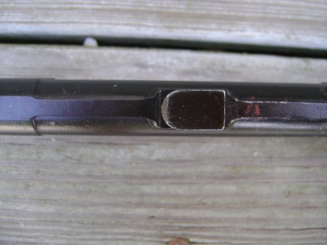

    https://www.milsurps.com/images/impo...9/gas007-1.jpg
    https://www.milsurps.com/images/impo...9e9f21b6-1.jpgWayne Bradford
    https://www.milsurps.com/images/impo...9ae4e052-1.jpgWayne Bradford
    International Harvester Gas Cylinder Identification - CMP Forums
    On mine the screw has rings (very light doesnt show well in pic) screw is also staked as the one in picture. Does not have footbal shape on bayo lug but that alone does not make it IHC. There were two styles of IHC Cylinders . I just dont know what else to look for
    Everything else on the rifle is correct down to the smallest part. I would guess the cylinder is to but wanted confirmation

    I took my IHC out to check the description addressed above. Mine was a private purchase at an estate sale. It has the football shape on the bayonet lug, concentric circle and straight slots on the stacking swivel and ferrule swivel screws. The stacking swivel is staked as in the picture above and ferrule screw is almost flat with a very very shallow centered crater staking. As far as I can tell it is a correct IHC but will wait for Wayne's book to come out to verify.

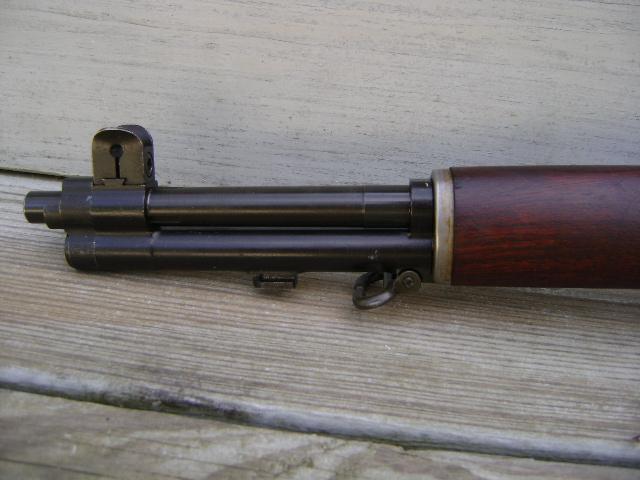

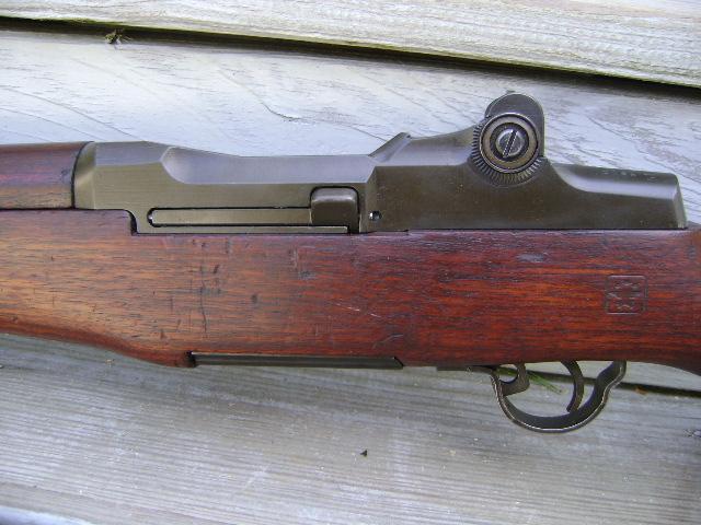

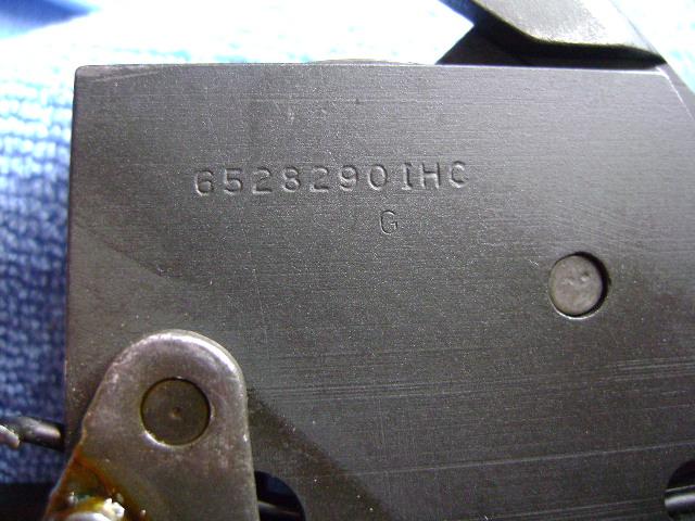

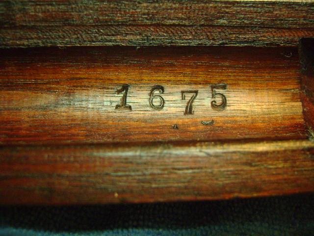

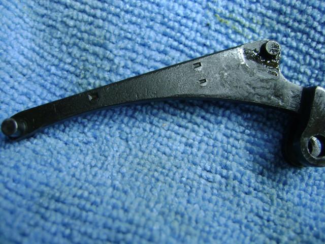

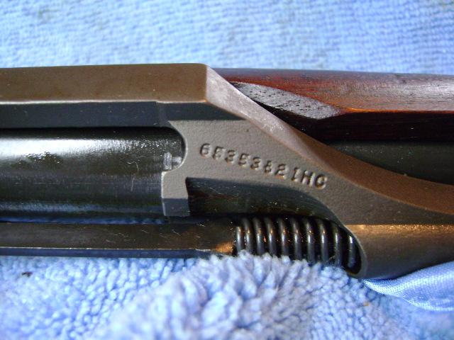

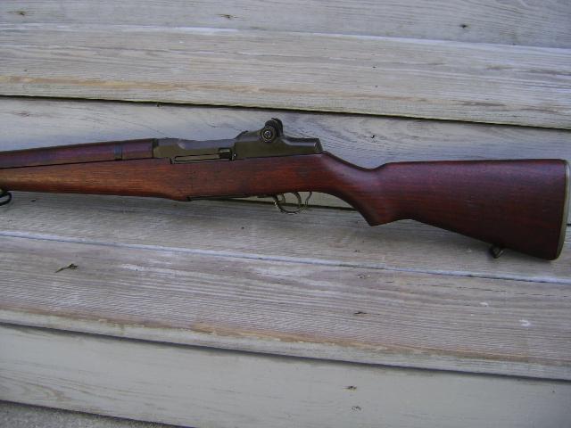

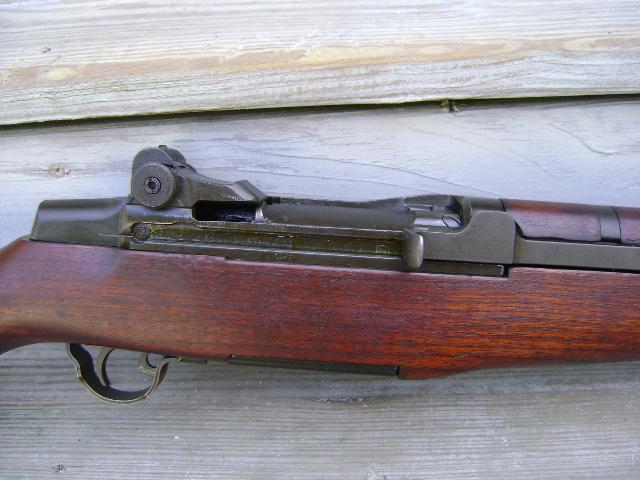

    Heres pics of the whole rifle if intrested
    MW just under 1 TW just under 2
    Jury is still out on the gas cylinder

    Excellent photo expose', and good looking rifle from one part to the next.
  13. #10
    12-11-2024 @ 03:06 PM
    2,265
    Bob Seijas
    03:48 AM
    Looks right as rain to me... beautiful.
