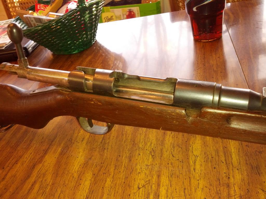

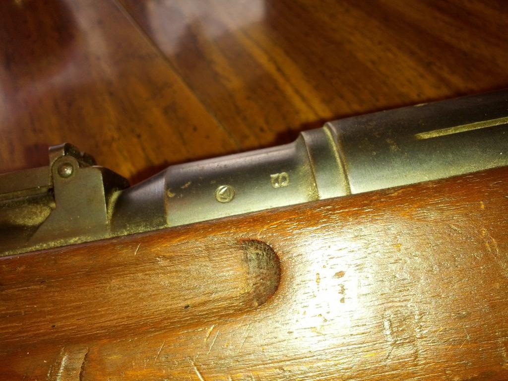

    When did the Kokura arsenal quit making the TYPE 38? I DON'T SEE a series in front of the serial number. Here are a few photos of it.

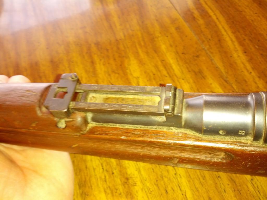

    I haven't pulled out other Type 38's for comparison, but here are a few MORE markings to view.

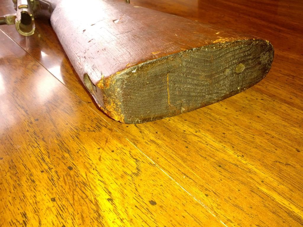

    Yes, the buttplate has gone missing! Probably an easy replacement, but something that is bothersome!

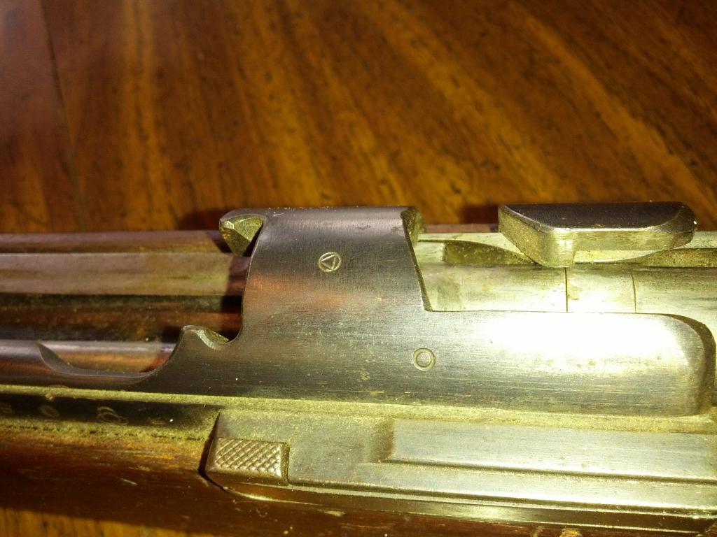

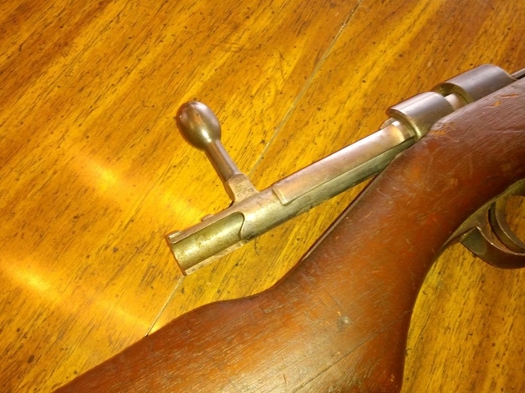

    And yes, the safety and firing pin have also gone missing. The bolt body does NOT match the rifle SN, so this backs up some of the stories of vets having the bolts removed before they came back home... or not...

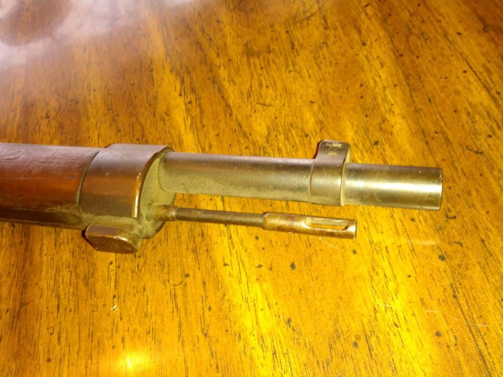

    And yes, it has an original cleaning rod! The front sight looks short, but it is just the angle of the shot, not bubba!

    The rifle does need to be taken down for a cleaning. This is the "as found" condition.... Upon close examination, the numbers don't match. Even though it might be a "put together" rifle, by all appearances with the patina, is has been together for quite some time.

    That rifle was made at the Koishikawa (Tokyo) Arsenal not Kokura and they didn't have a series marking. Kokura used the same symbol but didn't come about till around 1933. I can't find my blasted notes or I'd tell you about what year it was made. I have a Kokura series 23 that was made about 1935 if I did the math right. I believe Kokura made guns up to the surrender but could be wrong. If I could just find those darned notes......phooey. Somebody'll be along shortly and give you the straight of it.

    Here is a link to the re-hosted page for Japaneseicon rifle markings, it might prove helpful.
    http://oldmilitarymarkings.com/japanese_markings.html

    I suppose any T38 safety knob could be used, but sometimes it will not engage on the receiver. Seems like the safety needed hand fitting for it work correctly.

    Large protrusion safety knob is appropriate for non-series rifles of Koishikawa.
