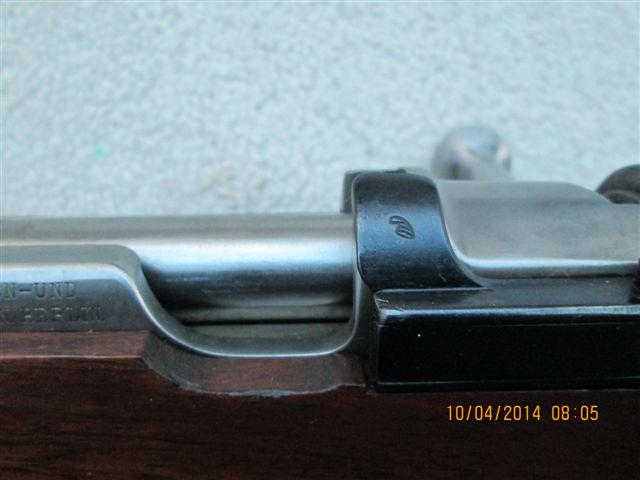

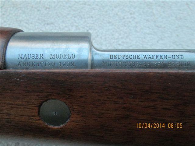

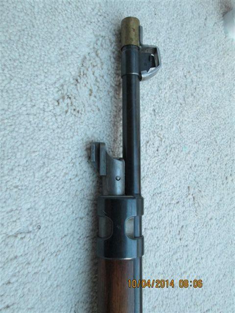

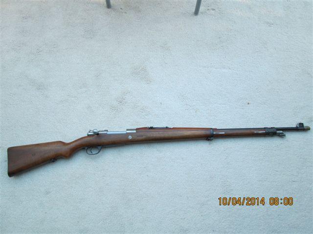

    I also prefer the Swedishicon rifles and 6.5x55mm cartridge as well, but I also own a number of 7.65x53mm rifles (both M1891 & M1909 Argentine and Peruvianicon) and find my M1909 Argentine (as with the other 7.65 rifles) shoot just fine and with respectable accuracy with Prvi 174gr. FMJBT 7.65x53mm ammo!
    Here are pictures of the M1891 barrel throat dimensions, Prvi 174 FMJBT ammo, and the old long original 7.65x53mm 210.7 gr FMJRN ammo -
    Attachment 57758Attachment 57759Attachment 57760

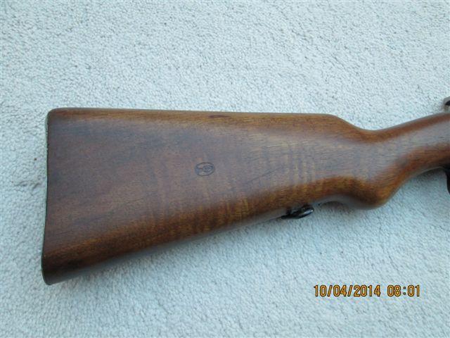

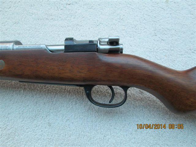

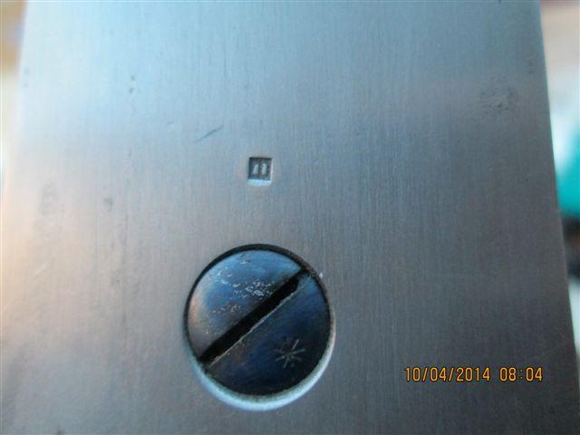

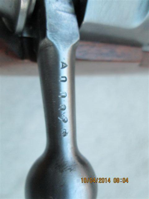

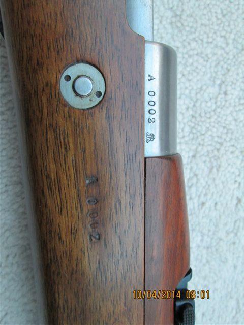

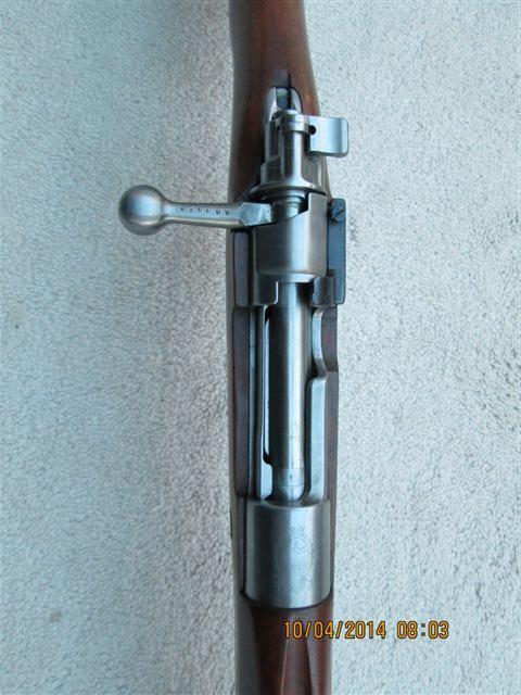

    Here are some pictures of a very nice 7.65x53mm Argentine M1909 -
