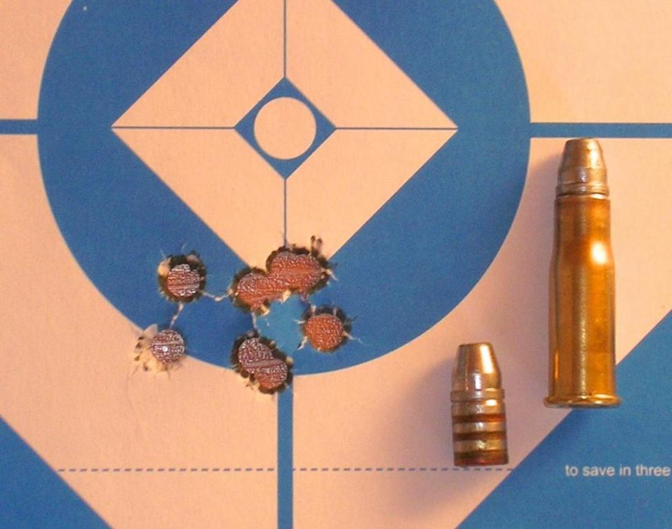

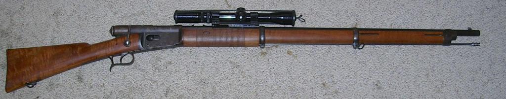

    Finally found a mint centerfire one, epoxied on a 2-7 (USAicon) Burris, blew $100 on the custom case maker (still don't have them in six weeks), made my own (nice to own lots of dies). Loaded with 15gr 4227 and coarse Cuban corn meal as filler and a 320 gr .430 gas check, off to the range. Results were excellent @50 yards and I'm sure 44 Magnum heavy bullet ballistics will be easy to meet when I set up the Chrony. Will probably go Antelope hunting next year.
    Moved out to 100 yesterday and after compensating for 8" drop, shot 8 into 2.5 x 3.5" with six in 1.5".
    First 50 yard group
