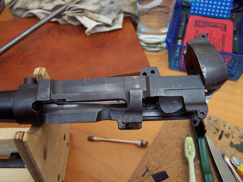

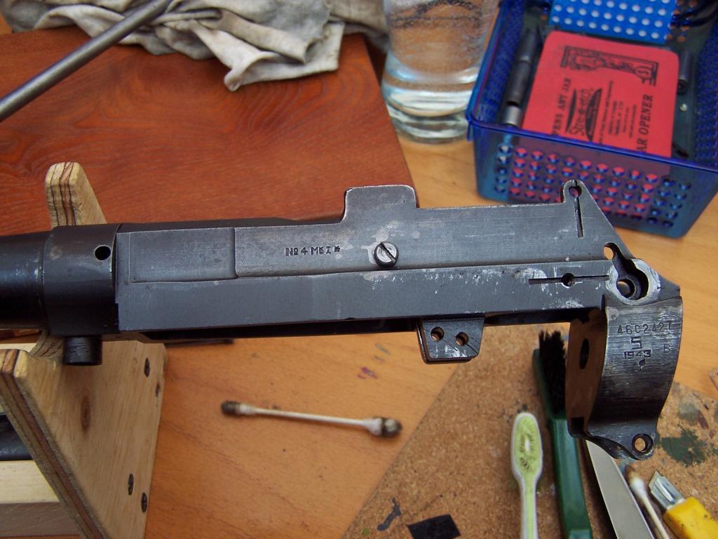

    I am currently working on restoring a 1943 Savage No4mk1* - it is a barreled action that I will be putting New NOS wood onto. My concern is that once i put NOS hardware and furniture on the rifle, it might look a little strange with the receiver looking quite worn. Also the hardware i got does not match the grey parkerized receiver...just nitpicks but leads me to my main question:
    I have heard that units in the second world war would apply "blackening" to rifles. From what I have heard this is not a factory applied finish, but something that goes over it. I have no idea what this finish is, whether it is blueing, paint (suncorite?), or some other process. I figure this might be my way of getting a rifle with metal that looks good and colour matching while still being historically accurate.
    Would anybody know what this "blackening" process was?
    thanks!

    You're talking about Suncorite paint, which was applied over bluing.

    Savage rifles were never Parkerized, (phosphated), at the factory. The receiver bodies were sandblasted and all the metal parts were blued using the Dulite process, much the same as at the S.A.L. Long Branch factory except the Canadians didn't sandblast the receiver bodies. The sand blasted surface gives a Parkerized look but it's just bluing and no where near as durable as Parkerizing. Long Branch switched to Parkerizing at some point in 1950 in the 93LXXXX serial number range. All of their factory weapons were Parkerized from then on including wartime rifles that went through rebuild/FTR. You'll still see a mix of blued and Parkerized barrel bands and other small parts throughout production as they used the parts on hand during assembly. The MoD started phosphating, painting with Suncorite 259 and baking in 1944. The Sten Mk.5 SMG was the first weapon to be produced new at the factory with the new rustproof finish if memory serves and it became the standard finish on Britishicon weapons up until it was finally declared obsolete 4-5 years ago. Quite a service life! It's the ultimate rustproof finish and tough as nails.

    I think that if it was mine I would just leave the metalwork as it is and just replace the wood
    Feel as though the worn metal work isn't going to match my NOS stock set and hardware (which is black, not sure the finish) My goal with the project is to restore the rifle as it would have looked going into WW2 when it would have seen battle.
    Quote Originally Posted by Brian Dick View Post
    Good to know - would you by any chance know when in 1944 this practice was adpoted? Would rifles used in normandy have been finished with suncorite? I guess given this date rifles in the Italianicon campaign would not have been finished this way?
    So the question remains since suncorite is toxic and hard to get, what modern alternative should I use? Ive heard of BBQ paint, the Brownells spray, car paint, etc. Any input on which offers the best protection while still not requiring too much special equipment to apply?
