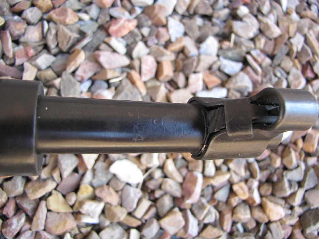

    USMC M1903A1 Sniper
    Here are some pictures of my SA M1903A1 Sniper w/Unertl telescopic sight. The rifle, serial no. 1496359, barrel date "3-37", is a standard late production SA M1903A1 NM w/USMC modifications. The stock has the standard "SA/SPG" final inspection mark and encircled "P" proof mark. The barrel has the star-gauge mark on the muzzle and star-gauge number on the barrel. The bolt and stock are both marked with the rifle serial number. The trigger guard has the typical USMC modifications and the underside of the barrel has the fixture mark. The bolt has the distinctive blue found on USMC Sniper rifles. The scope mounts ARE NOT soddered to the barrel or receiver and the mount screws are NOT staked. I have owned this rifle since 1986 - it originally was purchased from a retired Marine colonel in San Diego. This appears to be a late production USMC M1903A1 NM rifle that was modified by the Marines to sniper configuration c. 1943.

    Extremely nice rifle! My envies for this wonderful piece which seems to be impossible to upgrade! I especially love that the NM polishing around the rear locking lug is still visible under the USMC plum blueing!
    I assume this is still the rifles original barrel, and therefore it has no vise marks below the woodline? Is the area around the rear sight base inletted additionally? And did you ever remove the scope bases and check if there are any file markings? And are the trigger guard screws staked?
    Did you get the scope can with this rifle? I've never seen one like these, only the Micarta green cans, and with some very early ones the metal version of the Micarta can.

    "I assume this is still the rifles original barrel, and therefore it has no vise marks below the woodline? Is the area around the rear sight base inletted additionally? And did you ever remove the scope bases and check if there are any file markings? And are the trigger guard screws staked?"
    Question I would think the barrel would have to be removed to D&T the receiver I don`t think one could properly drill the receiver with the barrel installed . Vice marks should be present even on the original barrel . Marks for on & off even if the original barrel was retained .opinion
    Also after inletting the sight base was signs of asphaltum present on the bottom of the sight collar . Was the wood relieved where the trigger guard meets the wood at the rear guard screw

    They didn't remove the barrel however they drilled and tappped them. I know of maybe six or seven with their original barrels, mostly in this 1.49 range. None had vice marks. But I know of about an equal number with replacement barrels, with vise marks. All have been the same early dated 1938 barrels.
    On the asphaltum comment I've never heard of that one. I would be curious to hear more about that.
