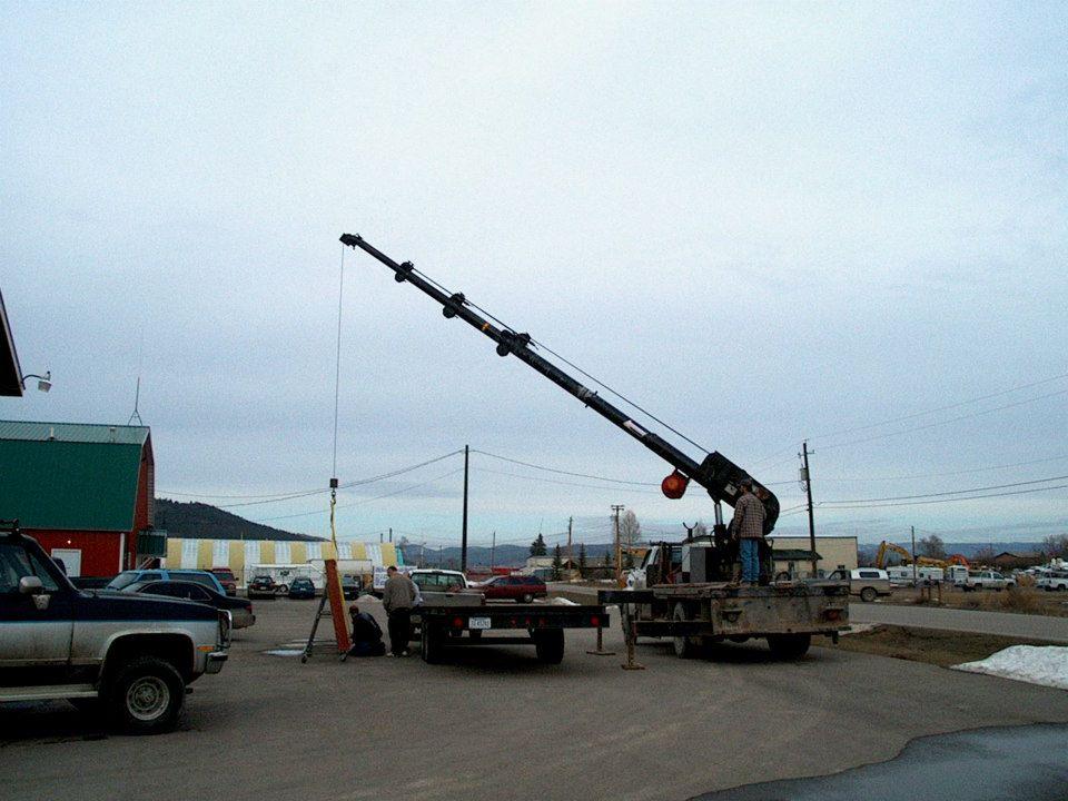

    Below is the last mural I carved. It took nearly a year and was the final nail in the coffin for my carving. It's 18' long and 5' tall by 6" thick. It hangs in Glacier Park International Airport here in Montana. I still have my Swiss firearms business. Swiss Products | swissproductsusa | Kalispell Montana
    The last carving I'll ever have done.
