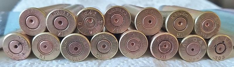

    Oh, and for those of you who are like me and love headstamps........
    1 – Royal Ordnance Factory, Radway Green, Cheshire. 1943. Armour piercing
    2 – Kynoch (I.C.I.), Standish, UK. 1941. Mk VII
    3 – Defence Industries Ltd., Canadian Industries Ltd, Park Avenue Plant, Montreal, Canadaicon. 1942. Mk VII. Nitrocellulose fill
    4 – Greenwood & Batley Ltd, UK. 1943. Mk VII
    5 – Royal Laboratory, Woolwich, Englandicon. 1936. Armour piercing Mk 1
    6 – Kynoch, (I.C.I.), Birmingham, England. 1940. Mk VII
    7 – Small Arms Ammunition Factory No. 1 Footscray, Australiaicon. 1939. Mk VII
    8 – Kynoch, (I.C.I.), Birmingham, England. 1943. Tracer Mk II
    9 – Crompton Parkinson Co. Ltd, Doncaster, Yorkshire, U.K. (C-P). 1942. Armour piercing Mk 1
    10 – Crompton Parkinson Co. Ltd, Guiseley, Yorkshire, U.K.(CP). 1942. Mk VII
    11 – Kynoch (I.C.I.), Standish, UK. 1942. Mk VII
    12 – Royal Ordnance Factory, Radway Green, Cheshire. 1942. Mk VII
    13 – Kynoch, I.C.I., Kidderminster, Worcs.1942. Mk VII
    14 – Dominion Arsenal, Québec, Canada. 1940. Mk VII
    15 – Winchester Repeating Arms Co., Bridgeport, CT, USAicon. 1943. 303
  5. The Following 7 Members Say Thank You to RRPG For This Useful Post:

    Interesting that No.15 also looks to be a ‘small primer’ case, but isn’t ‘Z’ marked like No.3 is, assuming both are single hole boxer primer cases, especially both being made in North America. Although so is No.14 but that is a ‘large’ primer case as well, so assume all the large primer cases are two hole Berdan primer cases for cordite?

    Post #2. Note the many off centre firing pin marks on the primers. I found my No 1 Mk 3* was like that and never had the slightest problem in shooting.
