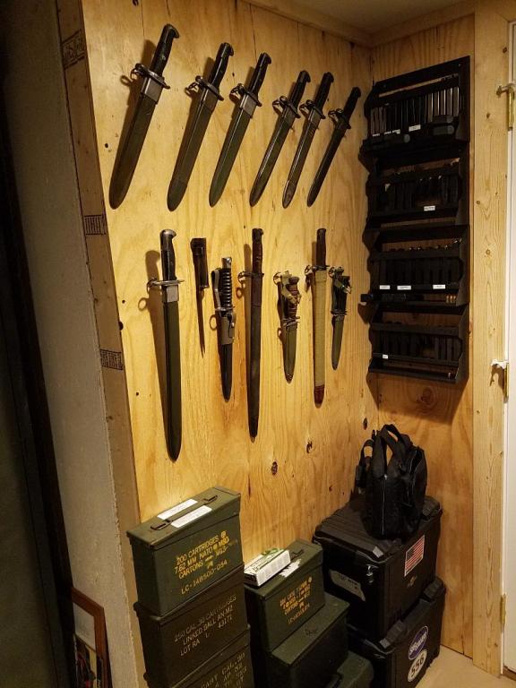

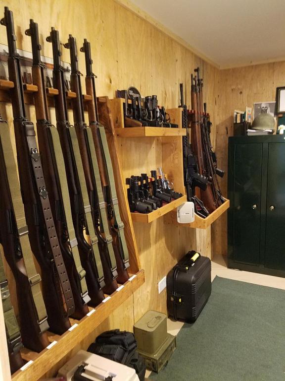

    Mine is/was very similar. When I finished the basement a few years ago I included a 11'x6' secure storage. We had a new home built and moved in a few weeks ago, I have the building permit ready to drop off and the new secure storage will be 3 times the square footage, we moved from a 2 story to a ranch as we are getting on in age.
    Pointy things on the opposite wall

    Quote Originally Posted by Sarge1998 View Post
    OOOOH... That is a really nice room. I may have to up my game here in the future. We built a one story also, for the same reason as yours.
    We have two large bedroom walk-in closets, so I may be taking one over to build something similar. I've got multiple gun safes already, but I just keep running out of space. C&Rs can be an addictive hobby, and I've got a few more coming this week.

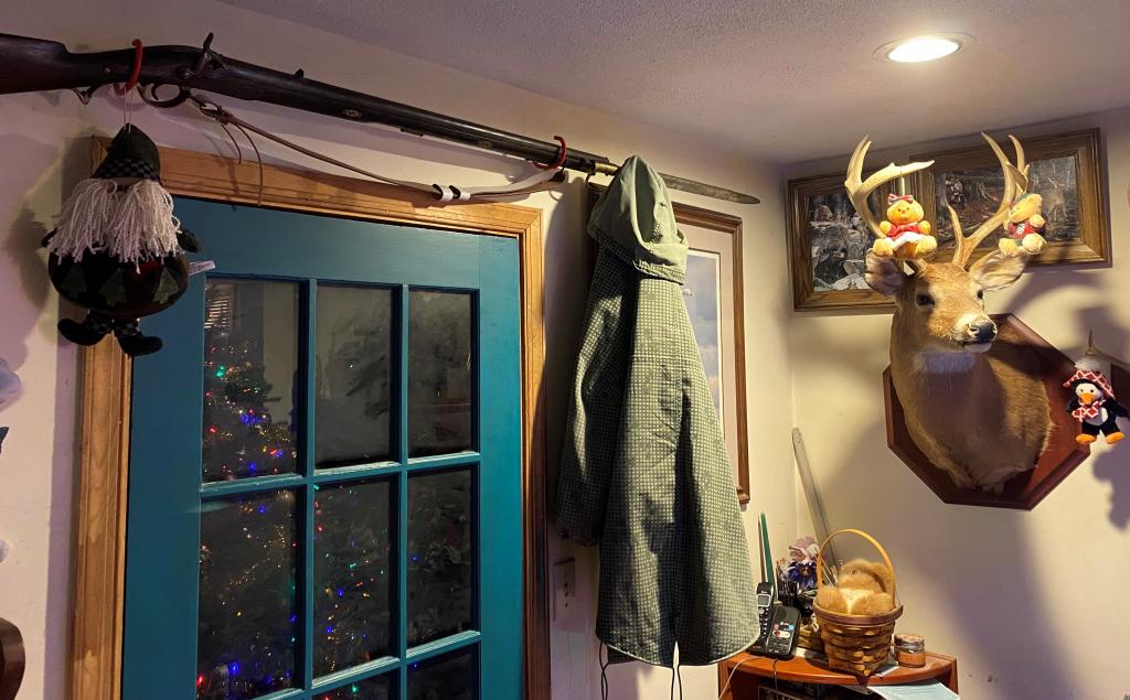

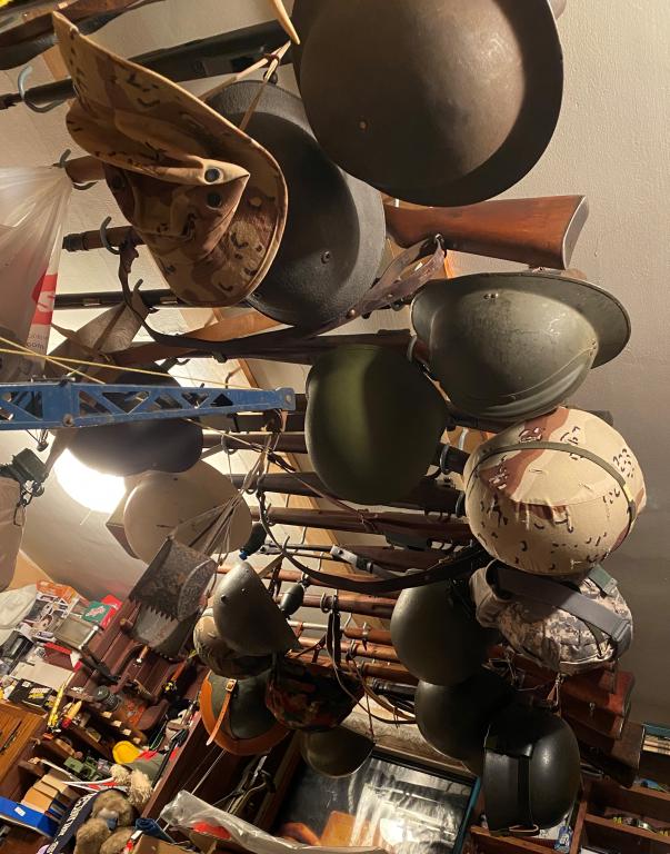

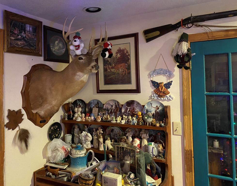

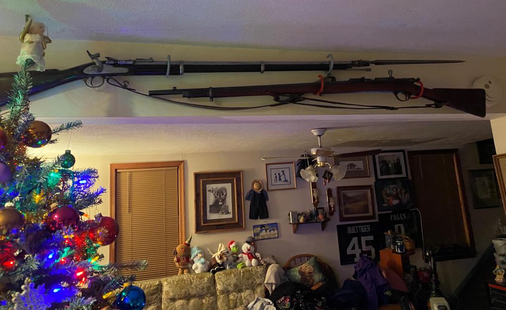

    My storage is varied but I more or less gave up on vertical racks a long time ago. Both gun cabinets have been converted to shelf display cabinets. I still have one remaining vertical rack in what used to be a window opening. My remaining non-safe, non-hidden case storage is on bicycle hooks on the ceiling. My walls are taken up by either pictures, deer antlers, football jerseys or bookshelves. I do have a large 14 gun cabinet area that is currently stuffed full of other collectibles.
    Advantage of the bicycle hooks is they are out of the way, don't take up any wall space, can be easily accessed and I can hang all sort of other things off of them. Each rifle also has at least one, possibly two helmets hanging off them.
    They have also slowly been sneaking into the wife's domain of the living room. There are now three hanging on the walls above openings and two sets of deer antlers mysteriously moved down beside the actual mounted deer in the past couple of weeks.
    I'm following the frog in the pot of cool water on the stove theory. Temperature is rising very slowly. She did notice the deer antlers and objected to the first set but that was going there no matter what, it was the most recent set from this year which I think I posted somewhere here. The second set took her three days to notice but it was the very first buck I shot when I was 12 so she couldn't object to that, I was a mere child. Besides, gives her more places to hang Christmas ornaments.
