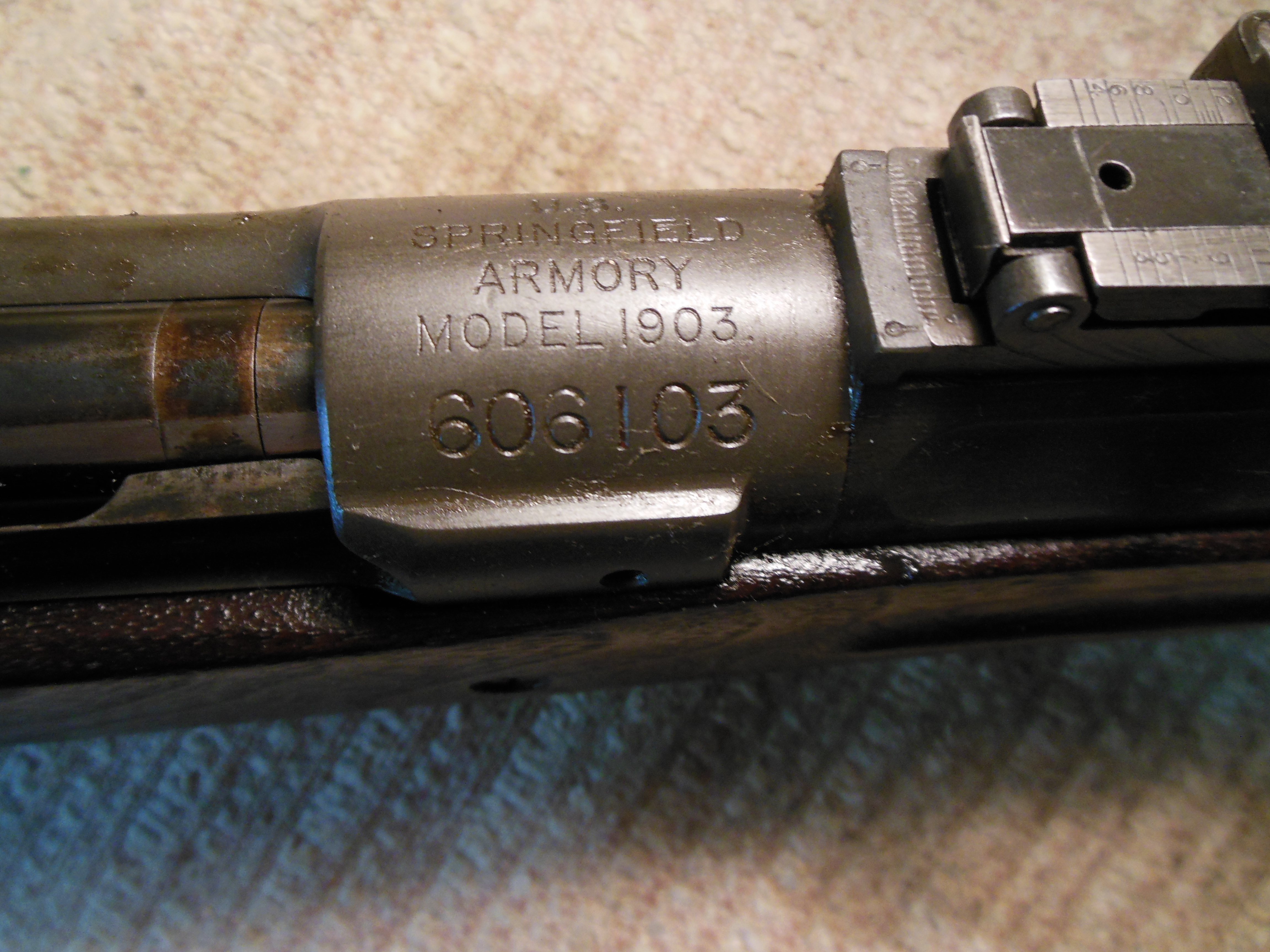

    Possible to check another serial number ?
    It has been awhile since I have submitted this SA serial number 606103 for a check. Barrel is Rock Island RIA 5-18 (exc bore) receiver without Hatcher hole. Bolt is straight handle small s marked. I did install the rear USMC rear sight leaf
    Thanks for any help RCS

    RCS, no direct hit on your rifle either, though the 600k range has quite a few Marine rifles. Here are the closest:
    606386 082538USMC - SAN DIEGO (SURVEY)
    606434 100426USMC - PHILA NSY (SURVEYED)
    606641 011542USMC - SAN DIEGO
