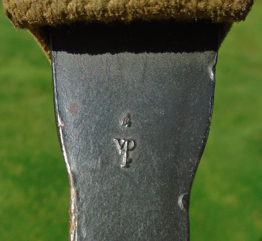

    Hi Daan, I actually already secured an action cover. I am told this is one made by (or atleast contracted by) Savage. Here is the pic off the ebay listing from when I bought it:
    I have heard you can find this marking on other canvas goods, but I haven't really found many photos of other similarly marked gear.

    Well done. So a Savage sling might not be that impossible.

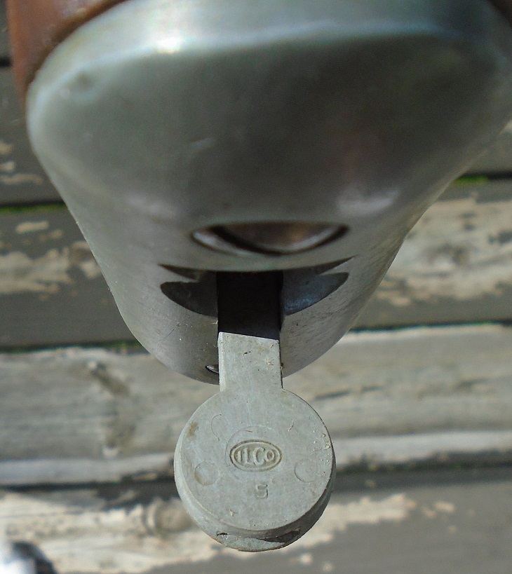

    You could look for a junkmetal buttplate marked "ILCO" which I think is Illinois Lock Company. A Victory Plastics (New Hampshire) scabbard/frog combo would be nice. Don't know about the sling.

    Thanks for the excellent close up there on the buttplate, Steve! Now I have a lead. That's a very cool scabbard and frog; currently my bayonet is riding around in a very nice but un-maker-marked stamped scabbard with the usual metal button for the frog. Yours is a totally different configuration and very interesting. Something else for me to keep an eye out for.
