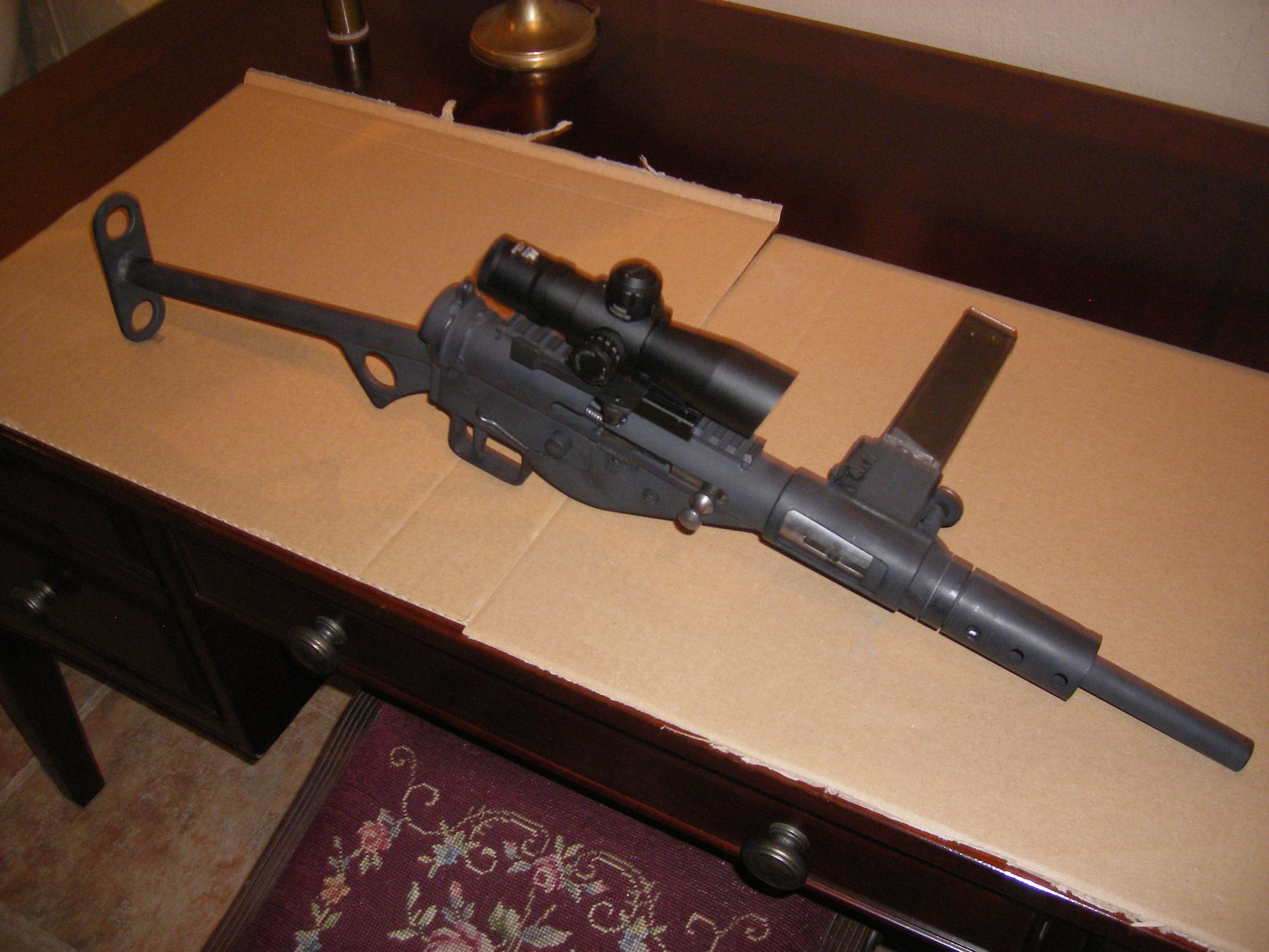

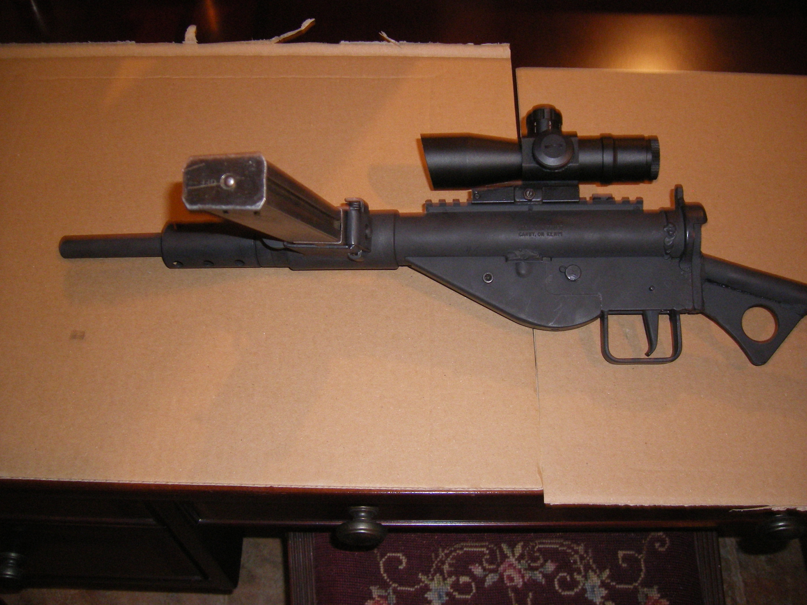

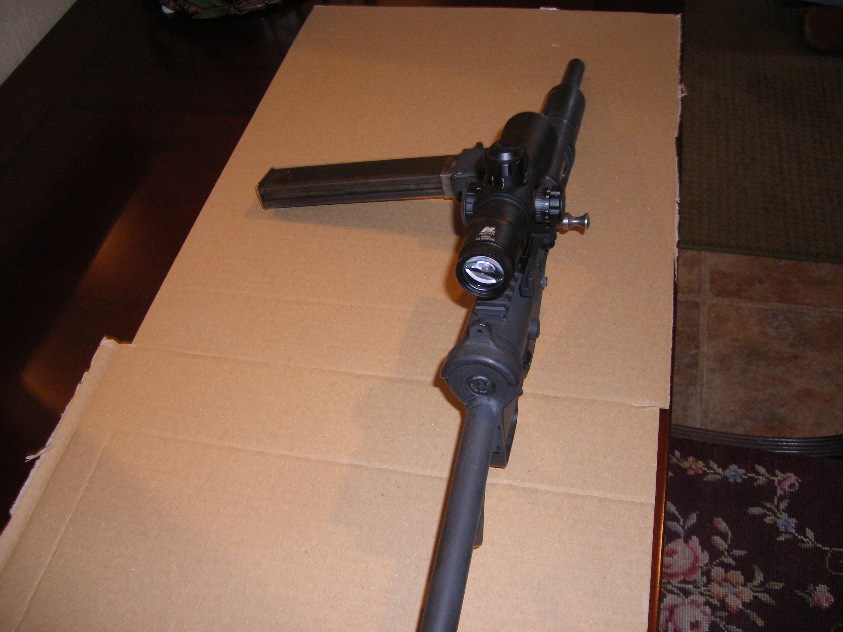

    Just the other week I finished a semi-auto SBR for a friend. The Sten is agriculturally simple and an excellent example of efficiency on a budget. It's magazines sort of stink, but it works.
