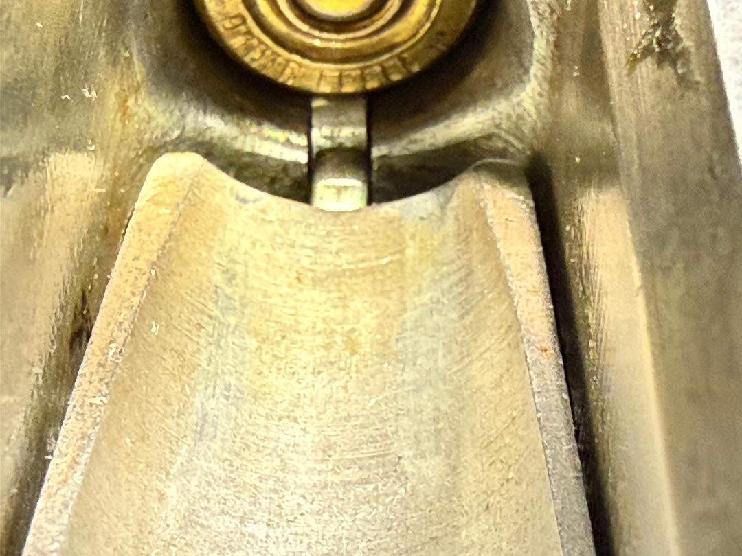

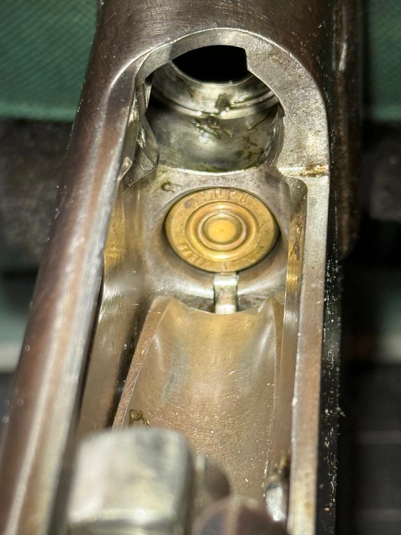

    Good Afternoon All,
    Back from the range and the Lebel became an issue when using the tube magazine. It looks like the cartridges are feeding onto the floorplate fine but are getting knocked around by the next round and the bullets were pushed back into the case. Not sure if the next round had popped out of sequence but I am suspecting so. Rifle fires great in single-shot.
    I am expecting that the issue is the little protrusion that should be holding the next cartridge in the tube. Please see below:
    If needed, I would like to replace this part or find a smith who has made a fix.
    Thanks,
    Randy

    First of all. I'd be a bit concerned by the lack of neck tension on the loads. That aside, I assume the cartridge stop (protrusion) holds the rounds in the tube while loading? I am assuming the last pic is showing a double feed type situation. Will a round in the tube pop free onto the lifter if you pry it up a little?

    Good Evening,
    Yes, the neck tension on my Lee Die set is off. I am using .327 bullets and Lee states their dies are for .323.
    If I pry on the cartridge it does stay in place. However, every time I try to load a round, I get this double feed situation. I do note that the cartridge stop extension does not sit on the bottom of the case. It is somewhere on the rounded edge of the case. I would say it is approximately half-way up the rim.
    Thanks,
    Randy

    Follow Up Images
    Is this correct?

    Kinda hard to tell from a pic like this, but it appears pretty close. If you can get a pick in at the bottom of the case rim, pry up,wiggle a bit and it doesn't release, the cartridge stop is most likely working ok for that function.
    I don't think it's cartridge length, Aragorn. I can run empties easily through my Kropatschek, which has the same set up. I'm guessing either the stop tip is a hair too short, or the reset trip for it is getting retarded. A bent mag tube causing excessive mag spring pressure wouldn't help either. Just my two cents.
