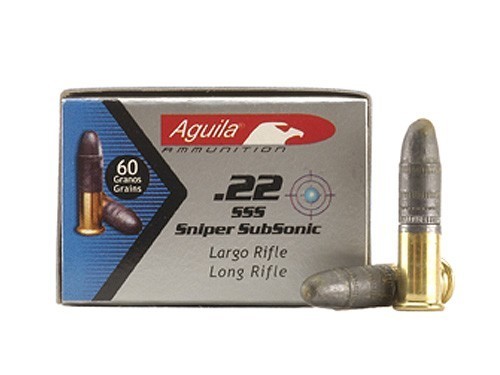

    Yep, sounds like their 60g .22 subsonic round. Very quiet.
    Carteach0: Aguila .22 Sniper Subsonic 60 grain solid

    Quote Originally Posted by A. F Medic View Post
    When I was at the rifle range, I noticed an unfired .22 cartridge. It's case looked like a .22 long but had a bullet larger then the case! My gunsmith said it is a subsonic round (quiet) made by Aquila. There is an A on the botom of the round.
    Click here.
