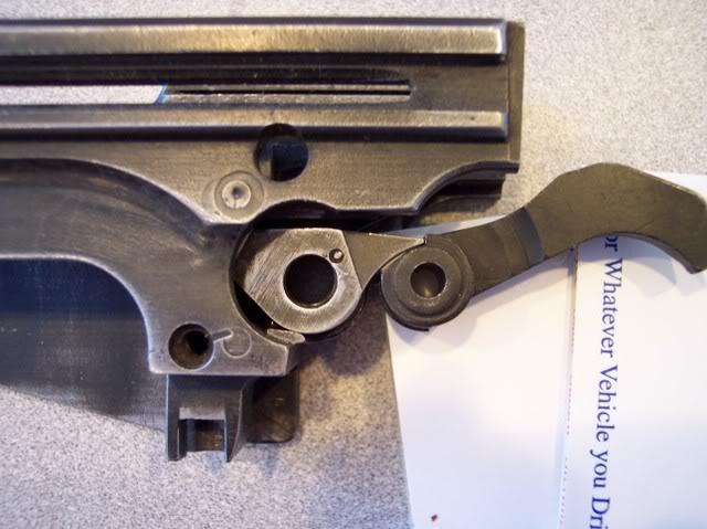

    One of the primary causes of a Garandicon slam fire is failure to inspect the firing pin leg and the safety notch in the belly band that runs under the rear of the bolt when in battery, most often it is not a soft or high primer. Years ago I had a Garand come into the shop that would at random slam fire. I installed a new firing pin as the original had a very badly worn leg. The safety notch was also worn. I sent a paper photo to Clint Fowler for his opinion to see if it need to be re-welded and the receiver then re-tempered. He seconded my opinion that the notch was still serviceable. The new firing pin solved the problem. Special primers are not needed just inspect your firing pin leg and keep a new spare handy.
    THIS IS GOOD INFO HERE, but sloppy primer seating will cause a slam fire

    I had a slam fire in a M1. feel free to disreguard this post because few shooters have first hand knowledge, and even fewer have had one. It only happens to others so why worry, except if you are using federal match (very accrate) primers in a gas gun, You are playing russian roulette. My slam fire was in the mid 1980's. It was with a Federal match primer. I got very involved in this and found 17 cases of M1 slam fires with one common factor, ALL WERE WITH FEDERAL MATCH PRIMERS.

    Mine was once more than nine years ago and it rattled my faith in the old girl for sure - I mean it's a GARAND!
    It was the first round of a full clip and the rifle closed all the way (as far as I could tell) so the only damage was to my trust in things. The round went downrange safely - even hit my target backer although I hadn't set into aiming the shot. It fed the next round just fine which was also Federal primed and didn't fire that one. I unloaded the rifle.
    I set that rifle aside for the day as I wasn't sure what had happened. Another shooter asked me about the primer used and told me for the first time I'd heard it that Federal primers were too sensitive to use in semi-auto rifles. I didn't know any better and still am not sure of it but I've never had one slamfire using Winchester or CCI priming. I know that one incident isn't enough to substantiate a blanket condemnation but seeing you say it struck home for me.
    There didn't seem to be anything wrong with the rifle and that's been proved out over a couple thousand rounds since, so I've taken it on faith and not used a Federal primer in any of my Garand rifles since.
    It's a Springfield Armory, 1-55 date barrel but it isn't original to the receiver, though it came from CMPicon on another receiver that I converted to 7.62. It measures like a new one and has three "P" stamps, one "T" stamp, the small "m" and "A217B" on it. A couple of people have thought that it was a barrel designated for NM use, but I don't know any of that. It IS a good shooting barrel though.
    I only know that nothing about the barrel or the receiver (so far as I can tell)contributed to that slamfire episode. To play it safe I took a little cut to take the headspace out to just short of my "No-Go" gauge because it had felt a little resistant closing on my 'Go' gauge and I thought maybe that could have brought the slamfire. It was probably just my worrying.
    I use an old set of RCBS dies, hand prime with a Lee Auto-prime (or whatever it's called) to be sure of my primer set. The round was good but it had Federal No.210 priming and not being able to find another reason for that slamfire I switched to Winchester primers for the rest of my loading for the caliber.

    In every case where it was conclusively a slam-fire, the rifle was busted! Generally with a worn firing pin, worn bolt, or (in the case of SA cast-receivered rifles) a mis-location of the firing pin retractor bridge. Remember gang....identifying a worn firing pin isn't a "Mk.I Eyeball" job! If the firing pin extension is worn by only a few thou, your slam-fire risk has risen exponentially.
    The other cause, as was well-documented in an American Rifleman article I read probably 25-30 years ago, are primer seating defects...a high primer, regardless of who makes it, is a slam-fire risk! The author of the article discovered that little factoid the hard way, and researched and wrote the article as a result. His well-researched article should have put the "soft-primer" myth to bed for good....the data was that compelling, but obviously not.

    Mr Faatz had a slamfire in a Garand. What Mr. Faatz did show is that you can ignite a high primer in a Garand, but it took him a lot of time and jiggling to do so. And he added to our knowledge and hats off to him.
    If you recall from his article, the first thing on his list of slamfire contributors is sensitive primers. A subset under sensitive primers is high primers.
    His list was
    1. Sensitive Primer (included under this category is a high primer)
    2. Minimum headspace chamber and inadequate case sizing (leading to the firing pin hitting the primer with excessive force)
    3. Hammer following the bolt
    4. Fouled bolt face
    He could have added busted firing pin.
