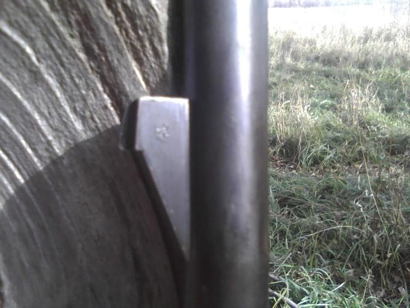

    Thanks Fred, interesting. My rifle with the * on the sight shoots dead center with the MKVII ammo. It has no provsion for the cleaning rod so it was upgraded. My other all matching one with the blade offset to the left, shoots 3-4" right of center. It looks like if that blade was moved to the center like the one with the star, it would shoot more center also with the MKVII ammo. That sight has no * so I'm assuming it was not modified and was still sighted in for the heavier slower bullet? Ray

    Ray, what is the year of manufacture of the Mk I* rifle whose front sight has the * ? If it has no provision for the rod and has a solid stock and was made after May of 1899, then it has no upgrades. It was made like it is at the armory. The rifle was suitable for the ammo that they were using at the time of the rifle's manufacture. The other rifle was never upgraded and was probably not used with the later ammo. I wonder if my Mk I* would shoot accurately with Mk VII ammo too? It being made in 1900 was also made without any provision for a rod and the sights are accordingly suited for the later ammo. The star on its front sight base is not an * but is actually a six pointed star.

    Fred, the rifle with the starred sight is dated 1896 but has been upgraded. If the front blade on your rifle is centered, it probably should shoot center.
    Apparently the blades on the front sights were originally offset to the left to compensate/allow for bullet drift to the left. I assume that's why the blade on my un-modified on is set to the left which in turn makes you shoot more right at close distance but the bullet would drift closer to center at a further distance.
    I wonder at what distance would the bullet shoot center if the rifle is shooting 3-4" right at 100 yrd, Ray
