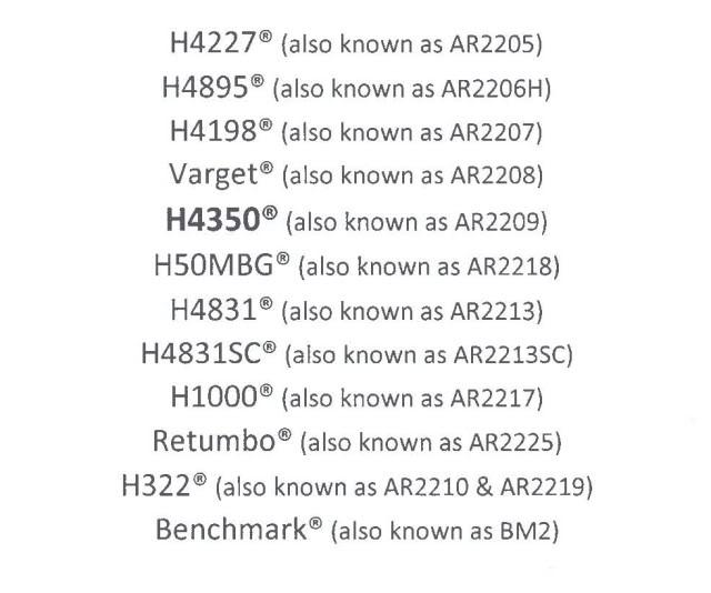

    Whilst the yanks wonder at varget or 2208, we here in Australiaicon have a better powder for most of the more common shot mil calibres. It is 2209. I tried 2208 for quite awhile in different rifles but when I tried 2209 the results where mauch better. 2209 is slightly slower than 2208. i use 46.5 gns of 2209 behind a 174 SMK or Highland and get a variance of no more than 50 fps. they run at 2390-2440. Spot on mk7 ammo. I used it it my swedes when I was shooting them at a different load but equally as close to mil specs.
    Less recoil, that is softer.
    I zero my rifle and then the sight calibrates within i click on the Mk1 singer sight to the range wanted, can't get better than that!!
    I load all my 303 service shoting ammo to that now and have converted 85% of fellow shooters to it and they can't believe the difference and much better accuracy.
    Sorry Ed they don't export it yet!!
    cheers
    NED
    cheers
    NED
    No vegemiteicon this time, you owe me a case of beer
    The powder AR2209 is sold here in the U.S. as Hodgdons H4350
    http://www.hodgdon.com/PDF/MSDS%20Fi...ders/H4350.pdf
    I myself prefer Reloader 15, it is the same powder loaded in our 7.62 NATO M118 Special Long Range sniper ammunition.
