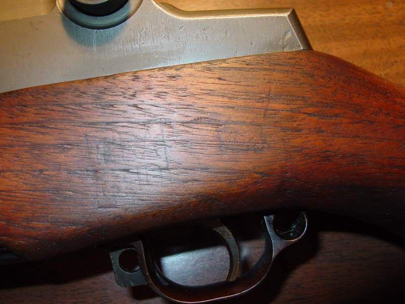

    Have you ever used the Minwax (and others) Antique Furniture 'Restorer' or 'refinisher?"
    I've used it on most of my stocks and it cleans off old marks, stains, etc, but won't take off the original finish.
    It is pretty mild and requires a bit of elbow grease, but the results have been good. I used 000 steel wool and lots of reapplications and towels to do this for and old smoking stand.
    The finished photo is just after using the restorer, with nothing else done.

    I sure like the looks of the finished product Harlan !! Really pretty grain and it shows up well..

    You're correct about the poly finishes for sure. This stuff is mild and won't touch the newer 'plastic' type finishes some people sadly have applied.
    I didn't mean if you'd used it for commercial stuff. There's no way I'd pay a guy to take as long as it takes me to do a stock!
    I was wondering if you'd used it on any of the stocks you refinish, or may try it on one that doesn't have a ton of paint on it. This refinisher works outstanding for me to clean up old blackish build-up etc from stocks, without stripping the wood finish of the original color.
    The best stock I used it on was my old Winchester Garandicon stock. It was almost black and ugly. The Minwax left the stock with a great looking finish with original grain showing, PLUS there is a CC that didn't show up at all before. Not great, but it's there, which was a nice surprise -
    Keep in mind, this stock looked 'black' before - The Minwax left it oiled and clean without being caustic and too strong.
    (Wish I had taken 'before' photo)
