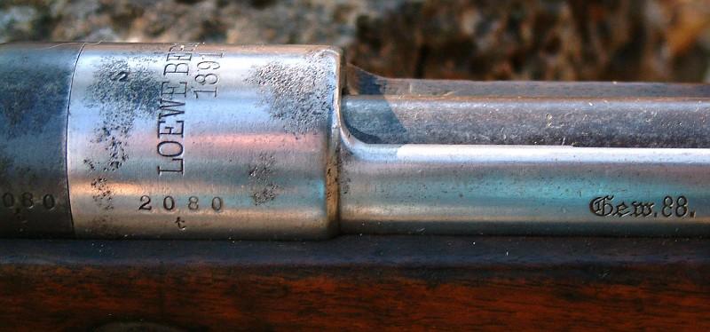

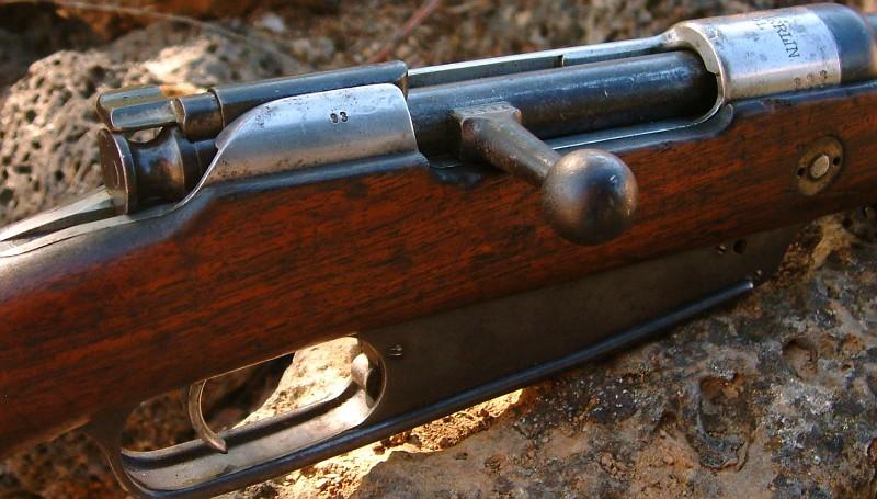

    Ecuador used 7.92x57 ammo, as I have a bunch; what the rifle was, I don't know!
    Nanner nanner I have one
    It was neither manufactured for, nor crested for Ecuador.
    This one came in with the thousands of Commission rifles from Ecuador. It has a brand new Czechicon .318" groove barrel installed. Cost $100 from Southern Ohio Gun Distributors.
