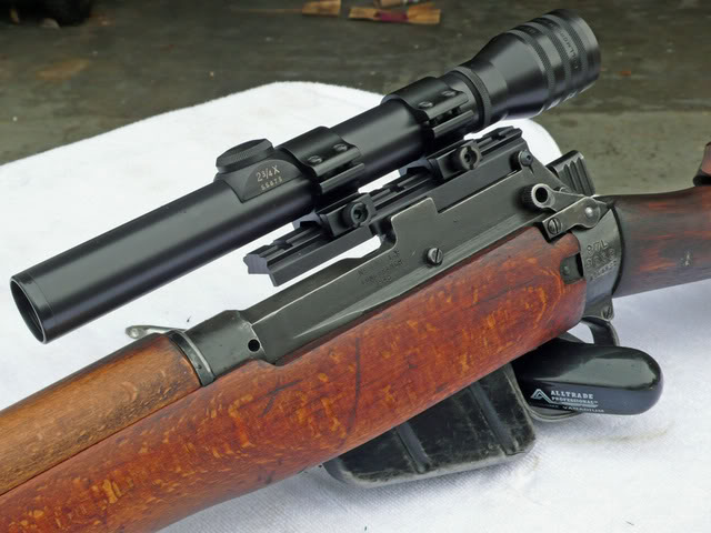

    Weaver K1, K2.5, K3 and Kollmorgen 2 3/4 scopes are my favorite when it comes to affordable scopes for a sniper clone. The Weavers look especially good when they have the brass endcaps.
    Weaver K1
    Kolmorgen 2 3/4
