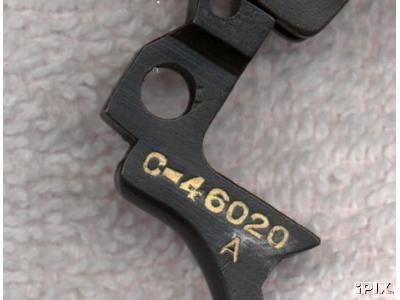

    It has also been shown the Springfield marked some of their parts with a A showing most probably that they dabbled in this early on. Rick Bicon

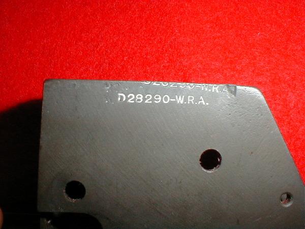

    I have seen this A on numbered and unnumbered. I also have a double stamped WRA housing.
    I forget whose picture this is at this time. I think it was Rick Hamby's. Rick B

    A marked Springfield Op rod catch.
