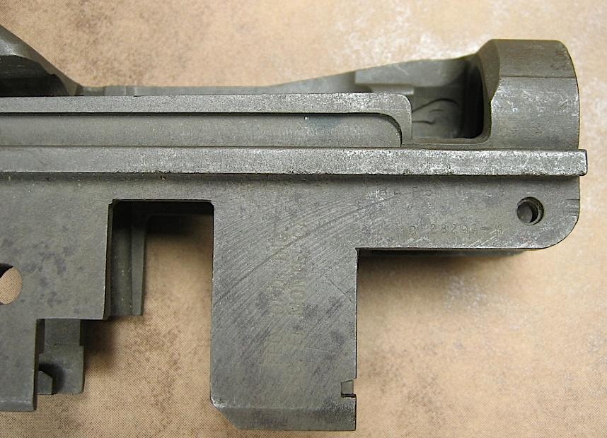

    Thanks RCS, that low number commercial was bought from Martin B Retting in Southern California circa 1978. Maybe I can send Springfield Armoury (T, gotta remember that T) a letter. Its great to know that his is not a reweld, as he remembers buying it as one. So he scores!
    Here is the pic of the WWII dated M1icon. Drawing number (I think thats what it is) D28291 32. Over that number is a loosely stamped O 6 2 E. The serial number is 25XXXXX. Again, no sign of welding, Im just trying to figure out what Fed Ord did. You can see the Fed Ord stamp in the side of the clip guide. Most of the small parts have quite a bit of pitting, but the parkerizing is pretty.

    This a a gas trap receiver imported by Federal Ordnance. They were just complying with the law in marking an imported receiver. This one has the square notch receiver cut, and the seventh round modification.

    Thanks Johnny, Im feeling much better about this. When I saw "El Monte" California I was getting sick to my stomach thinking about National Ordnace as I know of all the horrible problems they had making and rebuilding M1icon Carbines (got burned on one of those when much more ignorant, notice the "more").
    So, they imported back from overseas? Pacific, Europe? Is there any way to tell? By the way, the gastube bayo lug fits an US bayo loosely. Like the tip move 5/8 of an inch loosely. But a k98 Seitengewehr I bought as a "Norwiegian modified for a M1" fits perfectly. Might that give the answer?
    Does anyone know the date of the importations?
    Attachment 26989
    And Johnny, very funny showing me a REAL gas trap rifle!
    Thanks,
    Jesse

    The 2,5xx,xxx number gun seems to be correct. That is, serial number matches the drawing number and revision. The other code is the heat lot. Your gas cylinder lock screw relief valve is usually sloppy with M5 bayonets. Not to worry. The modified 98 bayonet is kind of hard to find. I haven't seen too many.

    Thanks for checking on the drawing number for me Jim.
    I think I need to find a drawing for the gas tube. I dont have any M5 bayonets. I have several M1s; some '42 dated cutdowns and a 10" uncut. All are really loose. I can compare slot dimensions from the k98 and the M1icon. It will have to wait untill I get home though. If the gastube was modified for a k98 slot, would that make it likely a re-import from Norwayicon? Or would Fed Ord have done everything in batches do you think? Sort of like the RC k98s? Or do I have an undersized bayo lug that somehow made its way out of the scrap pile and wound up on my rifle? Now Im thinking back to Nat Ord. Conjecture is fun. Maybe only for me cause its my rifle.
