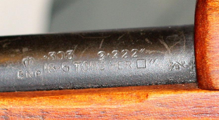

    Jrhead, is there a typical location for that stamp? I'll take a look for it this evening.
    It's usually somewhere near the rest of the proof data. On yours, it looked to me like it might be right behind the "18.5 Tons per Square inch" stamp, but the shadow from the handguard is obscuring it.

    Quote Originally Posted by jrhead75 View Post
    About as clean as they come...nice find! since the commercial proving was done at the B'ham Proofhouse, you should have a date code somewhere. Look for a small stamp that looks like the pic below and see if you can read the letter in the left hand quadrant. That will be the year the proof was done.
    Attachment 36724
    I'd be interested to know what it is in this case...trying to see if it's possible to loosely fit dates with the "ENGLAND" import stamp.
    This is about as good as I can get with the lens I have...
    It looks to me like it's a 'P' which would point to it being done sometime in the early/mid '60s (1963/1964-ish, going by memory). Fits nicely with the few other dates I've managed to get.
