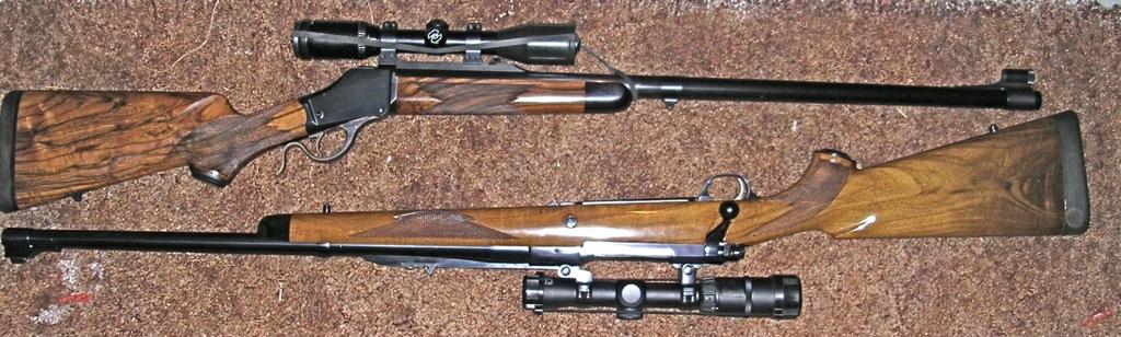

    That's also true. Back in the day when the 25-06 was still a wildcat, we made cases from LC NM 30-06 cases. Necked down to leave a false shoulder, filled case with 50 cent a pound war surplus 4831, carded it off and seated an 87 gr Sierra SP.
    His was a redone P17 w/a 1.25" 28" bbl, mine a commercial FN with a 1.5" 27" bbl. Never lost a case, popped a primer, killed a zillion chucks and eventually set the barrels back 2" and killed a zillion more chucks. (also a lot of feral cats).
    Both sat in Heter's "seconds" stocks that we inletted and glass bedded. Crude and deadly.
    His wore a 14X 1.5" Unertl mine a BalVar 6-24 that I still own.
    Still use the same method with my 22-06 except with expensive Redding collet neck sizing dies. A deadly killer on deer sized game with a barnes TSX @3650 fps. Have yet to recover a bullet.

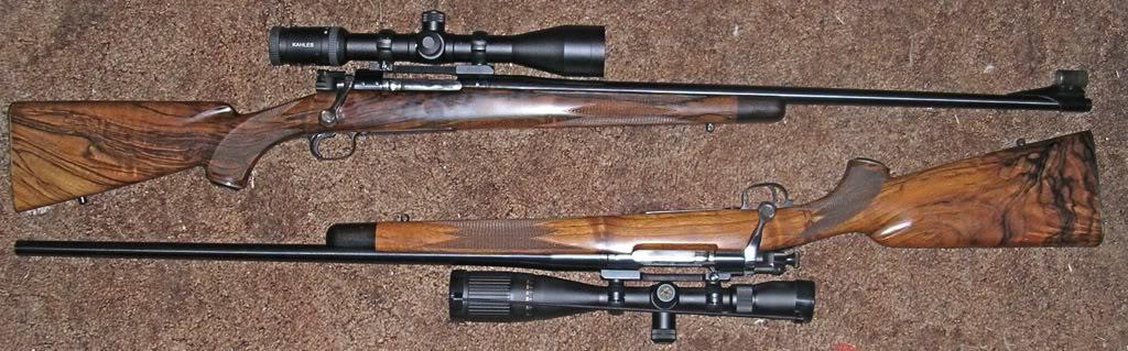

    It's the bottom one, the upper is a 6.5x55. Both built by RF Sedgley in the mid 1930s and refreshed by the late Dick Collins.

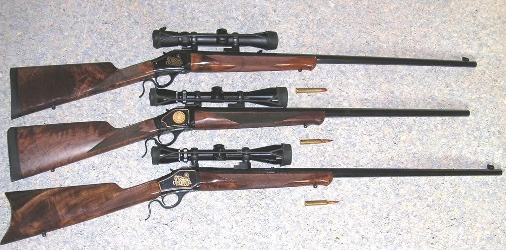

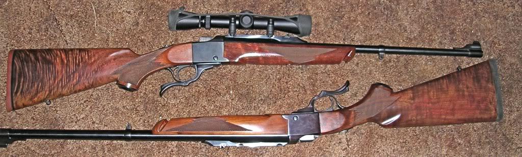

    Will happily admit to buying guns just for the wood.
    The most interesting one is the remington above the 3 single shots.
