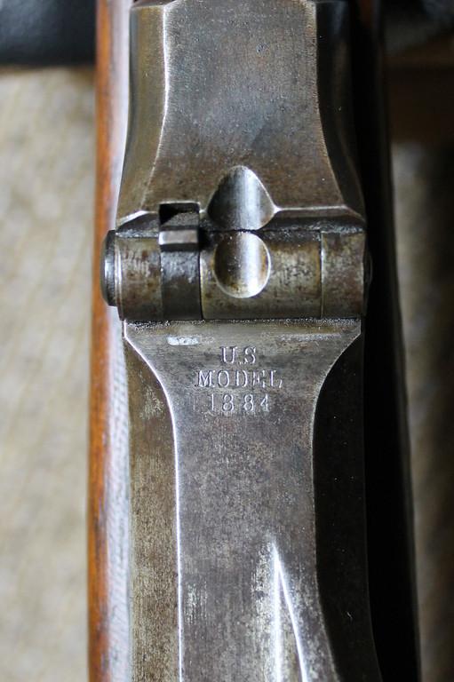

    "The block is actually marke"d 1873"
    You may well be right, but...
    1) The last figure could be a 3" or an 8. Perhaps dttuner can clarify this? I thought it was an 8.
    2) I am aware that there was no such thing as an "official" Model 1878. But, as the authors point out, there were numerous in-between versions.
    On the page I cited the 4th breech block from the left appears to be marked US Model 1878. Maybe it's just my poor eyesight?
    This version/edition/variation, call it what you like if you don't like the word Model - although that is what is stamped on it - has the rounded shoulder of the 1884 version. The versions clearly marked 1873 all have square shoulders.

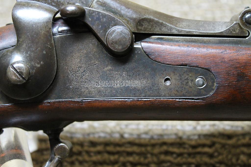

    Just noticed on the Lock plate, there's an "O" to the right of the "C".
    See it?

    Sorry for the "bump", but there are a lot of problems with the answers given so far.
    Late 1873 blocks DO have the rounded shoulders.
    There is no quibbling/iffiness/maybe/"transition", etc. re "1878" blocks. NO such marking exists - it is ALWAYS a too-deep "3".
    The stock is not even for a .45-70! The spoon (rod spring) was discontinued following the last of the .50-70 arms - the Model 1870 - BUT - NO "trapdoor" was ever made without band-springs. So, the stock is even earlier, most likely from a "type 1" M1863 muzzle-loading musket.
    The lockplate is from a musket or a .50-70 - not a .45-70. It probably came with the stock.
    The buttplate is from a Model 1877 carbine.
    Collector value is just about zero - but the fun quotient is unlimited. I hope it shoots well!

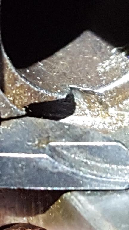

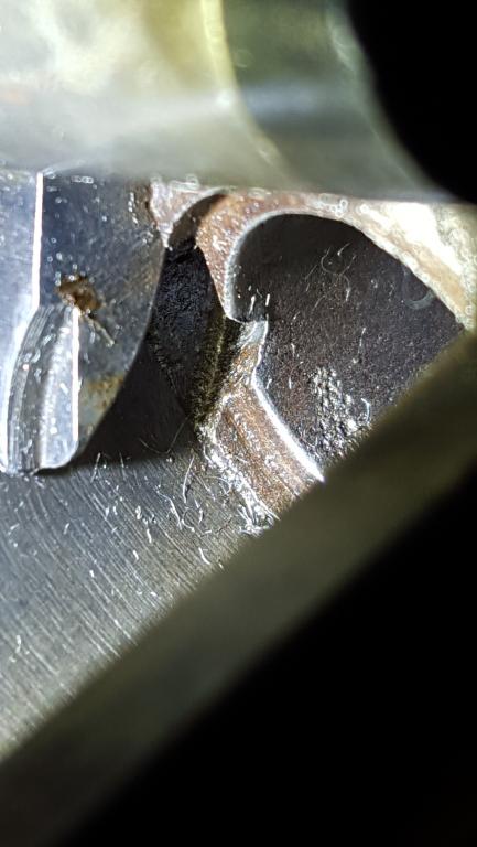

    Quote Originally Posted by dttuner View Post
    Looks crisp and undamaged.
    Pardon me for interfering, but at the picture of the chamber at 9:00 from where what I believe the extractor to be is that a crack at the chamber mouth? This is just an observation, I was just studying the photos to learn how to take better pictures myself, and it looks like that radius has a pie shaped chip. I hope I am wrong.
  7. #16
    dttuner's Avatar
    10-15-2017 @ 06:52 AM
    NJ
    86
    07-04-2025
    07:48 AM
    Quote Originally Posted by Doco overboard View Post
    Good eye. Seems that was just a fiber:

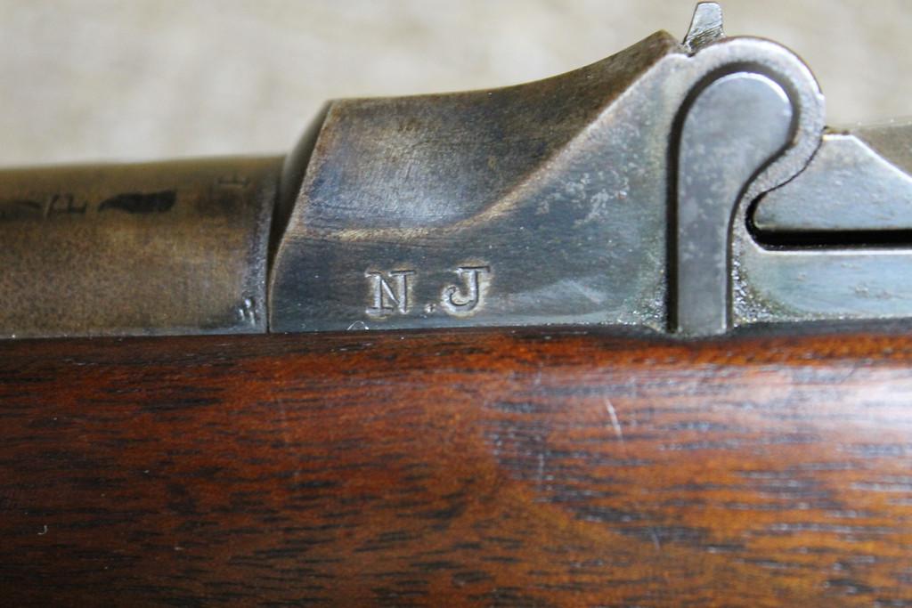

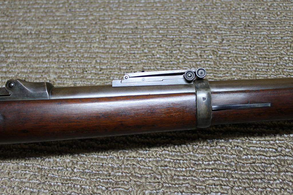

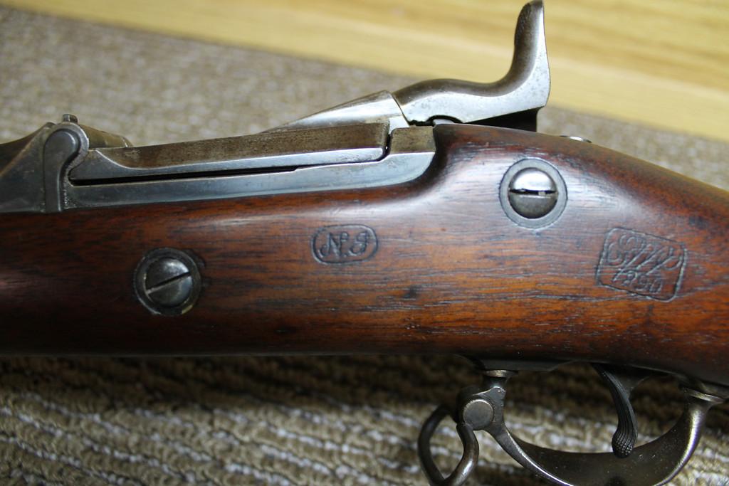

    You have the second NJ marked trapdoor that I have seen, mine being the other. Mine is a 1890 production also and the block is marked 1884.
    The band has been turned right side up since this picture was taken.

    'highpower3006' - Your nice looking New Jersey marked 'trapdoor' seems to have the wrong rear barrel-band on it.
    The "U" on the band is on the correct side for a Springfield arm, but , the open-end should point toward the muzzle. Also, there should be a groove across the top of the band so that the 'Buffington' rear-sight leaf can lie perfectly flat.
    FWIW - I suspect that may be a Remington barrel-band (rolling-block or Remington-Lee) on your Springfield. Remington barrel-bands had the "U" on the left-side.
